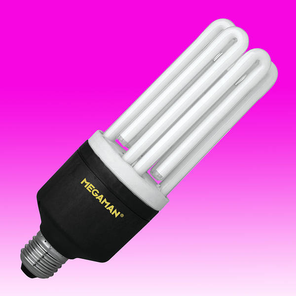

Hello,
I'm a fan of the new energy saver bulbs, but find that they are never quite as bright as they claim, when compared with regular bulb wattage equivalents.
For example I have a large hallway with one 150w conventional bulb. If I swap it for an equivalent energy saver bulb, it doesn't seem anywhere near as bright. Also that appears to be the most powerful energy saver bulb you can buy.
So is it possible to buy an adapter to plug 2 bulbs into one hanging socket, and if so where are these available please?
I could then plug in 2 energy saver bulbs to achieve the required brightness, which would still use a lot less than 150w in total.
I've found such adapters advertised on ebay for the USA, but no such luck in finding similar in the UK.. yet.

I don't think you will, because I'm sure the same question has been asked before, and nobody ever came up with a supplier as far as I can remember. Couldn't you just install a second pendant in your hallway?

You can buy CFL lamps right up to 60w (=300w allegedly) these days so I'd just try a brighter one. might have to try an electrical wholesalers or as far as the high street goes somewhere like ryness.
the ones which are equivalant to 125W don't seem too bad for a hall. (once warm of course).
I think it's the ones which are shaped like a normal bulb are bad ones ???
http://www.tlc-direct.co.uk/Main_In...nd_Tubes_Index/Megaman_Clusterlite/index.html
One 60 watt energy saving lamp, equivalent to 325 watts of incandescent lighting. Problem sorted. :LOL:
