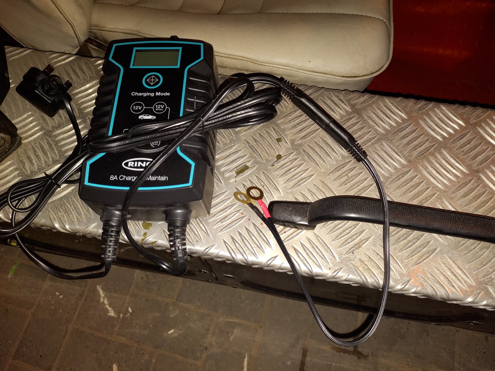

I've just bought one of these charger/maintainers for my summer car while it's in storage over winter, they all come with a compact plug in lead that can be permanently wired quite discretely.

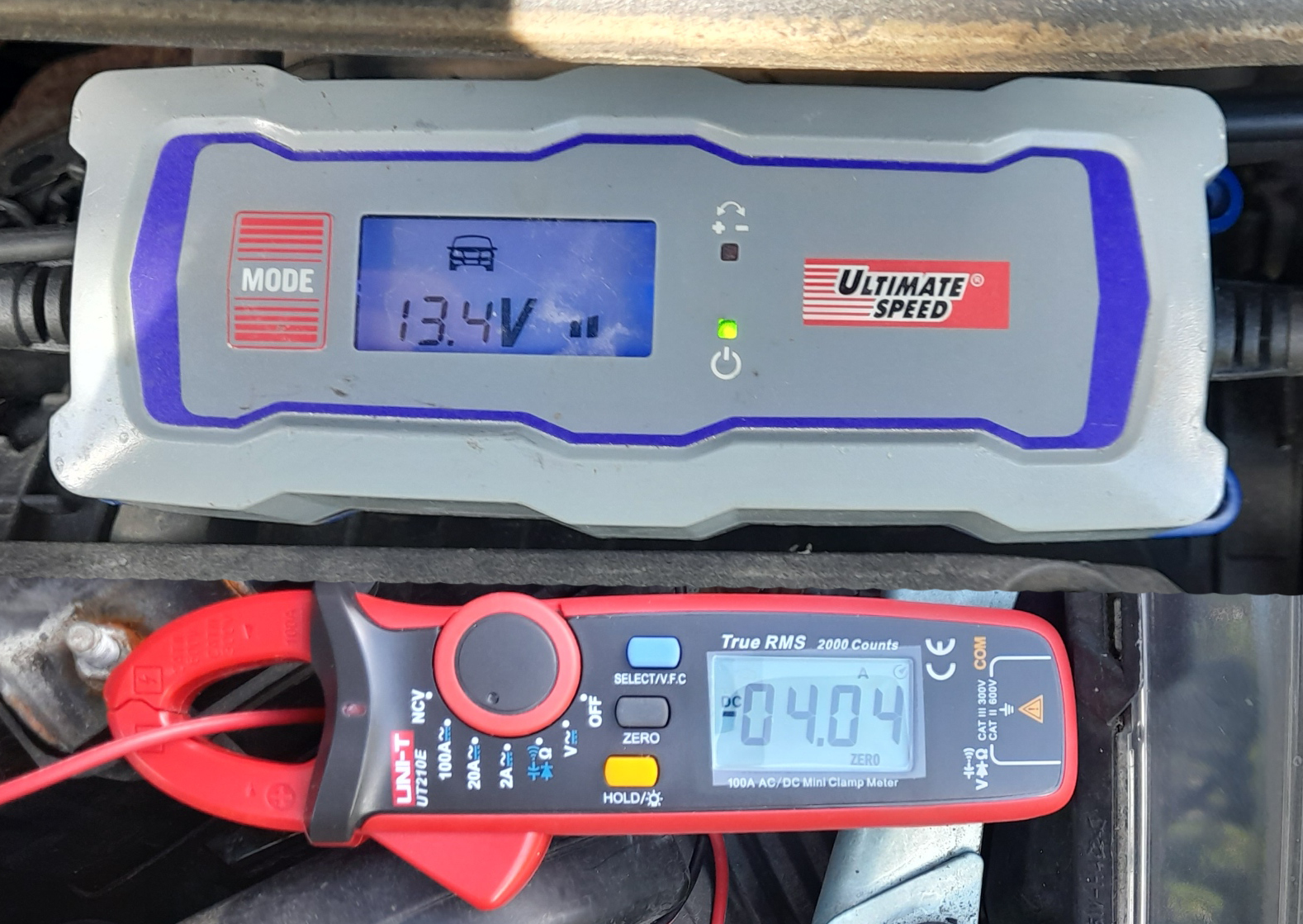

My jump start pack has a cig socket to cig socket lead, and with the wallmart charger it will bring both start pack and car to fully charged, but it is in the main easier to use Smart charger direct onto battery.
It does not do the battery any good to be over charged, so the smart charger alternates between 12.8 volt and 14.4 volt, well at least mine does. So once the battery drops to 12.7 volt it auto turns on until battery at 14.4 volts then turns off or down depending if set to under or over 12 amp/hour.
Max output is 3.8 amp, but in the main charges at 0.8 amp, which is good, as batteries take time to charge, with the Jaguar if battery low then the stop/start system stops working, so easy to work out when it needs a charge, but the other cars hard to tell if they need a charge or not, but in my case it can be 3 weeks between runs, or longer.
