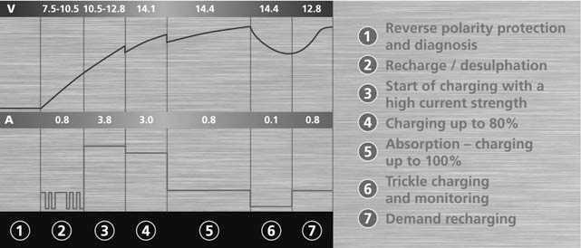

I did not want to charge the battery on the Jaguar ZE as not sure how this may upset the computer, but during Colvid lock down no option, but the mains powered charger is a very low rate of charge and is a constant current rather than constant voltage control. Mine is from Lidi, but ring, Durite, etc, all make these small chargers. On mine there are 5 charge levels, 3.8, 3, 0.8, 0.1 and zero amps, and it uses the voltage to decide when to change between the rates.
So this
is typical for AGM chargers, the problem is it auto detects 6 volt or 12 volt, so a battery under 7.3 volts it assumes is 6 volt, chargers designed for 12 volt only can recharge batteries which are much lower voltage, as a result to recharge an abandoned battery, only way to get charger to work is to put a second battery in parallel, and I have done this.
It was a surprise, I was using a wifi linked energy monitor before the charger, so it was producing a graph of the charge rate, it charged the donor battery and switched off, every so often it would drop below 12.8 volt and there would be a short spike until it hit 14.4 volt then off again, then after around 2 weeks it was as if some one had flicked a switch, it auto went to 0.8 amp charge for around 1.25 times the amp hour rate, and at the end of this the battery seemed fully charged.
I had never considered leaving a lead acid battery on charge for so long, since the first time I have repeated this a few times, mainly small 7 Ah batteries out of things like UPS, however also had a cell go short circuit on one of a pair of 35 Ah mobility scooter batteries which even at just a 5 amp charge rate took out the other battery of the pair, which is I suppose why the Lidi charger once it has reached the 3.8 and 3 amp thresh hold voltages will not return automatic to those rates, it will only alternate between 0.1 and 0.8 amp.

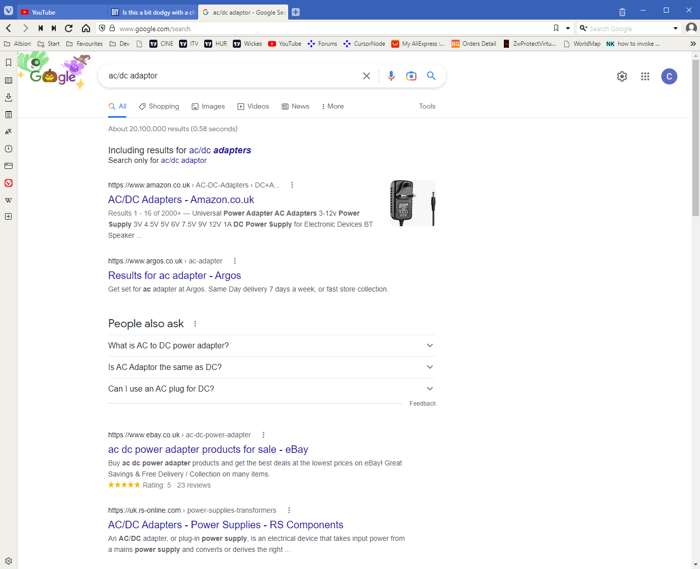

All very well, but the problem with smart chargers is that a button needs to be pressed to start/engage them. A glitch, or power cut, and you may not realise they are no longer functioning.
A dumb ac/dc adaptor will come on when the power comes on. No need to make it so complicated.

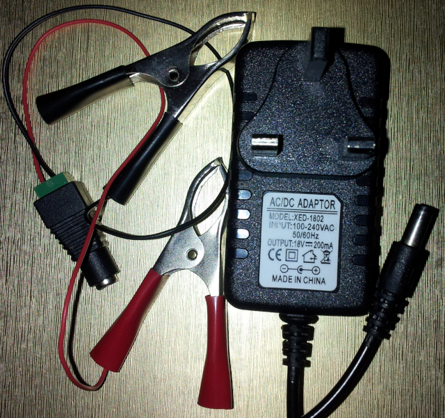

Here's my charger. All parts from china. I don't think it does 200ma, but makes no difference to me.
