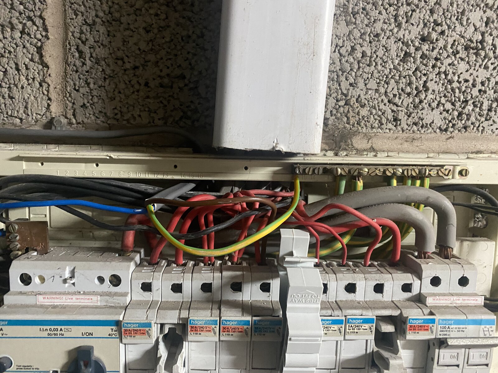

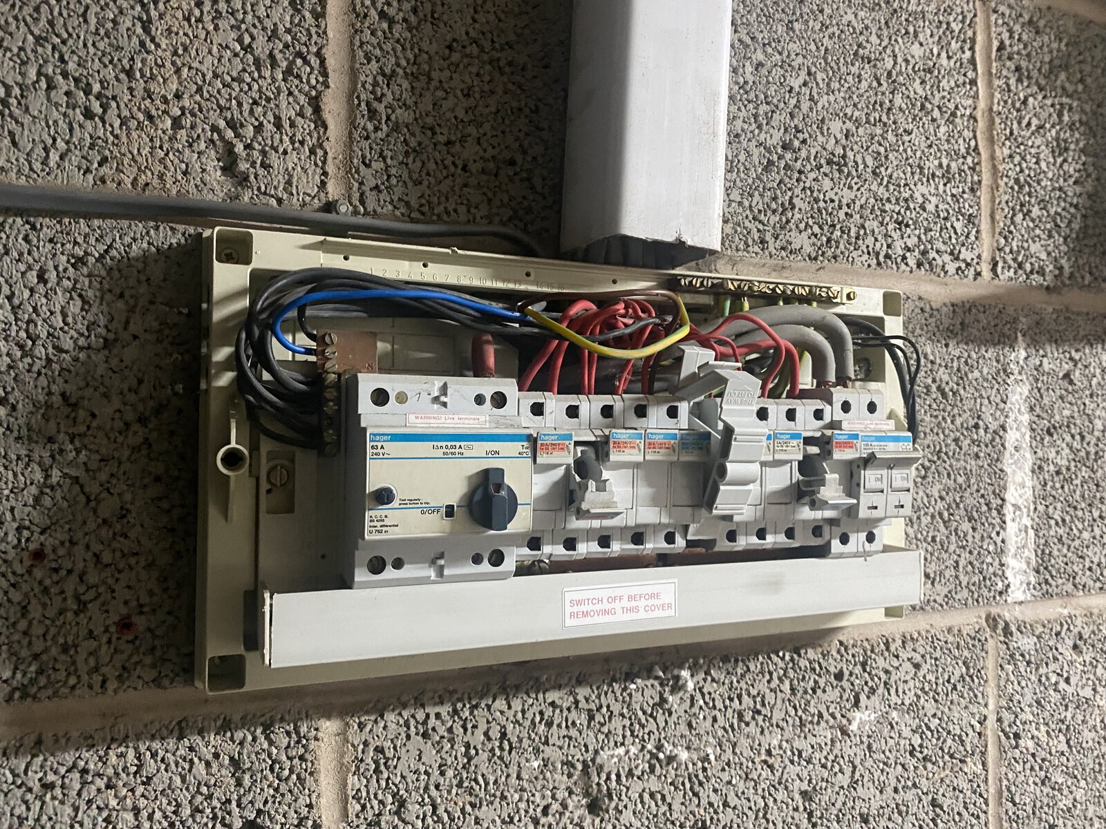

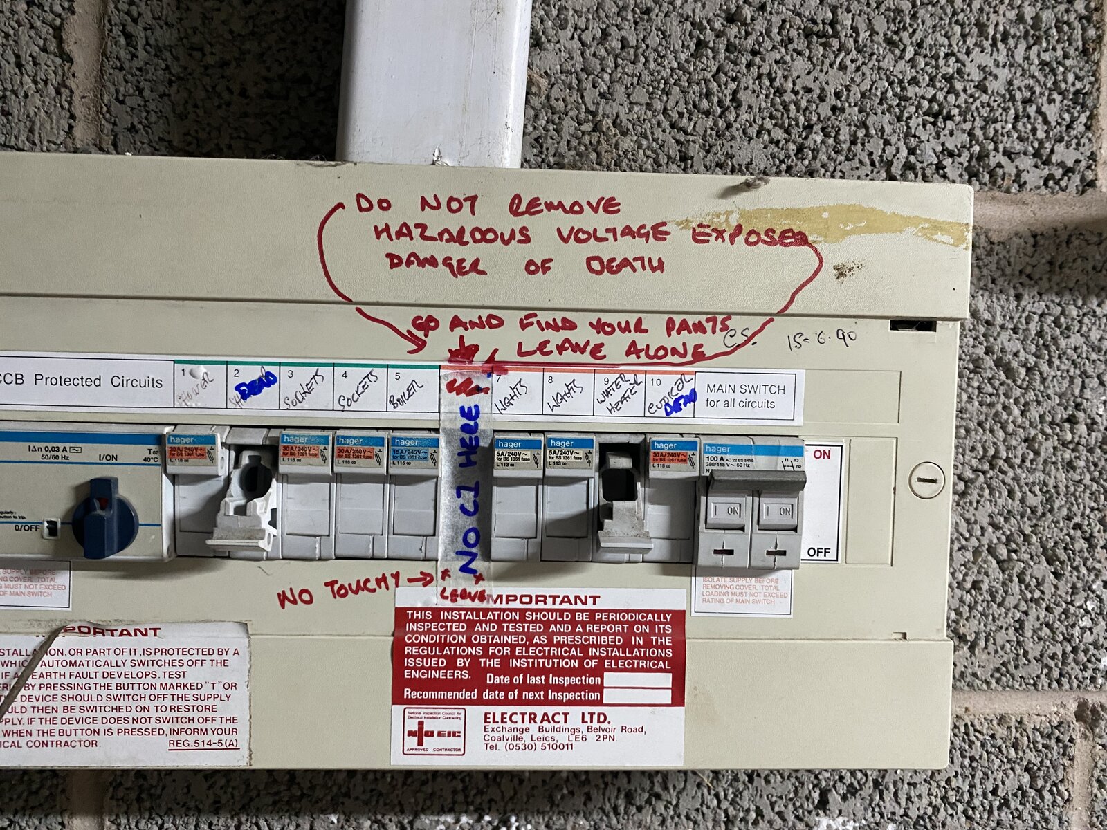

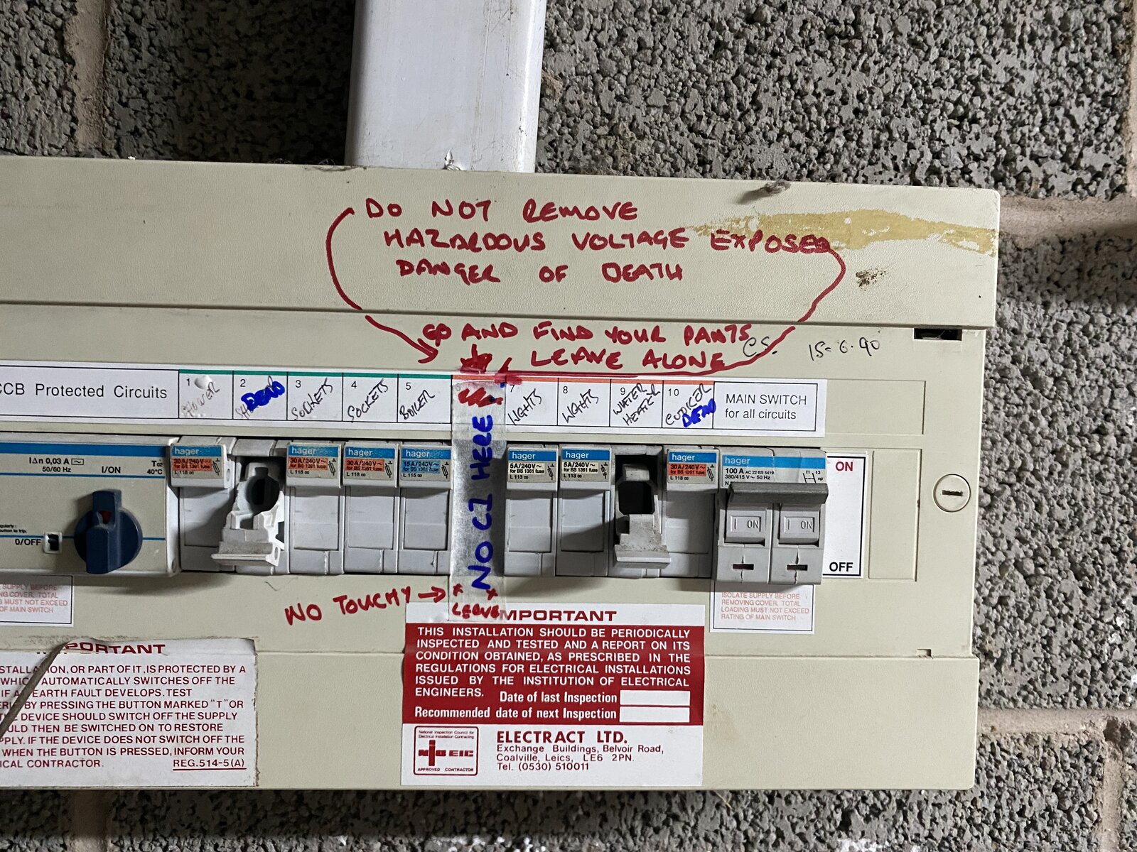

Is this a C1?

This seems unusual to me, in the past electricians I have used have pulled the fuse and got on with it.
Believe it or not, from speaking to them it isn't the DNO or Legality of altering an installation that worries them about pulling the cut out fuse. What they are most concerned about is the comeback on the householder when the 'Smart Meter' reports that the incoming supply has been interrupted and suppliers start the whole 'we have reason to believe you may have tampered with 'our' equipment/bypassed our metering system/etc'
But surely that would be the same if the supply were interrupted using the officially fitted isolation switch. (Octopus fitted one for us when they put a 'smart' meter in but said they were going to do it anyway as standard policy.)
Sorry, I withdraw that. The switch comes after the meter of course!

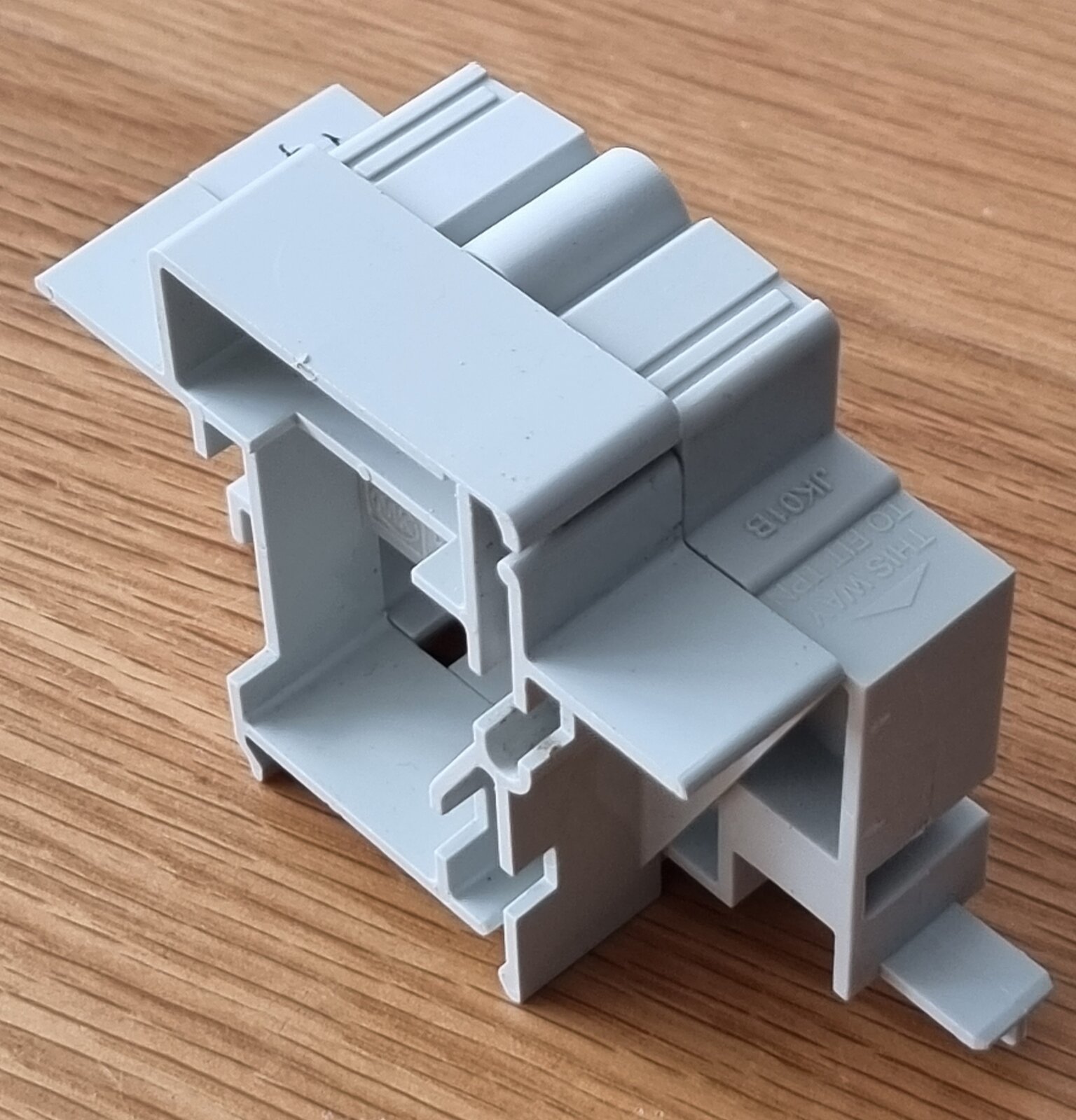

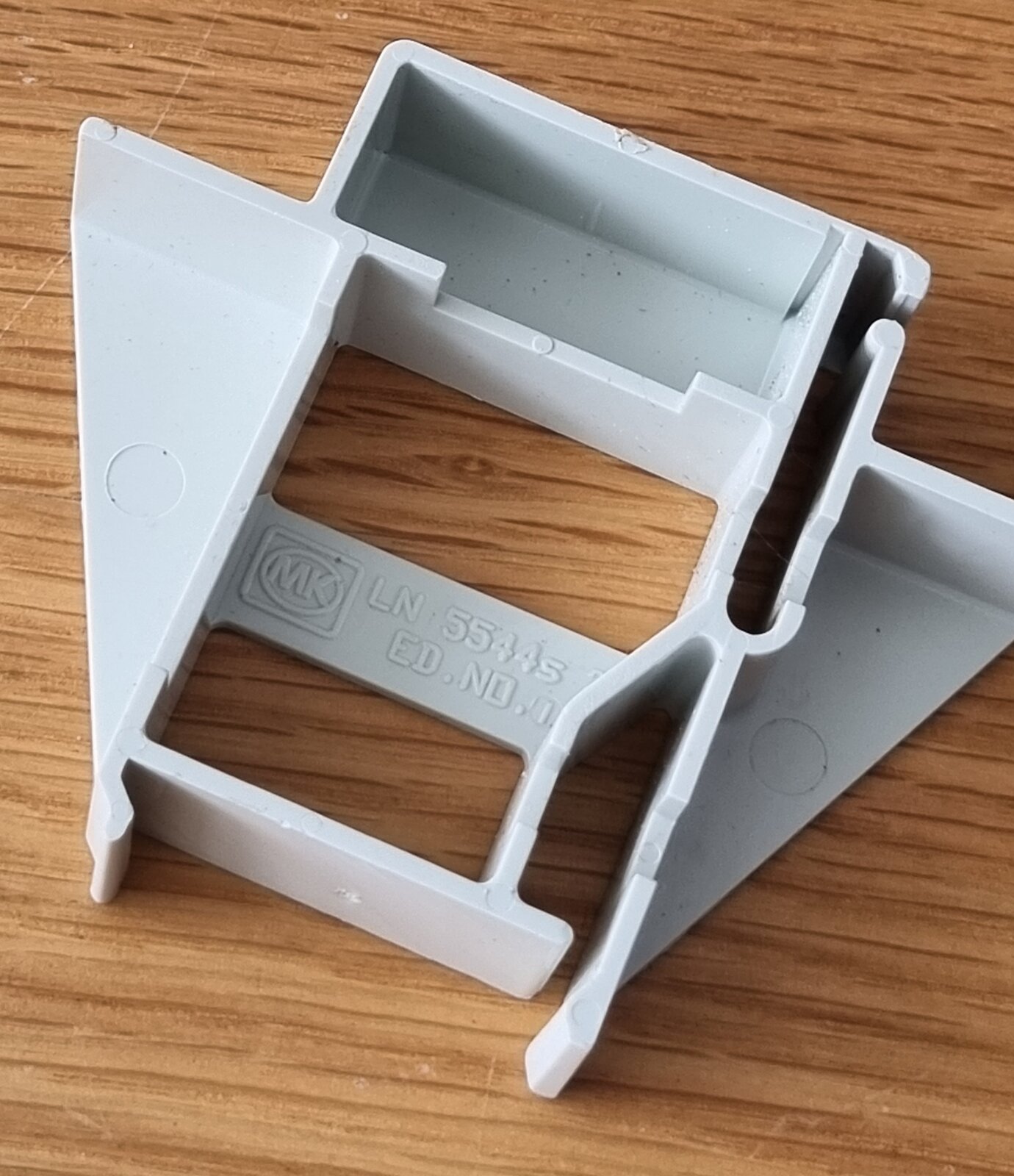

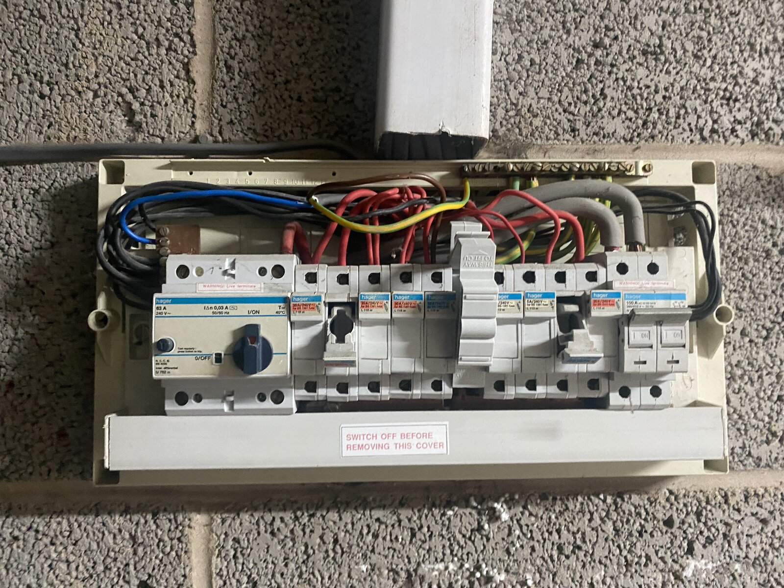

You just need one of these. In fact, any manufacturer will do as the aperature of the fuse carriers/MCBs is the same, as is the DIN rail. MK and Schneiders are prettier I think. It's busbars that change.
And I doubt anyone will complain about type testing.

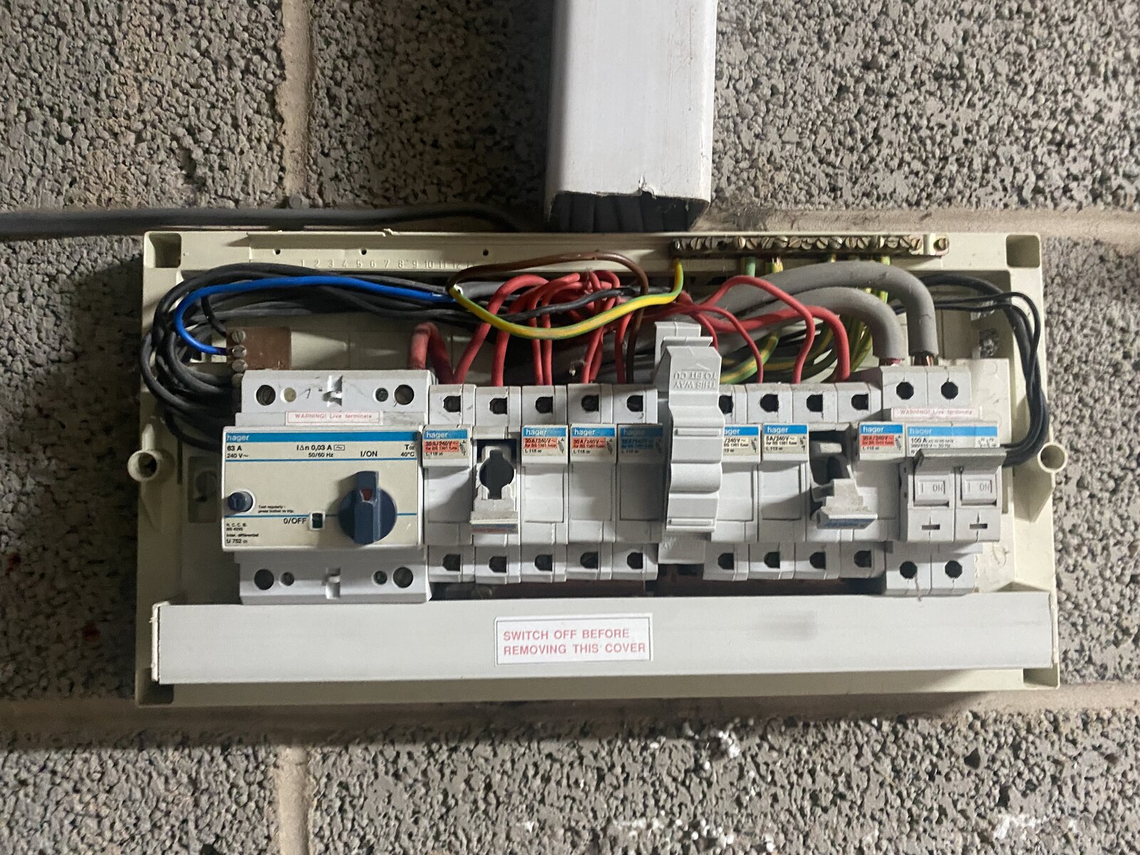

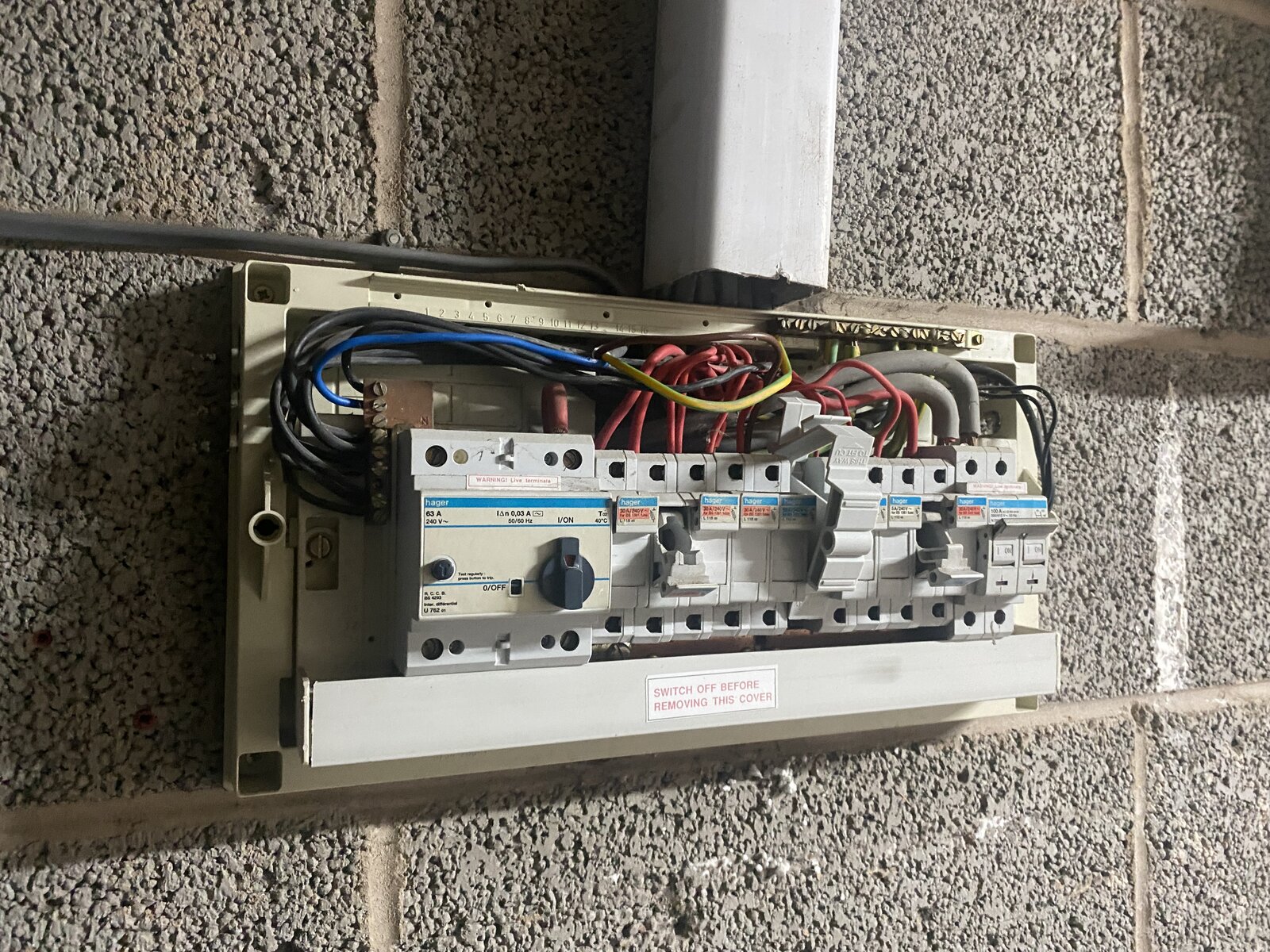

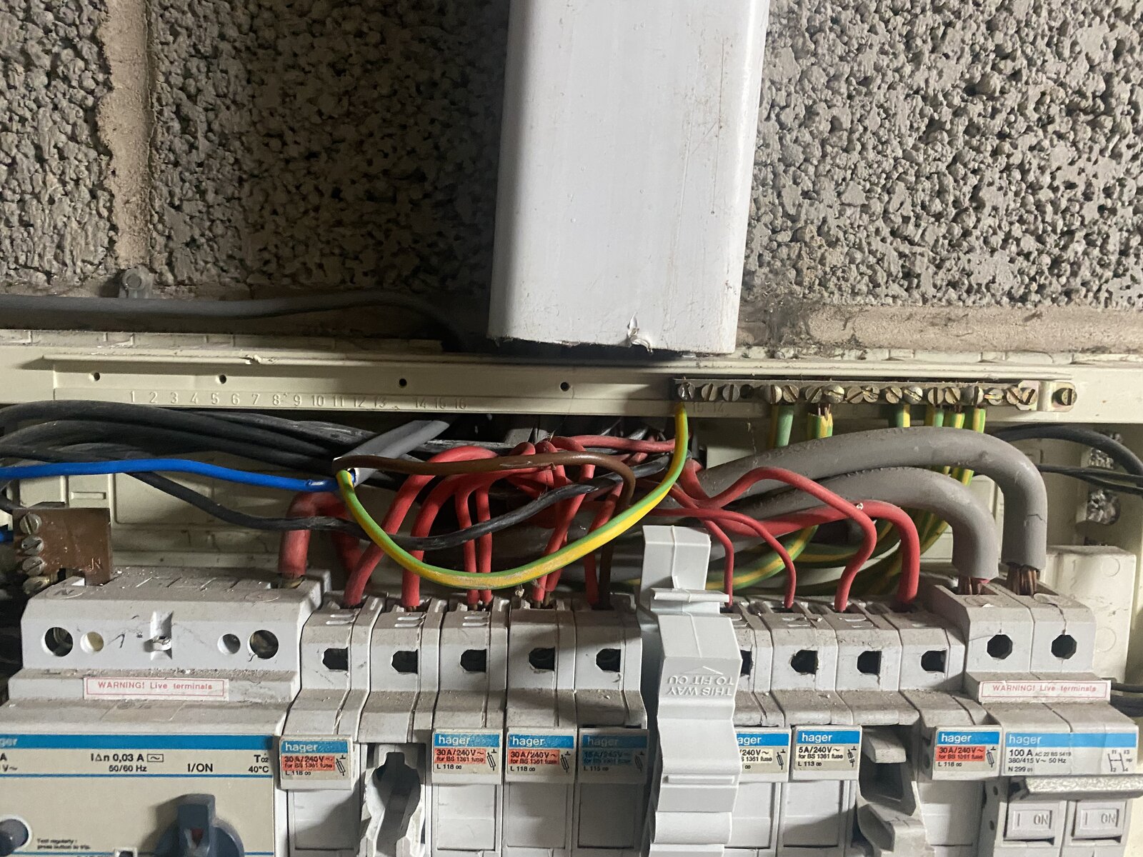

That one’s actually upside down to go in a Hager board. The cutout for the busbar is at the top in the picture. But…..
They don’t fit.
Much much betterer.
I could of course remove the tails to get it to maybe actually fit…… oh wait no I can’t do that cos it means currently removing the cut out fuse.
Ahh... I didn't see that coming. Maybe that's why I keep a stock of these: https://www.toolstation.com/mk-mcb/p11078
Edit: just realised they're on clearance (sigh). OK these then: https://www.screwfix.com/p/british-general-fortress-abs-plastic-consumer-unit-blank/5390p, or whatever looks workable.
As well as being dirt cheap, they're also hollow where the busbar is, could be trimmed down if otherwise, and can be installed just by just squeazing the top/bottom from the front.
Some photos of the MK and Hager side by side:
.... and can be installed just by just squeazing the top/bottom from the front.
I imagine someone is bound to ask, so ... can they be as easily removed "by just squeezing the top/bottom from the front" (which 'they' would probably describe as "without use of a tool" :-) ) ?
