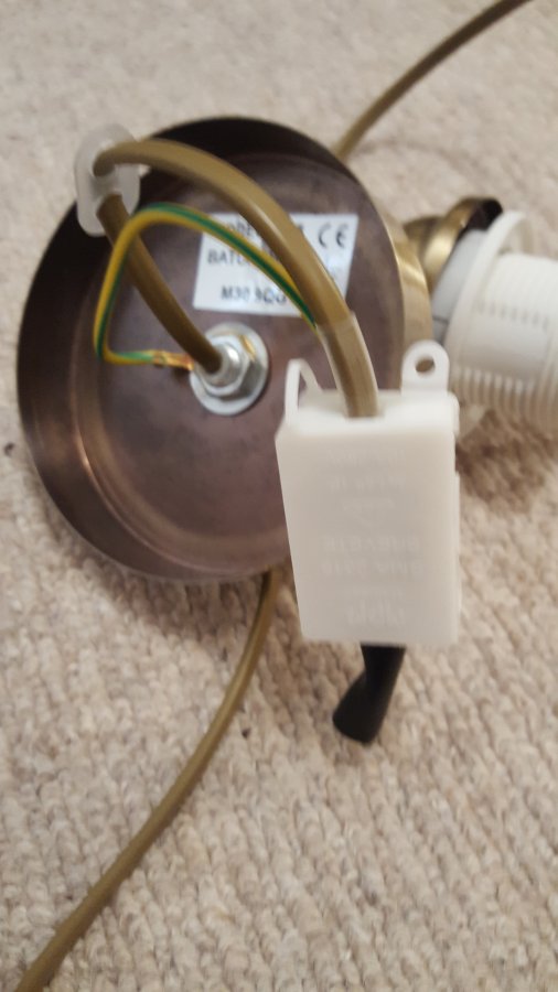

Is this ceiling rose double insulated?
12 Mar 2016
17
I bought this ceiling rose off Amazon (http://www.amazon.co.uk/Modern-Antique-Brass-Ceiling-Lighting/dp/B00CJ9GE9Q):
It's not like others I've seen as it has a black input sheath to a connection box, which also closes over the top. Does this mean it is double insulated?
Alias - if you really look at a metal rose with an earth symbol and a visible G/Y conductor attached to it, and wonder if it is double insulated, please abandon all ideas that you should be doing any electrical work whatsoever - you clearly don't have a clue.
