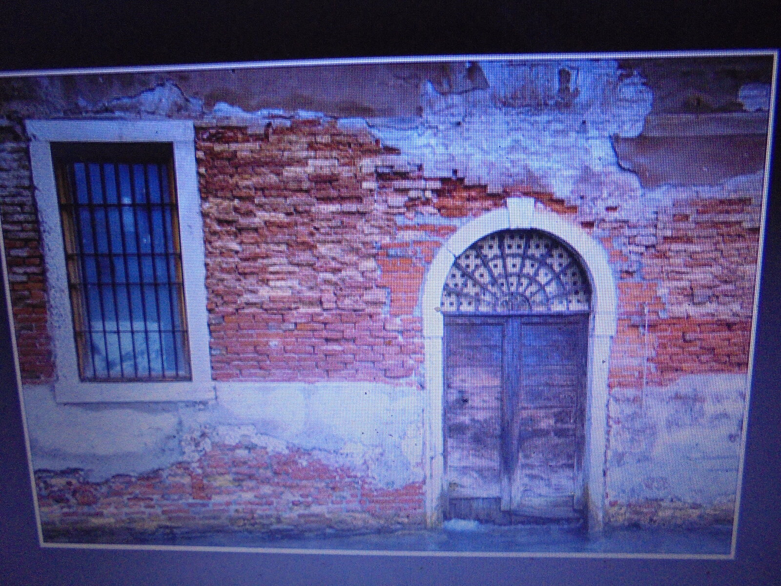

A lot of the Venitian buildings affected are brickwork.
Rising damp in historical buildings: A Venetian perspective - ScienceDirect
I have been to Venice and noticed a lot of brickwork.
I think we can probably all agree that Venice is pretty much a 'worst case' scenario! ;)
It obviously is, and it's said that the height it will rise is greater the thicker the wall is. It the UK most houses don't have 6ft thick walls, although some of the stone farmhouses in my area are 3ft.

Unsurprisingly, walls standing in seawater for 500 years have a salt content different from most British houses.
