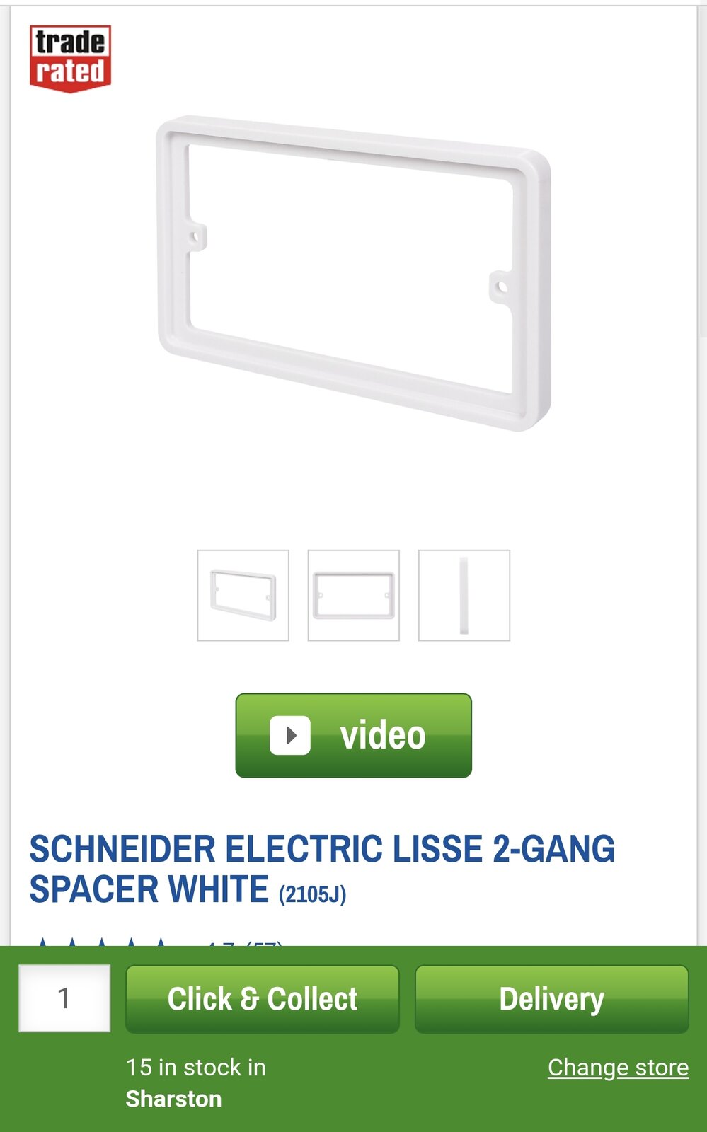

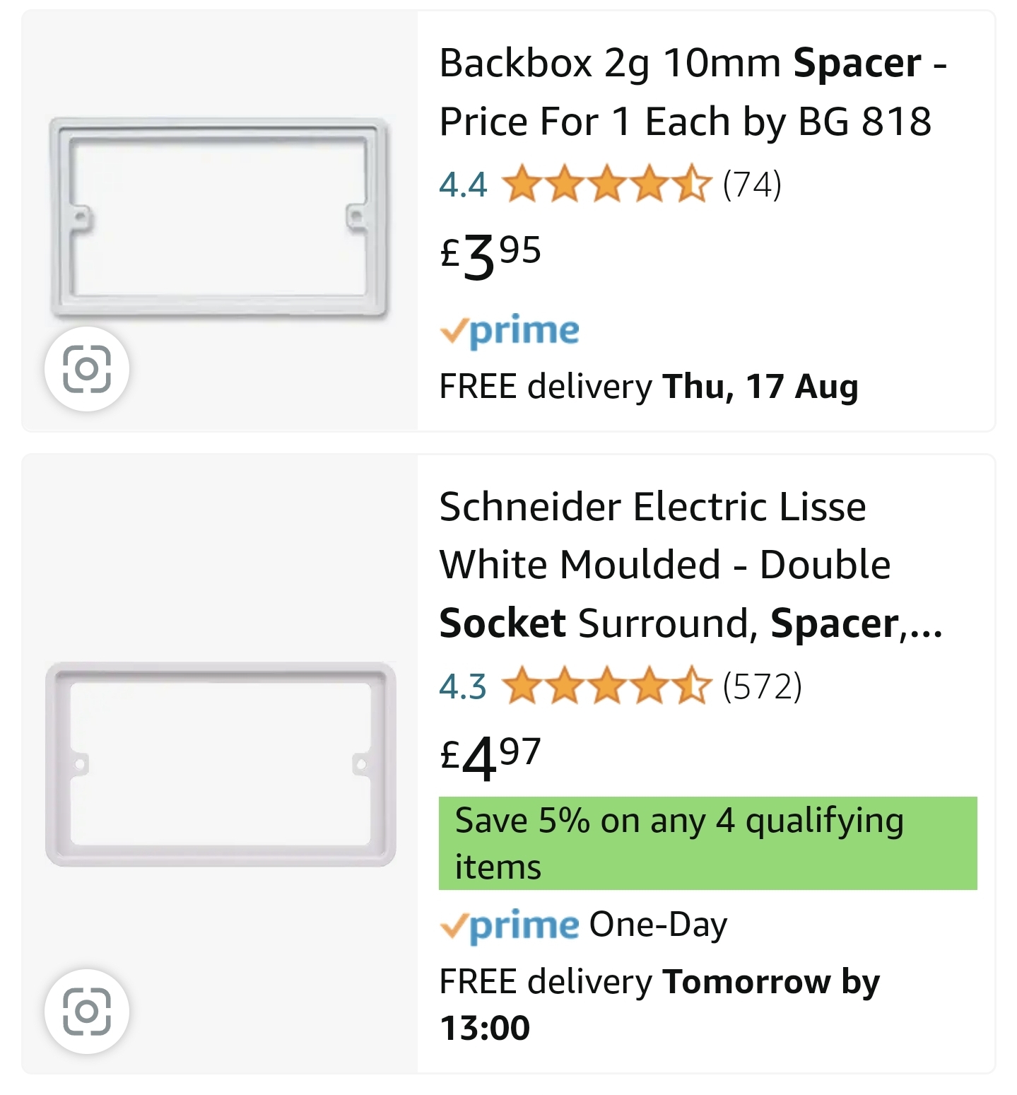

Decided to go for some USB wall sockets which have USB-C and hence the actual depth of the socket itself is alot deeper than than usual and hence will not actually fit into the backbox.
I'm not sure exactly what it is that I need but I think it could be something like this that I found online which is a "socket spacer"
Think I found them alot cheaper at screwfix but just wanted to check to see if I'm buying the right thing in order to get these sockets to fit.
Any advice is appreciated, thank you
Yes, it's the correct item.
They are available with round or square corners to match the socket on the front.
Either will fit, but the matching corner profile will look better.
The other option is to replace the metal backbox with a 35mm depth, but that will involve damage to the wall and some repair and repainting.
