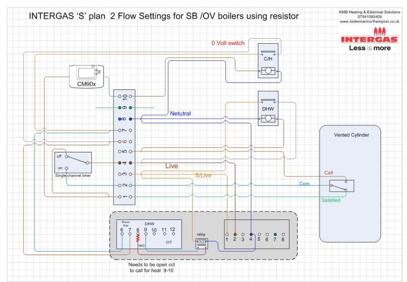

In all honesty, I'd be interested in seeing your wiring diagram. I do wire lots of complicated systems for a local plumber. All we do is have a discussion on site of what bits he has and how he wants them to all work together. I knock up a quick sketch of how it'll be wired. When he's happy I pull in the wires, do all the connections and test everything electrically.
Break it down into a simple flow chart and it's nothing to be scared of.
I did this one recently. Not sure what letter plan you lads would call that?
Boiler heats a big cylinder. This can also be heated by a solid fuel stove when its on.
The cylinder feeds the central heating upstairs, a 10 zone under floor heating system, and eventually another UFH system in a granny flat once that is built.
A fundamental difference is most of my /our stuff is retrofit. U have a 20+ year old system & u r plonking a hi tech boiler onto it. My policy is to get as much out of it as possible rather than just bang it on the wall.
Some (lots) of the new boilers are looking at new installs adding NTC into cyls that are designed for that. Here we have to use a on off tank stat. To get the 2 temps u can use the WC pins to add a high resistance to kid the boiler its cold outside so it will max out the flow temp whilst the resistor is in place. If u can sort it that the resistor is added when hot water is called - well u have hot water priority and when the hot water is satisfied the heating continues back to whatever type of roomstat is controlling it be it an on off stat with the set temp set by the owner or O/Therm.
Electrically its easier to do this on a Y plan by converting a Y plan 3 port mid position to a 3 port diverter valve by joining White & grey & not using the orange. As long as the boiler has a separate signal for DHW and WC it will work this way. (Some MU like WB dont just add a ntc to the outside wall - that have to add a WC module including the electronics that make it work (con job) so this only works on WC that just needs an external sensor.)
The relay (simple 240V from Maplins) sits inside the boiler bat can go anyplace

Is this solution endorsed by Intergas as I’m not sure they would appreciate their logo being utilised otherwise? I suspect I already know the answer to this. :LOL:
Rather than faff about with relays and resitors bridging the external sensor connections, I would chose a boiler that did the job I wanted, probably an Avanta in this case and wire in a diverter. No point in keeping two old valves for the sake of it.
Regards
Although your plan will work of course my question would by why not use the new tank sensor anyway? The boiler give priority to domestic hot water and a cistern takes a long time to heat up. By interfering with the system you could end up with no heating for an extended period.
