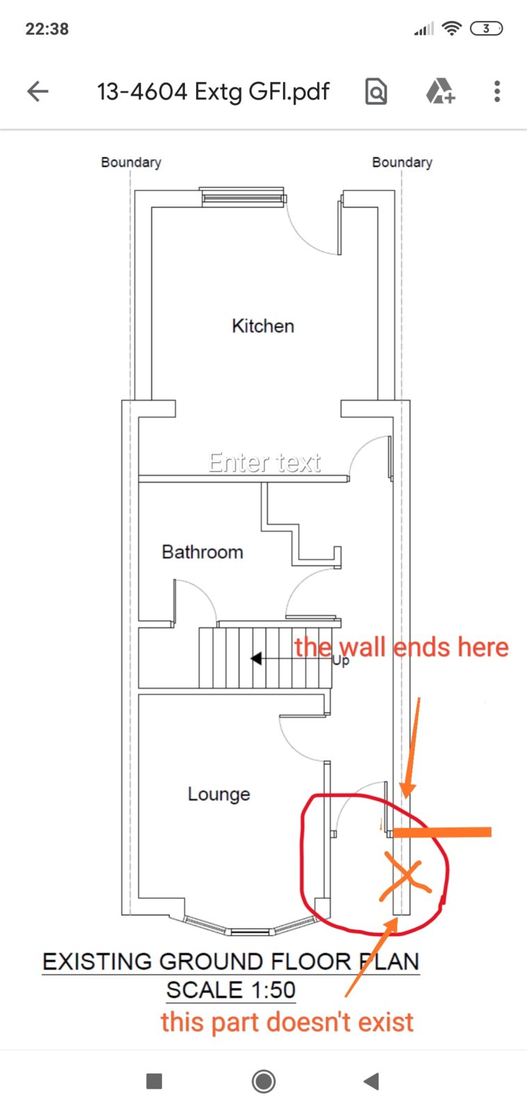

Not that easy because we have a porch, see the attached, so the steel beam wouldn't have enough support. I've just noticed that the drawing has another error (!). The architect split the porch we share with the neighbor with a wall. This wall doesn't exist, and obviously the wall is half brick, not a single as indicated by the drawing.

On what grounds does the SE say it's not possible to support the beam off the half-brick party wall?

@op; had you posted the plan earlier, it would have made more sense!
The steel beam is at the front of the house, right? If so, it will only be supporting part of the loft floor. In that case, a 300mm long padstone would have been OK unless the wall is made of mud bricks; 600 is overkill. Similarly, with a small additional floor load, the foundation of the wall will almost certainly not be an issue. Bear in mind also that the normal floor load allowance (30 lbs/sq foot) will be lower at the front of the loft because the headroom is so restricted.
What might be of more concern to the SE is the relative slenderness of the wall ie its 'thinness' top-to-bottom, but this is not an issue which
is solved just by putting in a bigger padstone; put simply, the more slender a wall is, the less load it can support for a given height. But in this case, the additional load on the wall is absolutely minimal and I suspect the BCO/council checking engineer are being overly conservative, and your architect and SE are probably over-reacting to get the scheme approved on paper.
