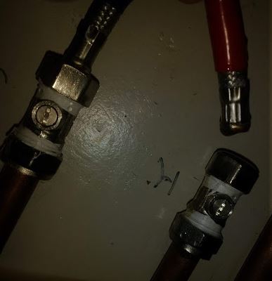

The kitchen tap came with flexible connectors with threaded connection, which I fitted to "flat face" isolator valves. All good for 2 years.
Fortunately, after being away for easter, and being out this evening, when we were in the kitchen we heard water pouring out... Fortunately, the main stop-cock was left accessible.
Turned out the flexible tap connector dismantled itself and "popped out" the but that goes onto the isolator valve! Fortunately we stopped it before the flood hit the floor - and it just filled the recess (to the brim) of the missing tiles. How lucky!!!
The pressure is fine (quite low) - so just looks like a defect.
Will be replacing the other! They came with the tap...…
How common is this, as its the first "fault" we've had like this, and does worry - had it happened on Friday we'd have been totally flooded - and with hot water! Would've f*ked up the entire house! (unlimited hot water (combi)/steam etc).
May now turn off water at meter more frequently!
Now to find branded replacements.....

Whilst not saying it is the reason the connection failed, no PTFE tape is required at those connections. Reason for failure could and I stress could, be because the pipe was under too much stress.
Unwind the couple of rolls of PTFE tape you have on the valves and take it back to the shop for a refund, you don't need it there.
Fortunately, not the cause. The connection that pulled out had rusted (!). Out of site, so not seen.

That "valve" is 15mm olive compression onto copper at the bottom, and "flat" on the top where the tap connector is, that had a washer.

The flexible tap connectors have a rubber washer in the end, no PFTE, paste or anything else required. That's also why you need the correct thing to fix them to which has flat ends. Using a connector designed for an olive will slice into the rubber and cause a leak.
Compression joints never need anything on the threads, as the threads do not form the seal. They are only there to hold the other components together.
Jointing compound or PFTE over the olive might be useful in some situations.

The connector (isolator valve) was correct, it had flat ends specifically for the tap connectors.
All the tap connectors I can find now end in compression joints (eg https://www.screwfix.com/p/flexible...1htrXLRnpS718xJ36EIaArYfEALw_wcB&gclsrc=aw.ds ) rather than flat? Or am I searching for the wrong thing. Also think the tails are currently 450mm
So tomorrow I was planning on replacing with the linked tap connectors, and replacing the isolator valve with a standard 15mm x 15mm compression, and 150mm of copper pipe to reach the shorter tails. (Without PTFE :) )

Use a 1/2 MI coupling instead ie. 1/2 male thread to 15mm compression and join it onto a standard isolating valve.

Must say I've never seen any ISO valves with a compression fitting on both ends come with a flat face and I've seen a few ;) All ISO valves that have compression fittings both ends will have sharp fluted ends for the olive to sit in.
You can easily file one end flat though, they are brass so are nice and soft and file quickly and easily and then they can be used to connect a tap connector directly to it without cutting into the rubber washer. Then it's just finger tight and a 1/4 turn. Do it all the time, saves on extra fittings.
