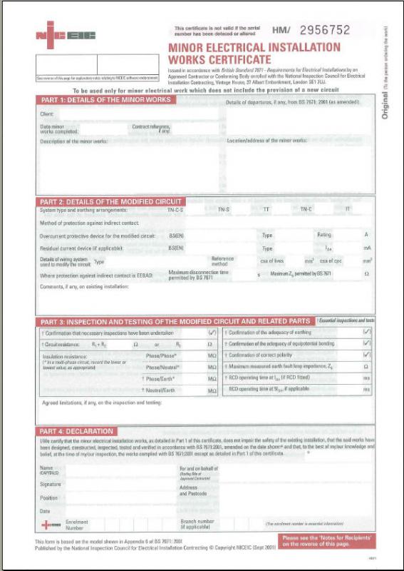

I wouldn't bother issuing a MWC for it.
Fair enough - but if you're going to go to the trouble of undertaking "test(s)", I would personally feel that you might as well document the results in some formal fashion - if not only in case someone subsequently questioned whether you had undertaken the tests(s) and got satisfactory result(s).
Kind Regards, John
Perhaps then, John, a person who had cause to do a lot of simple replacement of accessory jobs and wanting to issue some documentation to the client, who found a MWC over the top (and burdensome for the number of times he did it). Might come up with his own form where he states a description of the work done and the address, a place to record the loop result, tick boxes for polarity and correct over current protection confirmed and a place to sign and date it...
For a one off you might as well just do a MWC though
Sure - all I said was that I thought it would be sensible to formally document the work and test results. As far as I am concerned, that could be on one's own form - but what you describe sounds remarkably like a MWC, so I'm not convinced that much would be gained by going to the trouble of essentially re-inventing that wheel!
