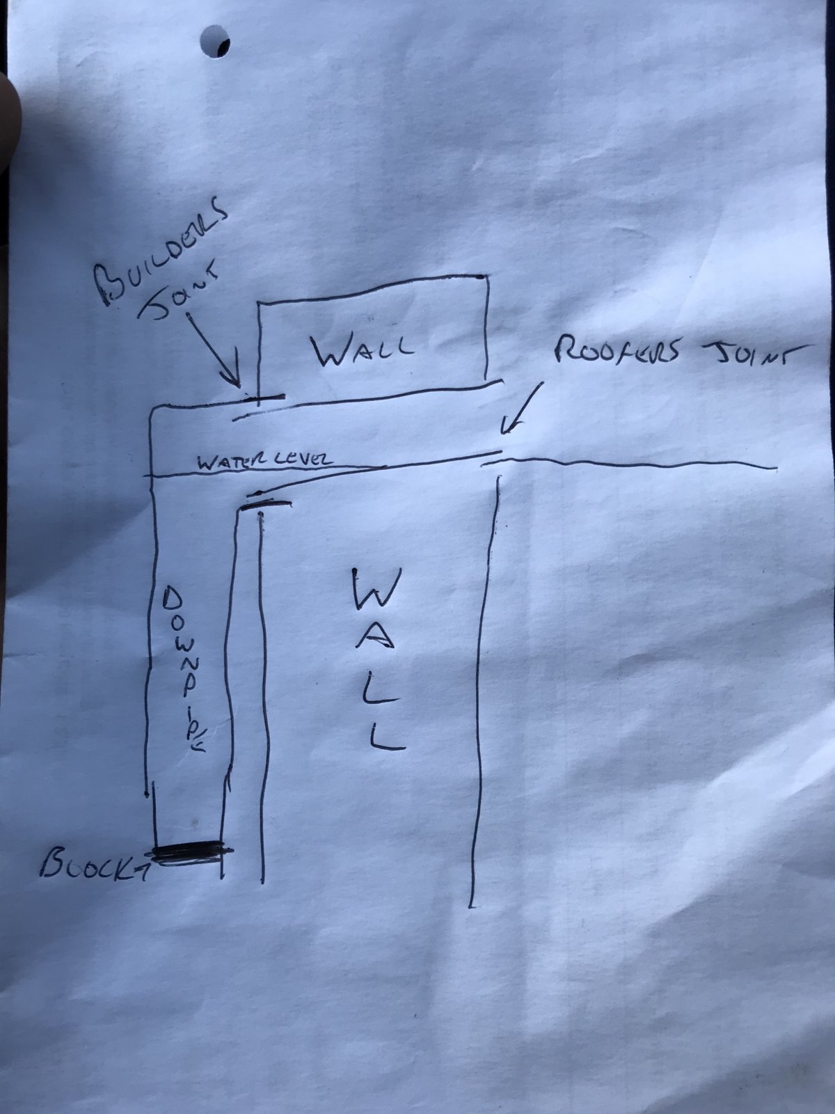

We built an extension on ground floor of a Victorian house. The extension is L shaped with a thin part connecting it to the existing structure. The roof is a green sedum roof, with a waterproofing membrane collecting all the rain water and channeling it to a pipe that goes through the ceiling and out in the area just by the connection between main house and extension. There were two professionals involved, a main builder who did everything except the roof and another one who did all the roof, and pipe. The roof guy left the pipe extending about 25cm from the house and when the builder finished the wall and render, he cut it close to the wall and created an angle connection to a vertical pipe taking the water down to the sewer.
Within a year after the construction we noticed damp patches on the wall very close to (just under) the pipe mentioned above. The builder came to see it and said that water was escaping from the corner connection so he glued it to create a seal. Soon after though the damp came back. We asked the roof guy, who said that the pipe should not have been cut short because water can travel back from the end of the pipe back into the wall, the safe distance being 5cm from the wall at a minimum, pointing the blame to the builder who should know better. The builder on the other hand said that he cut it 2cm outside the wall (although my wife remembers it being cut flush, not 2cm) and especially with the additional seal from the glue there shouldn't be any water coming in, and suggested that most likely there's a leak further upstream perhaps where the membrane leads to the pipe. The roof guy said that's impossible because there's a huge area of a complete seal of the membrane on both surfaces of the pipe. He quoted about £800 to remove the pipe and install a new one whose outlet sticks out the recommended amount from the wall(and of course recreating the seal with the membrane). In the absence of an agreement between the two on what's the fault and what needs done, and it seems they don't get along very well which makes communication difficult, and given that we can't have a continued leak, we feel trapped into paying that.
What I am not convinced of though is that even if best practice is indeed having the pipe extending by a lot from the wall, there must be a way to waterproof the wall if it stands out even a tiny bit. Either by having a fully sealed extension of the pipe, or sealing all the surrounding area, or something else. Surely it can't be that the solution is replacing the entire pipe?
I am trying to get both of them on site and discuss it and agree on something but I would like to gather some views and ideas on it beforehand.
Pictures are here: https://imgur.com/a/OTZs2xV

First i’d test it with a hose inside the pipe, past where it meets the membrane and before the point he cut the pipe. Simulate some heavy rain there, making sure non flows back to the membrane joint, and see if it shows inside.
Then you know which joint is leaking.
Thanks but the problem is that there's no immediate feedback because the water travels slowly inside the wall and eventually shows on the inside much later. The leak is likely small because even during heavy rain there's no noticeable immediate change in the wall.

Could you block the downpipe and fill it sonit backs up past that joint?
I could block the very bottom of the vertical pipe, then the water would build up in the pipe (and then go back out the roof end but also presumably leak into the wall as well). The problem is that it takes time to see the effect (damp inside), so there won't be any useful conclusions, certainly not being able to identify where the leak is.
Turn the hose off once the water passes the builders joint and top it up if it subsides. It will come through eventually.
Maybe I don't fully understand what you propose. The water will come through, yes, the same way as it comes now presumably, but how will we be able to tell what's at fault. Filling the pipe with a hose is similar to water coming down during/after heavy rainfall (there's about 45sqm of roof surface water all coming down through that 10x10cm pipe). We don't see the wall immediately wet, but possibly not until the next day. And there's no way to tell where it's coming from. Wherever it is, it certainly travels along/through a lot of wall structure and the path is not clear at all.

You have a parapet with coping stones -cant tell if thats a cavity or single skin parapet. The parapet abuts the existing wall. There is a door or fixed light with a lintel and I guess a cavity closure or vertical dpc. There is also a rain cover with brackets over the door. All unlikely perhaps, but its part of the diagnosis.
The damp internally is on the reveal and the wall face just an inch or so from the corner of the reveal. So the water must be getting in at high level (as it starts high up) and getting across to the inner blockwork leaf.
If the thought is that the water is coming out of the elbow externally and running back outside, ie where the staining is showing, then sealing between that and the render would stop it.
