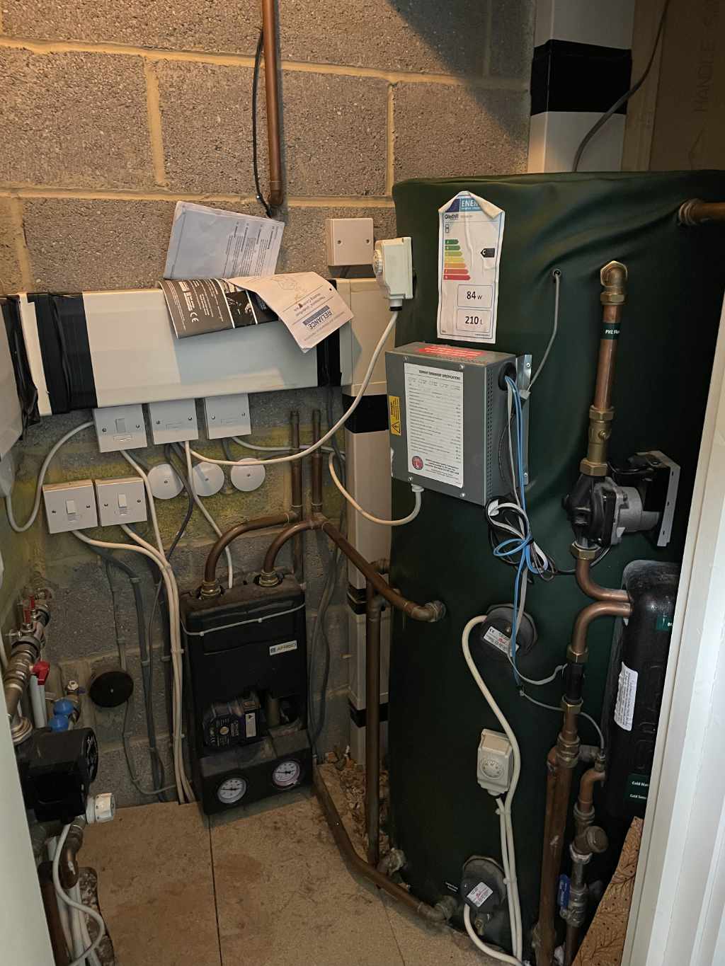

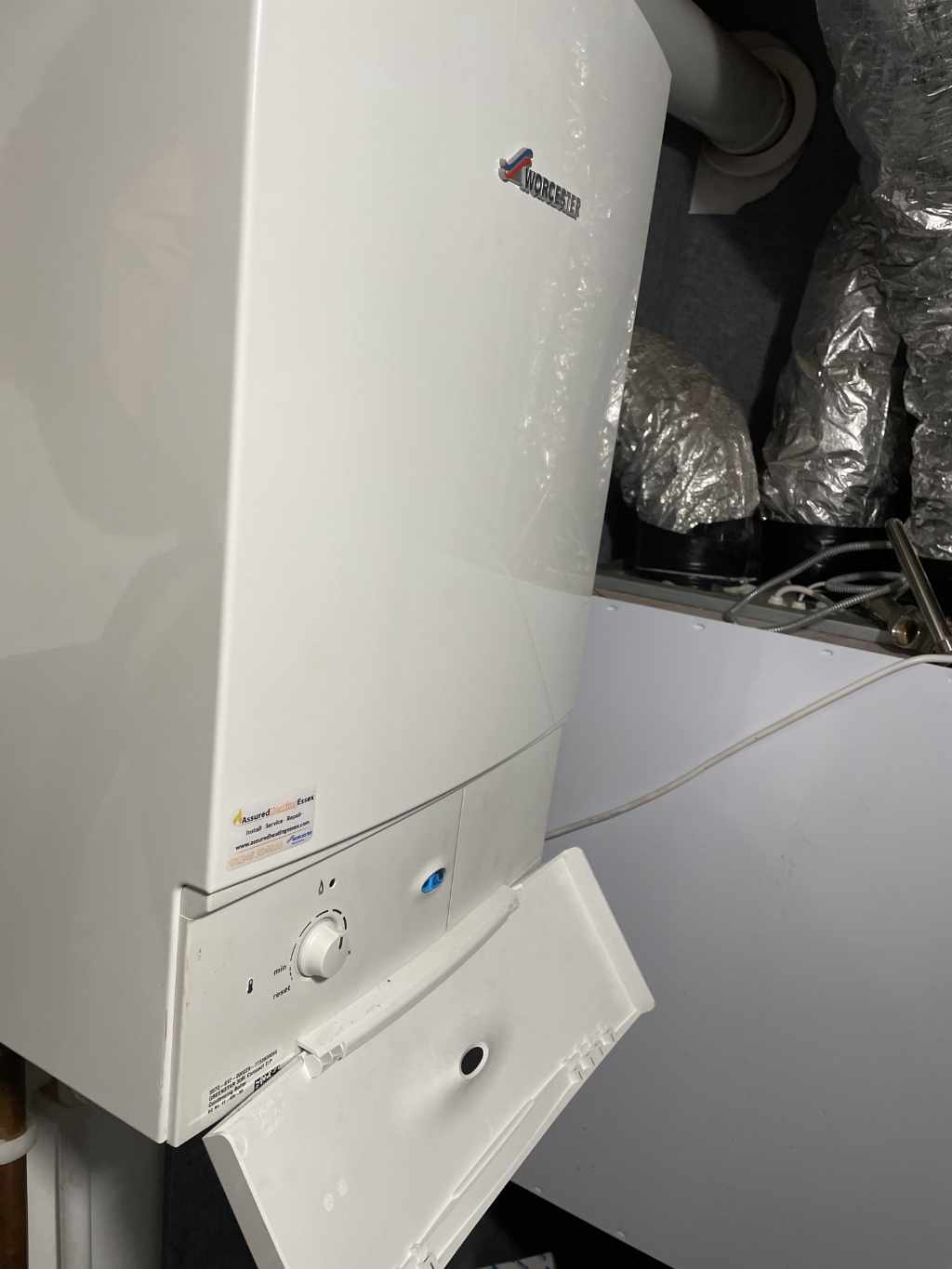

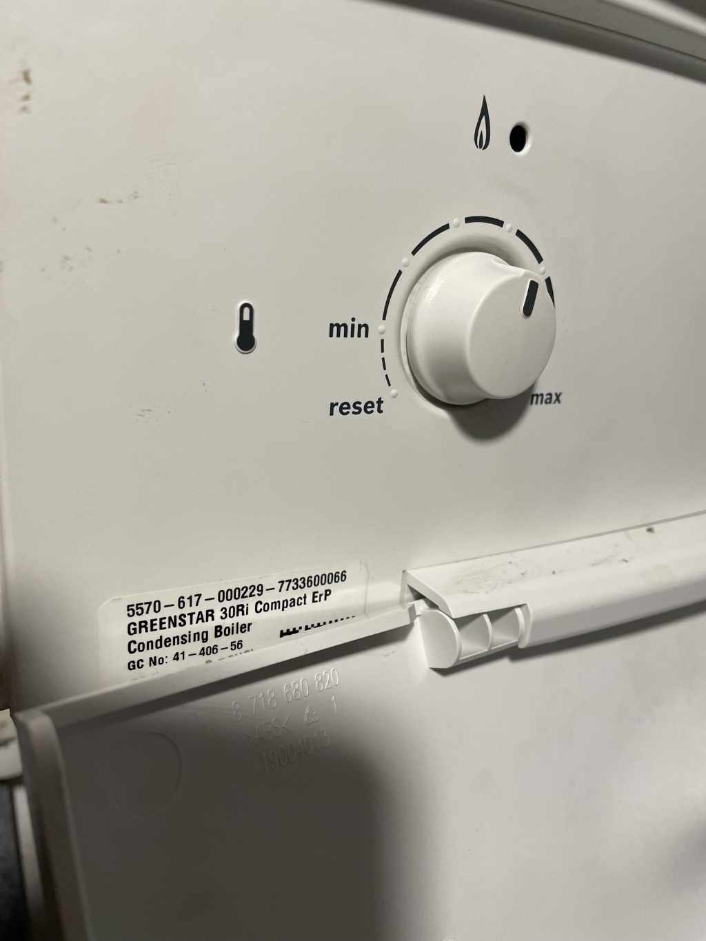

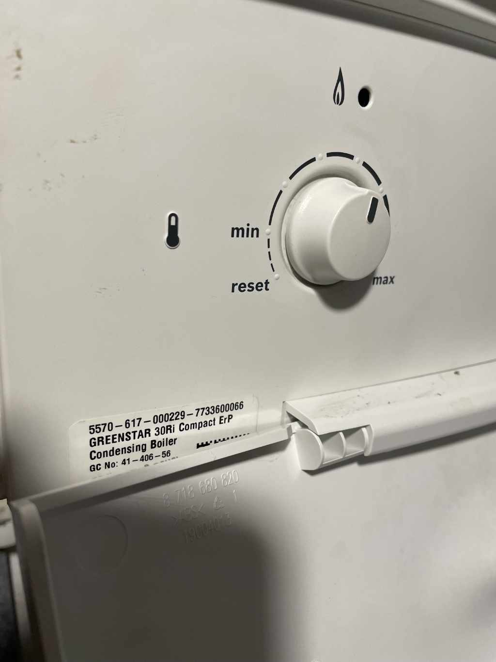

Ok, I've attached some photos of my system. I have a greenstar condensing boiler not a combo boiler as I previously said.

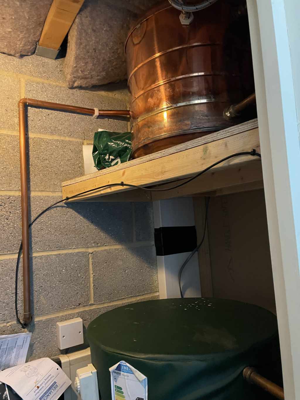

I've also took a photo of the water tank (unless it isn't a water tank) and the expansion tank above it.

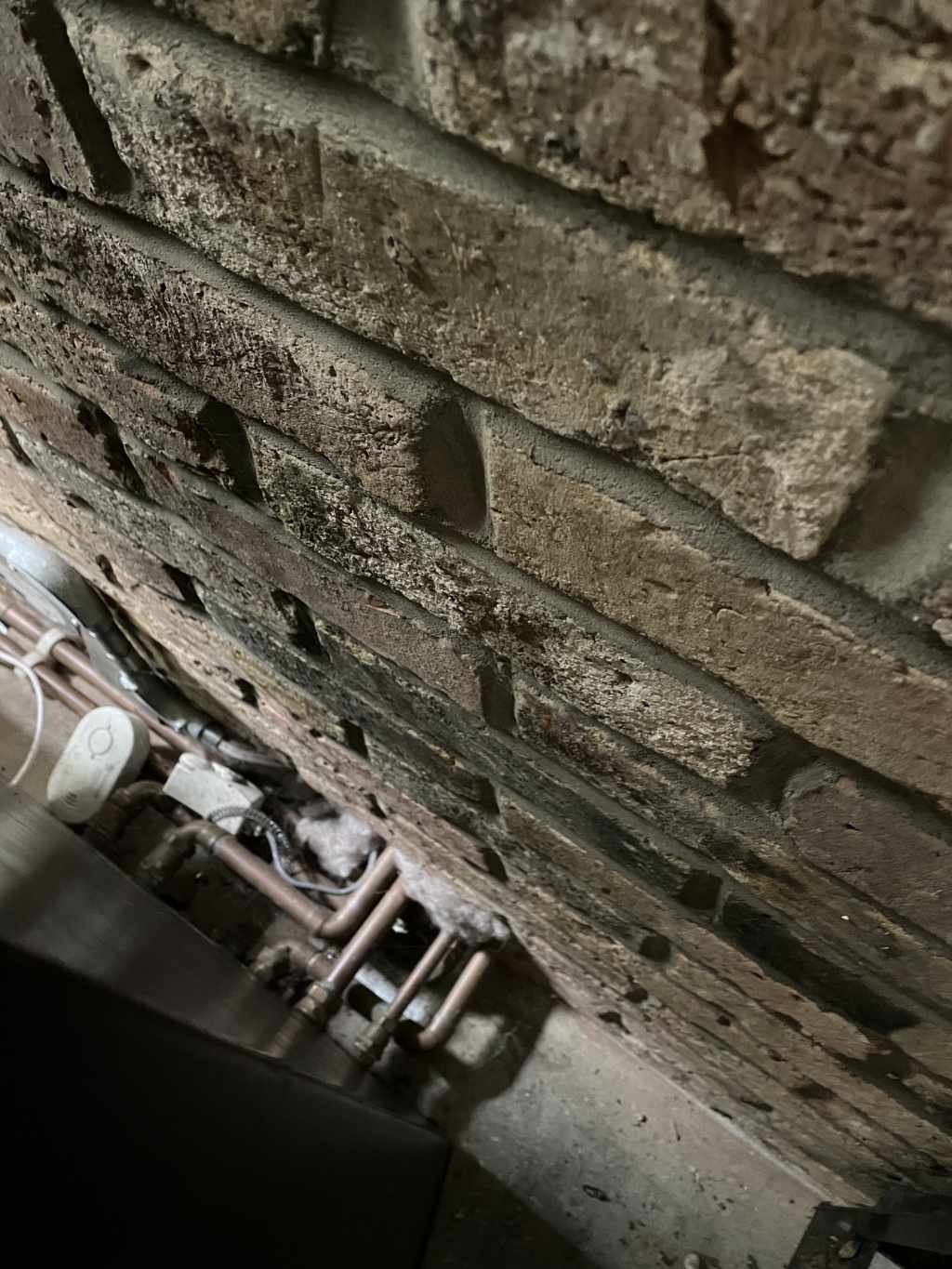

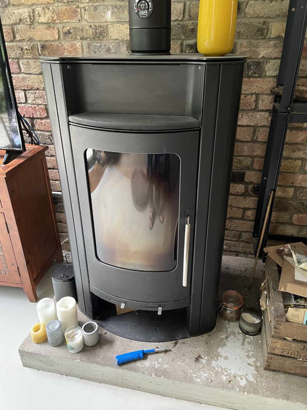

I may have led you down the path on whether the wood burner heats the hot water and underfloor heating as we have only lit the burner a handful of times last winter and so the greenstar boiler is doing the hotter and UFH . There are a couple of pipes running at the back of the burner so I guess it can heat the hot water. The model is Koppe Caron Aqua - here's the spec sheet for it

Looks like quite a decent setup there. The big green thing is your buffer- basically a big hot water cylinder. The black thing on the floor to the left of it looks like a loading valve (prevents condensation in the woodburner when it is firing and prevents backflow from the buffer when burner is cold & buffer is hot).
I can't tell from looking at it whether your woodburner is heating the cylinder directly (ie the cylinder water circulates through the woodburner-preferred option imho) or indirectly. Likewise don't know whether the Greenstar is direct or indirect.
Your hot water flow and pressure should be excellent- the black lump on the right of the buffer looks like a plate heat exchanger- can deliver up to 30litres/min of hot water at mains pressure. The heating (UFH, other radiators) may also be connected to the buffer so the woodburner or gas boiler can heat the buffer & the buffer then heats the house (same setup as I've got).
Have a good look at the buffer tank and all the control systems, see if there is an installers label on it. If you can find the serial number of the woodburner, get onto the suppliers & see if they have a record of a company buying it, ditto with the loading valve and gas boiler.
Changing that pressure relief valve can be a DIY job but it's a big and quite complex system, if you can get either the installer or another HETAS bid or a good heating engineer (not a boiler slinger) to visit (yes you'll have to pay them) and investigate what is connected to what and how.
If system was installed professionally it will be impossible to isolate the woodburner from the buffer and header tanks (to avoid turning it into a steam-driven bomb) but it would be wise to get someone to check before you start draining down....
