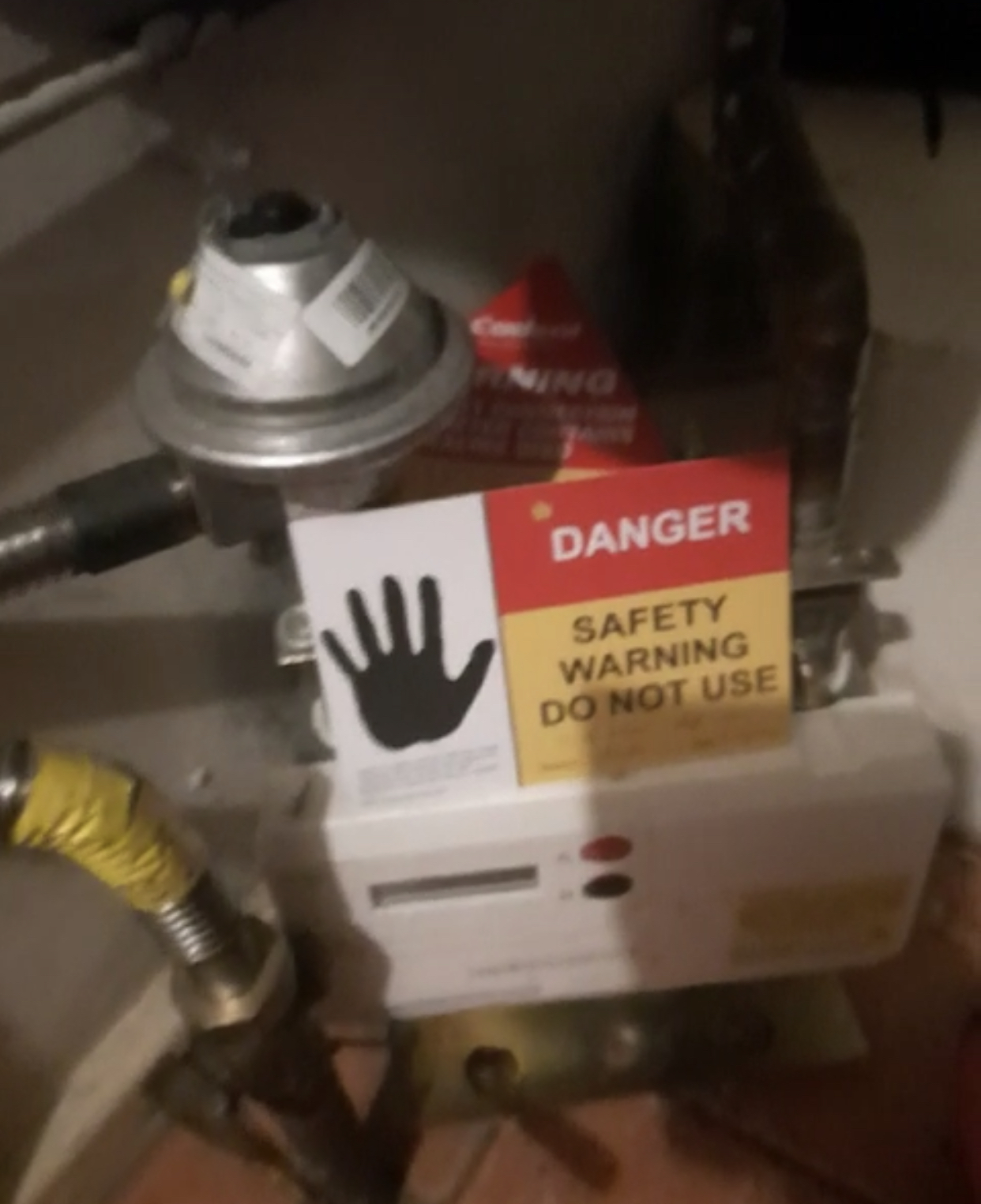

Posting on behalf of my sister and hoping that you can shed some light on this situation.
She was having a annual boiler service done and the plumber detected (by some method) that there was a gas leak.
He called out the gas board and after them doing the necessities, they capped the gas off. Here I believe.
They left very little information with my sister. We believe that they checked “their end” of the pipe and concluded that the leak was on “our end” of the pipe. Sound plausible?

The pipework leading up to the meter, and the meter itself are NOT owned or the responsibility of the homeowner/landlord/ tenant. Ever.
The house owner is responsible for anything AFTER the meter outlet.
Both Cadent (or similar), ie the "Gas Board", should have issued a warning notices, as well as the label. The notice should have carried the reason for disconnection. The meter will have a disc in either the Emergency control valve (ECV) , the meter inlet or the meter outlet (probably the latter). The disc interrupts the flow of gas and must only be removed by an RGI when tracing and repairing the escape.
The RGI should only have called Cadent if he detected the existence of a leak on the transporter property, or of you refused permission for him to disconnect the supply. If the leak was on the "service" side, so not your responsibility, Cadent would have organised a repair. One has to assume the leak is on your side, so you need to organise and pay for a "trace and repair".
If the pipe is buried, then it is normal to "re-run" the gas pipes. However, the appliances should be disconnected to test the pipes on their own - you don't want to replace the pipes and still have a leak. DO NOT ask someone to re-run the pipes without having the pipes tested properly - they may just do as you asked, and smile when the leak is still present.
Example of Warning Notice, has she one of these?
The disc that would be inserted in the meter work:

We spoke with the gas board in question today and they provided some further info. The gas has been capped after the meter and at the point that it travels through to my services. They confirmed that their testing (independent of the plumber servicing the boiler) indicated a 4-6 mg pressure drop. I assume that a test they can run from the meter.
I now need to get a gas safe engineer to determine how this should be resolved. Thankfully, the gas hob and boiler are not very far from the meter.
