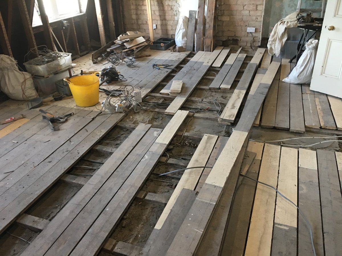

Hi Keith,
I've just lifted two whole rooms of T&G floorboards in my 100 year old Edinburgh flat. It's not that difficult once you get started.
First of all you will need to take the skirting boards off. In my rooms, they originally laid the floor starting at the window and working back to the door, so the nails are through the tongues, which are on the door side (if you see what I mean). You need to start lifting in the reverse order that they were laid. Once you have the first board up, then you should be able to prise gently at each nail point. What I found is that it was best to only prise all the nail points for a particular board up by a few millimetres, then go over them all again and prise by a few more. At some point the whole board will just pop up.
I was able to lift the whole floor will virtually no damage. One thing to be wary of .... if the property has an original partition then the floorboards might run underneath that. That's what I found, hence why I lifted 2 rooms worth of boards (after removing the partition).
If you look at some of my posts here you will see some photos.
Congratulations, but you neglected to say what type of nails you were dealing with (wrought, cut clasp, round, French, etc) and the species of tihe timbers you were dealing with (pitch pine, yellow pine, parana, etc), thickness, method of nailing, etc. Wroughts and cut clasps which are rotted through exposure to damp can almost weld themselves into place. There's also the little isue of patch repairs done over the years by plumbers and sparkies to contend with. My own (trade) experiences point to your single experience as being the exception as opposed to the rule but fair pay to you for pointing out the need to get very, very slowly - the same advice is also good for skirting removal (something every "soft strip" demo team I have ever encountered has singularly failed to understand - even when issued written instructions)

jwilson16,
Well done, and I agree with the drift of your post that its no big deal to lift whole T&G floors, even for a first time doing it DIY'er, just so long as its done slowly, and with thoughtful care.
And well done for having first class tools for the job
Once the first board is up, no matter how or with what the floor is nailed, the rest will flow.
A little vibration with a hammer will often offer the opening chink to get a prising tool in or, as we do, to use a reciprocating saw or a multi tool to cut the first glimpse of a nail.
Sometimes its necessary to remove the first tongue with a circular saw, esp. for patch work, but with the skirtings off its not necessary.
A couple of points:
always mark the boards (& sketch a rough map) before lifting, & stack them, de-nailed, in a logical order for re-fitting.
If you dont then you will end up having to cut a lot of boards.
Always de-nail immediately the board is up.
