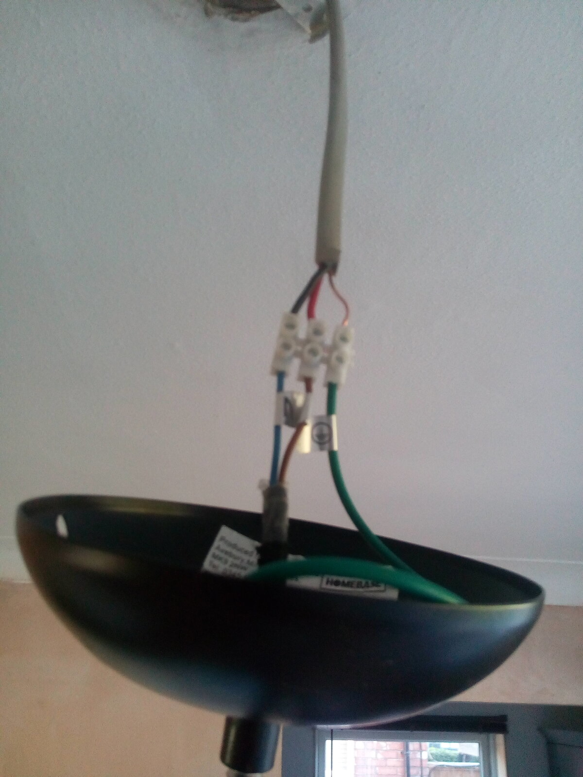

The bare copper conductor should be sleeved ,yellow / green.
And you need to check it is actually connected ,at its other end to earth.
You will need a meter to test that.
Hey, so it's connected see photo, sorry to harp on about it. I don't have a meter tester to do this if I turn the elec on now and try it what's likely to happen I have other lights in the house which work unsure if they have an earth wire with them all to make an assumption that's its earthed?

You must not connect a metal fitting without first checking that the earth is actually connected. You can buy a multimeter from anywhere for £10. If you don't do this you risk someone in your house touching the metal work and being electrocuted in the case of a single fault. Otherwise get an electrician in.

Ive taken the light fitting out fully and removed the earth wire from the terminal block and left it out of the ceiling so I can turn the elec on.
I'll have to sort it once the device arrives
If it's not earthed then I'm back to the same situation as before I guess

To be clear, if it turns out that you do not have a real earth in your lighting circuit, the choices are:
  • have your lighting circuit re-wired, or
  • don't use any fitting that requires an earth.
