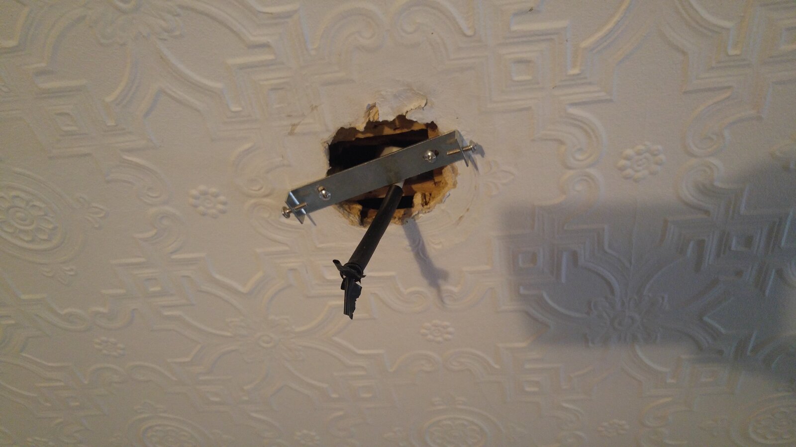

I then tested the light fixing (see pic) and saw that *this* was the cause of the live signal despite being screwed into wood. This led me to scan the surrounding ceiling and I saw that quite a large area was flagged as live by the detector (50cm2). Using an endoscope I inspected inside the hole and, whilst there were wires visible, they were not significantly close to the ceiling plaster, nor had I screwed through any of them. Measuring the voltage of the fixing using a multimeter measured 1.6v.
I don't understand - or is there supposed to be another picture?

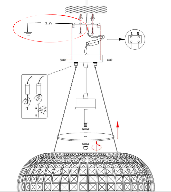

- The light fixing I'm talking about is the metal strip onto which the light is hung. This strip is screwed into the ceiling (as per pic).

When using a multi-meter connected to neutral supply, touching the metal strip fixing in the ceiling, shows the 1.6v I previously mentioned. Connecting the multimeter between ground and the light fixing gives 1.2V.
The screws of the fixing are screwed into plaster/wood. The screws and the metal fixing strip are not touching any wires.

While the light fitting itself might be double insulated the ceiling bracket with the cable passing it and the connections underneath it is not.
I would recommend earthing the bracket by connecting the earth wire to one of the fixing screws.
This would then likely remove the suspect voltage.
