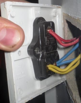

Hi,

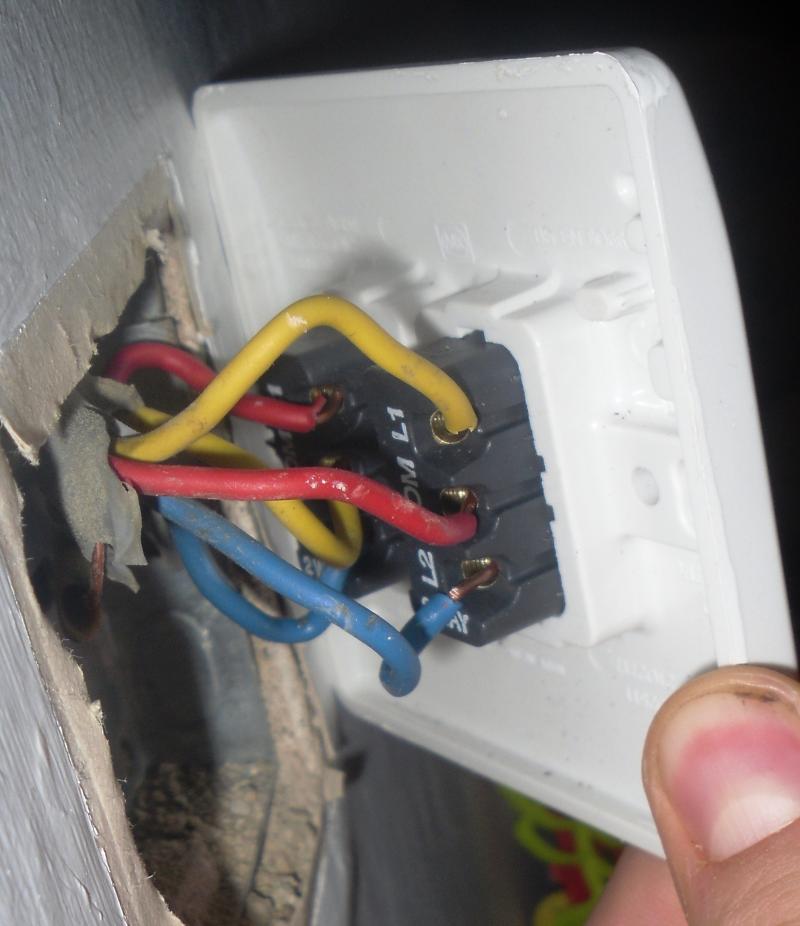

The decorator recently finished our downstairs rooms whilst I was away on tour, this included changing the light switches. The main living room light (normal ceiling rose variety) used to be controlled by any one of three switches. Unfortunately after he left, my wife found that the light now only works when the switches are in a particular sequence.
I presume he has rewired the switches incorrectly (or bought the wrong switches). Can anybody tell me what is wrong? Pictures of the switches below, two are single the other is a double, the switch nearest the camera is the one that controls the relevant light on the double.
Ta,
Jim
Switch 1 (nearest camera)
Switich 2
Switch 3

so lets have a look :-
1. no red sleeving on yellow/blue conductors
2. too much copper exposed on switch terminals
3. conductors cut bit too short for my liking
4. no sign of any earth sleeving on 1st picture
5. no intermediate switch fitted
6. different makes of switches fitted so will look gash
and you wonder why it won't work, you let an incompetent idiot loose in your home and you wonder why electricians get cheesed off when you see crap like this, would you let a sky engineer connect a gas fire, no didnt think so why did you not get the job done correctly in the first place. see the wiki for the correct wiring diagram!
Looks like the red and yellow are swapped round in switch one hard to say though. Especially as pic three you can't see the terminations
The blue also needs re-terminating as it looks like it's virtually hanging out (amongst other things)
you need an intermediate switch for switch 2 (these have 4 terminals)
The reds should be connected together here, insulated and not connected to the switch.
The yellow and blue from the one cable needs connecting to the bottom switch connections and the yellow and blue from the other cable needs connecting to the top connections.
The 3rd switch needs work too.
The 2 core cable with red and black wires need reconnecting. These wires should be connected into L1 and L2.
Switch 1 nearest camera
Put yellow in com
red in L1
blue in L2
Switch 2
Buy a 1 gang intermediate switch (4 terminals) to replace the incorrect one.
Put one red in top L1
Put corresponding blue in top L2
Put remaining red in bottom L1
Put corresponding blue in bottom L2
Put the two yellows together in a piece of 5 amp connector block
Switch 3
Put both reds in L1
Put black and blue in L2
Put yellow in com
My method differs from other posts above, simply to be consistent with the wiring of the other switch at switch 1, which I assume works.
I have selected yellow as the common, like the other switch at switch 1 to keep things the same.

Check switch 3 isn't an intermediate first, as someone here thought it could be.
Switch 1 is a 2 gang 2 way
Switch 2 needs to be a 1 gang intermediate (4 terminals)
Switch 3 should be a 1 gang 2 way switch (3 terminals)
As said, check switch 3 doesn't have 4 terminals. If it does have 4 terminals you have all the switches you need.
or did you say you had some left over ? do any of them have 4 terminals ?
