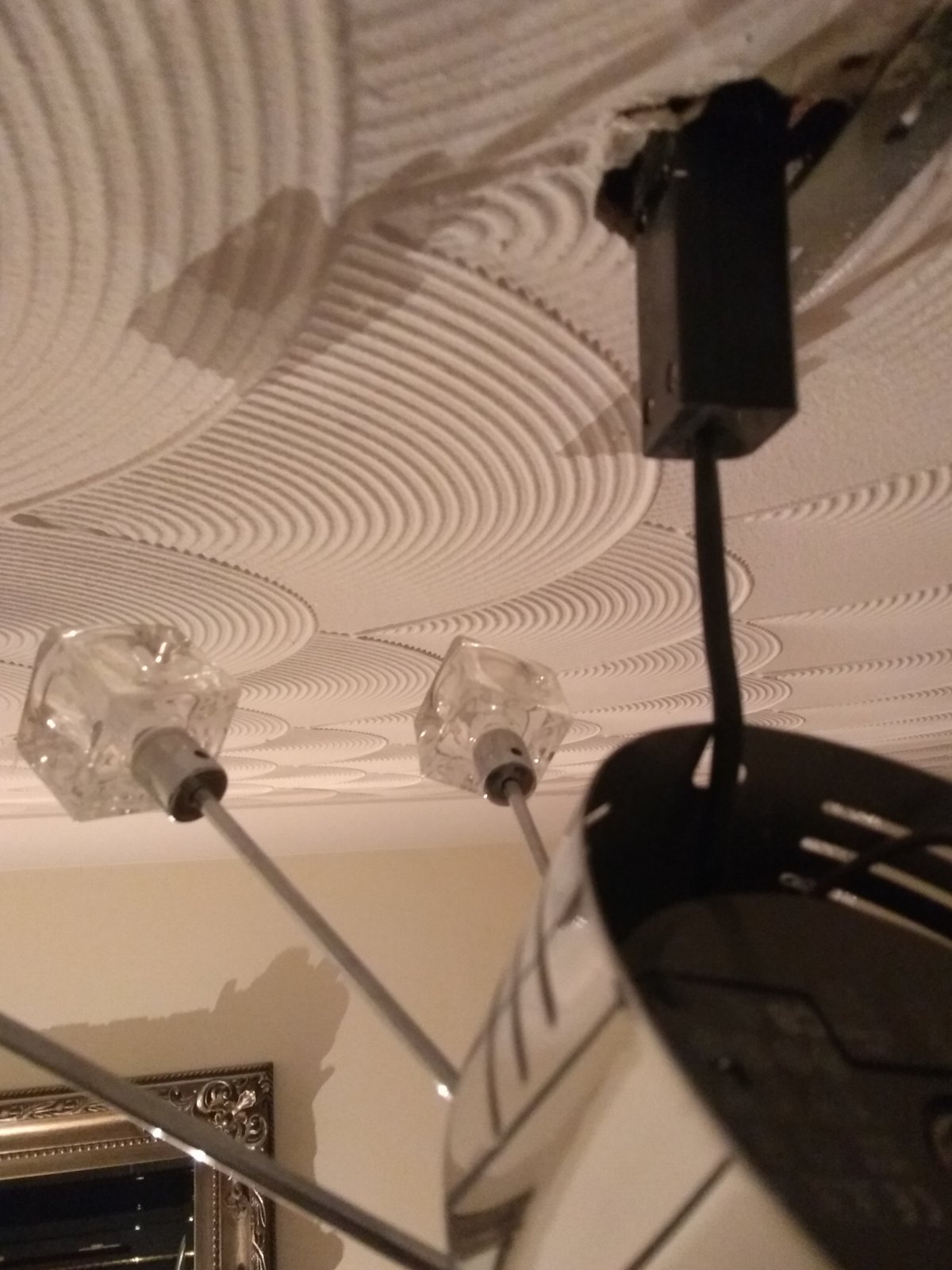

The wires above the fitting feed into a little black box mounted in the ceiling. Is that the transformer?

It's quite a long box but is slotted in the ceiling if you see what I mean.
Yes, that's quite possibly a power supply ('electronic transformer'). Can you see any writing on it which would give us more information?

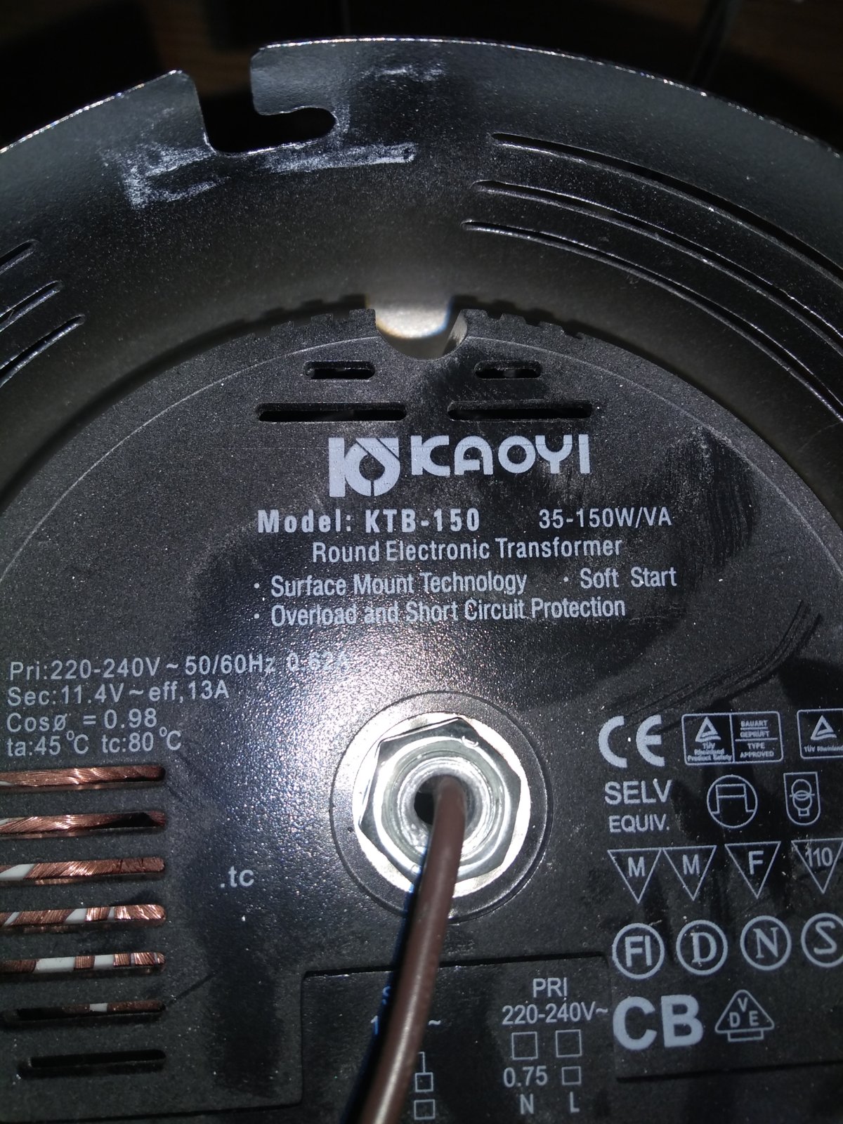

Looks like the box in the ceiling may just be a connection point.
The box inside the top of the light fitting looks like it has writing on it.
Usually, this type of fitting has a (sometimes circular) transformer in the part that attaches to the ceiling, hence the ventilation slots.

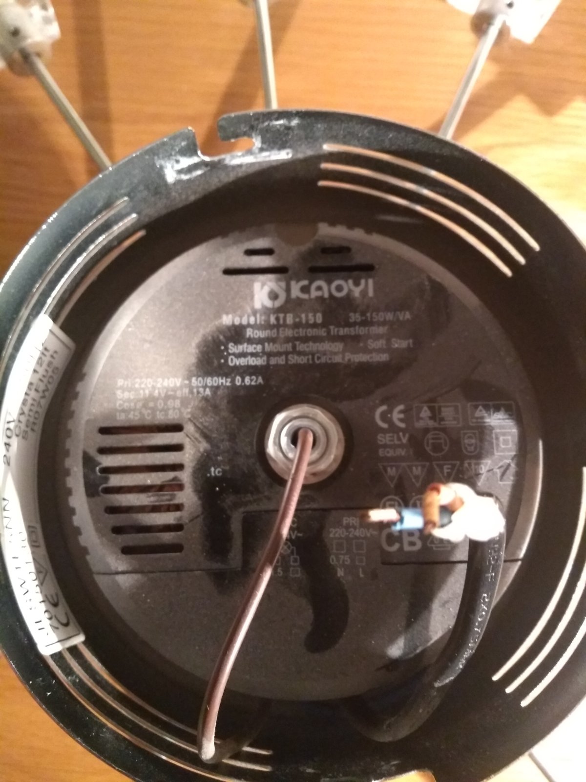

Indeed you're right. Taken light off completely this evening.
The transformer is circular and is within the light casing.
See piccy:
