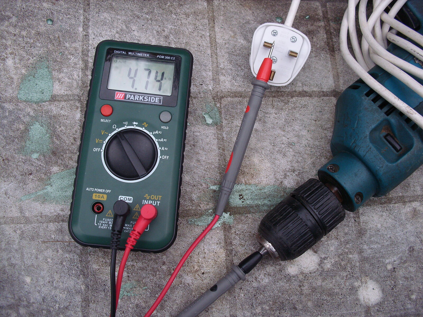

On the face of it, any measurable resistance between the chuck and live parts from which it is meant to be separated by "double or reinforced insulation" is rather a worry. Even at 1000V, one would not expect to be able to measure a resistance between two parts even if separated only by a single layer of very thin/flimsy (hence certainly not 'reinforced') insulation.
For what it's worth, I've just measured 4 Class II power tools picked at random (2 drills, one biscuit jointer and one mitre saw), all well-used and relatively filthy, and in all cases got ">1000 MΩ" at 1000V from the metal chuck (or other metal 'working parts') to both N and L (with and without the tool switched 'on'). I'll therefore be interested to hear what you find.

This drill was taken on site where they insisted on PATing anything electrical taken in. It passed, however first pull of thebutton tripped their RCD. It has been on the shelf in the shed for 2 or 3 years since awaiting repair. IIRC the reading with a megger was significantly rower resistance than this. In case it's not obvious the reading is 4.74KΩ

That's surely just "plain faulty".
I don't know about your "megger", but nothing I have for IR measurement will even attempt to measure a resistance remotely as low as that. My Fluke MFT would indicate what voltage it had had to reduce to (to limit current), and that would almost certainly have been (displayed as) "0V" with your drill !

Oh yes absolutely it's faulty but I do find powertools, and particularly jigsaws, do seem to have this issue with age, however it's certainly very unusual to drop that low. The irony is I'd changed the cable not long before this and therefore would have tested it, so the failure was fairly abrupt.

They fill up with crap.

In my experience the cooling fan blows or sucks the crap directly on the motor and gearbox, ie; the two main sources of heat.
That crap also contains, amongst other things, the carbon brush and copper commutator filings.
Additionally the gearbox is usually packed with grease and suspends any filings which, if conductive, can provide an electrical path between input and output shafts.
Ultimately any form of insulation can fail and having not opened that particular drill I've not attempted to establish the reason.
