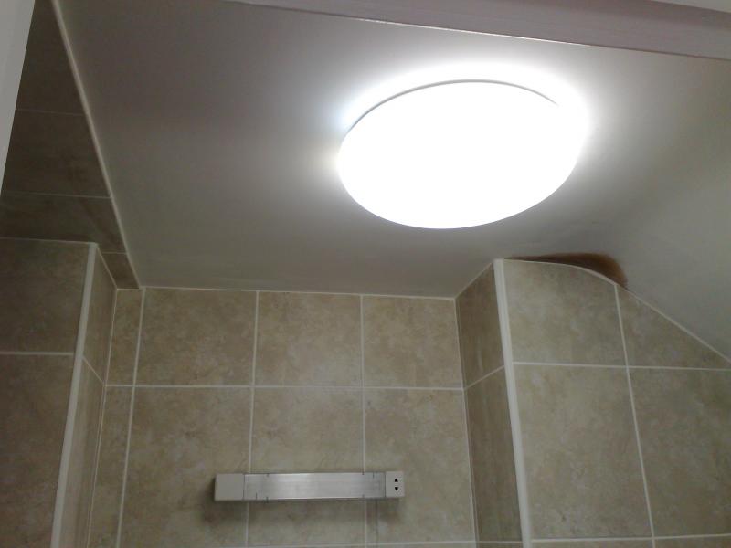

In a bathroom I like these
Plenty of good light.
Don't cost a fortune to run.
Reliable too.
These give off a very nice light. We have one in our bathroom with a circular fluorescent tube inside. Give a very soft light without harsh shadows, especially coupled with a large mirror.
My concern with downlighters would be that in a shower cubicle your head might block all the light and cast annoying shadows over the place. I'm not just making this up, I have experienced it - not pleasant. I've also nearly burned my head on a downlighter fitted to the sloping ceiling above the toilet in an under-stairs loo! But that's a different story...
However, with white reflective walls, floor and ceiling in a fairly large bathroom, you should probably get enough reflected light to even out the uneven light produced and get rid of most shadows.
Despite this, I would seriously consider the fitting in that photo above. I think B&Q sell them.

They are at Screwfix here
£33 each.
I also like the fact that they come complete with a rubber sealing mat and that if any condensation is around it is likely to run harmlessly to the middle of the plastic dome and drip down, rather that get inside.
