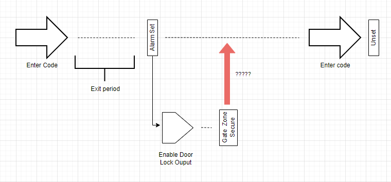

The magnetic lock has a reed switch built-in which reports whether or not the door is secured or not. I'd like to use this as a dedicated zone to monitor for someone forcing the gate lock, but the reed switch only actually reports "closed" when the gate lock is energised, not when it is unlocked. This means that using such a zone as part of a program is problematic as it will report "open" until the gate is locked and as the gate lock is only energised when the alarm is set, the system would never arm.
Is there a way to allow it to ignore a zone for a number of seconds after the alarm is set, or perhaps ignore it altogether until it starts to report "secure", even if this does not happen during the exit timer? Alternatively, is there any way for an output to fire when the system is in exit *and* remain on after the system is armed?

This does make sense - the documentation doesn't make it clear that the when using Force Omit that the zone only remains omitted until it's secure, at which point it becomes a guard zone again. What I'm trying to achieve is something like this:
As you can see, the gate zone will never report secure until after the gate lock is enabled, which will always be after the alarm is set. I could do something clever to enable the gate lock earlier (e.g. during exit) so that the gate zone has chance to become secure before the alarm is set, but I need to think about what's actually possible with Texecom outputs as this would need the gate alarm to be enabled under both exit *and* alarm set conditions, which I don't think it will do by default (unless I start playing with custom outputs, or physical wiring - both of which remain an option).
I don't think that settle time will help me here as this just extends the period before the alarm is set and thus the gate lock enabled.
so a custom, output that fires when the system is in exit or set should keep the gate locked
(energised) if it isn't then the contact remains open until the gate is shut.
The problem with force omit is you would never know if the gate was actually closed/locked.
so custom output 1a programmed on an actual output for the condition 1 exit, 2 armed and which area is armed.
without testing its hard to say if it would also work in part arm, however you have to test the conditions and select the correct option whithout testing on your panel and firmware version i cant predict how it would actually perform
