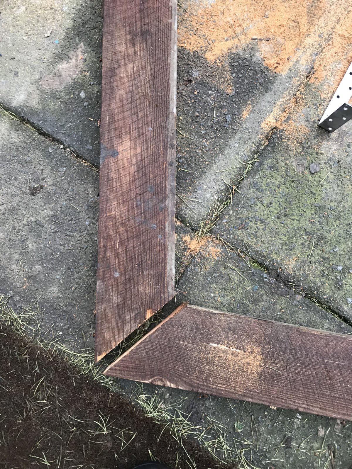

Making this joint as strong as possible?
14 Sep 2010
7,034

Would you glue and screw ply either side? Bolt it through?
It’s going to eng up being a roof with no cross bracing.
Skip to 2:30 for adding hardwood splines...
...and as big of a plywood gusset either side as you can fit in there without losing too much headroom.
I think I would balls up the spline but could definitely do the gussets.
How else could you join them before adding the gussets? A few big screws
A half lap joint is a reasonably strong joint.
With your join not being 90°, it makes it a bit trickier to work out the angles, but it's do-able with just a circular saw and a chisel. A sliding mitre saw with trenching facility(i.e. depth stop) would be even better.
Can't. You build a ridge then fit the timbers against that?
I could but one side would sit on the top of a upvc triangle. I could make a double one just inside the upvc to hold a ridge. The ridge would be 1.2mtrs long.
Support it on the inside with a bit of vertical timber the same size , under the ridge, then clad both sides with a piece either side longeras side support . If looks are important, cover it with upvc
The strength will come when it is all assembled- a bit like a boat
ideally you need to make it more off an "A" frame both with ply and a cross bit near the bottom but could be as little as 2ft from the top but the further down the better to stop it bellying out
