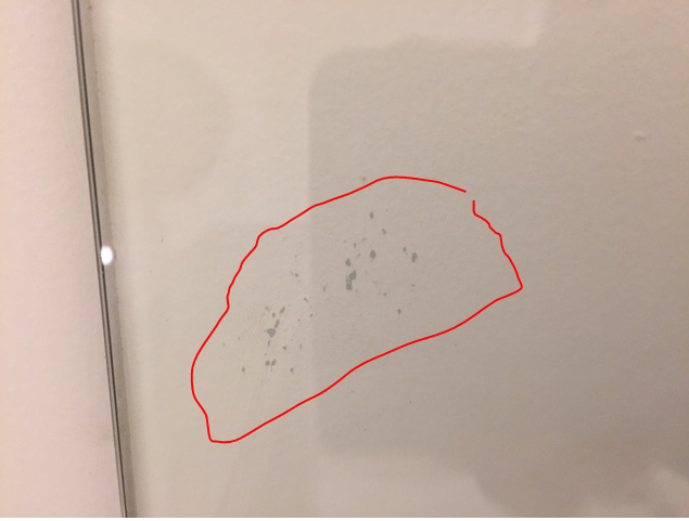

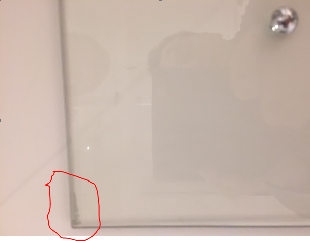

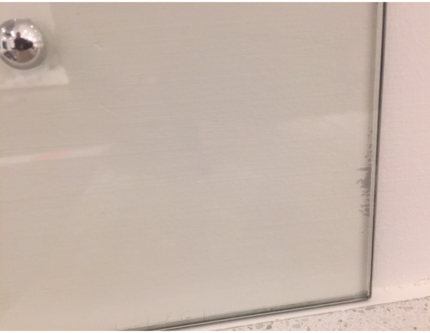

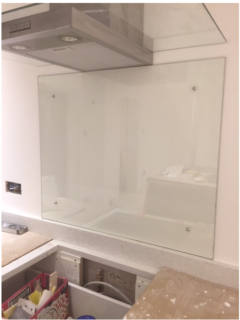

I have a simple 900mm wide clear glass splashback with 4 holes that sits on the worktop upstand and topped by the fan shroud hood - see photos.
The glass is fastened to the wall with 4 mirror screws but there were no spacers to keep it from touching the painted wall. This is an all new kitchen and the glass is starting to show the paint in small blobs where the glass directly touches the one week old paint - Dulux Trade Diamond matt.
If this was a solid colour glass then it would likely be stuck to the wall, but this is pre-drilled and is meant to be screw fastened to it.
It seems logical that there should be some spacers to set the glass 2mm or so away from the wall painted surface. What should I do and use? Can I get clear plastic washers, small ones but thick enough to do the job?
Many thanks

I once made some washers from clear bathroom silicone by flattening it between layers of cling film. Im sure you could fashion some in a similar manner.
Just a thought
Graeme
Eta would that not let gunk get behind it over time though?
You can add a small fibre washer behind the screws, and they should be covered over by the chrome heads
There should be a set of those already, but you could cut the extended piece off of them, and that would work.

Others - thanks for the constructive comments, I'll use some kind of washer/spacer behind the glass just to keep it away from the wall, by just 2mm would probably be enough.
There were stepped clear collars supplied, but the fitter used them with the 'top hat' outwards. I suppose that was because the mirror screws are countersunk and would have easily damaged the glass, needing something to absorb the pressure on the glass from the screw? Don't know - I really hate paying someone to do a worse job than I can.
I will perhaps run a thin bead of clear silicone down each side to keep muck penetration to a minimum.
