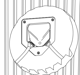

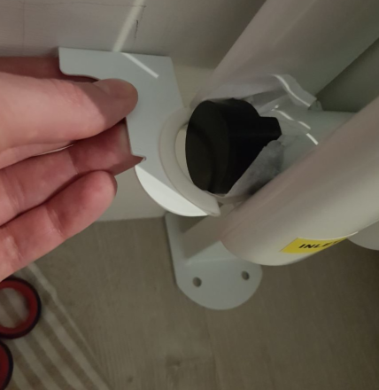

The old radiator has a 3 cm gap between the wall and the rad, allowing the use of the following pipe guide and seal:

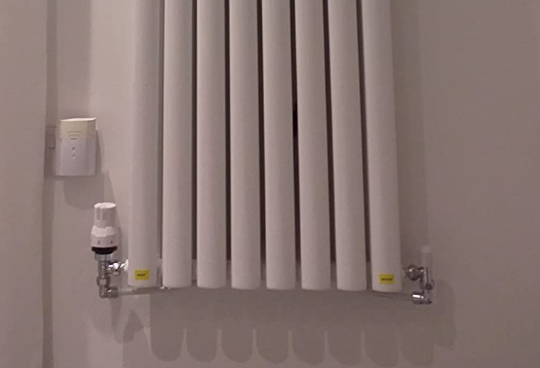

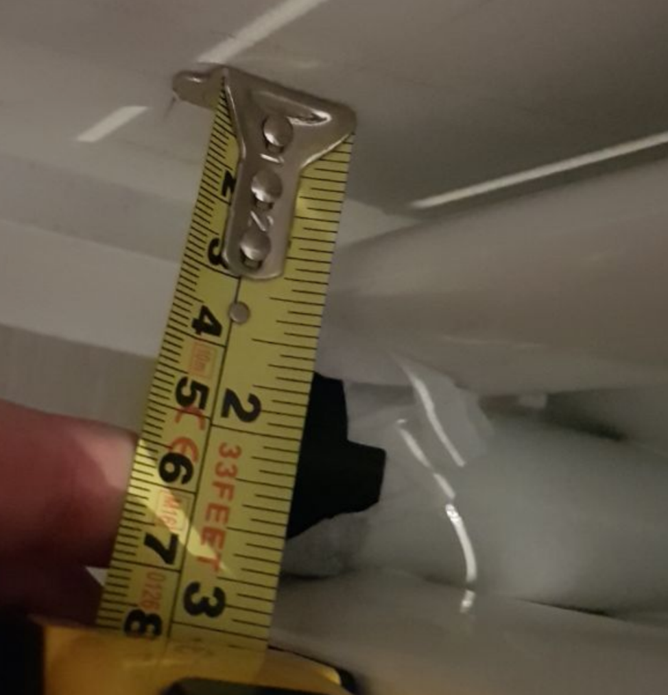

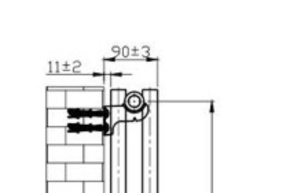

The new vertical one has a much smaller gap (11mm):
I am working with JG Speedfit 10mm pipe.

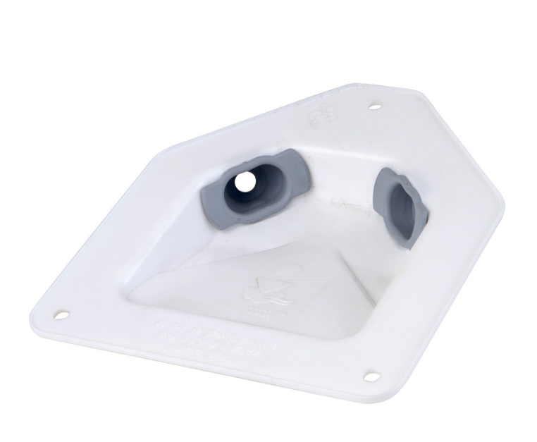

One option would be to use a seal like this:
But this would mean running the pipe between the wall and the radiator, nearly squeezing it with the surface of the rad. Is that allowed?

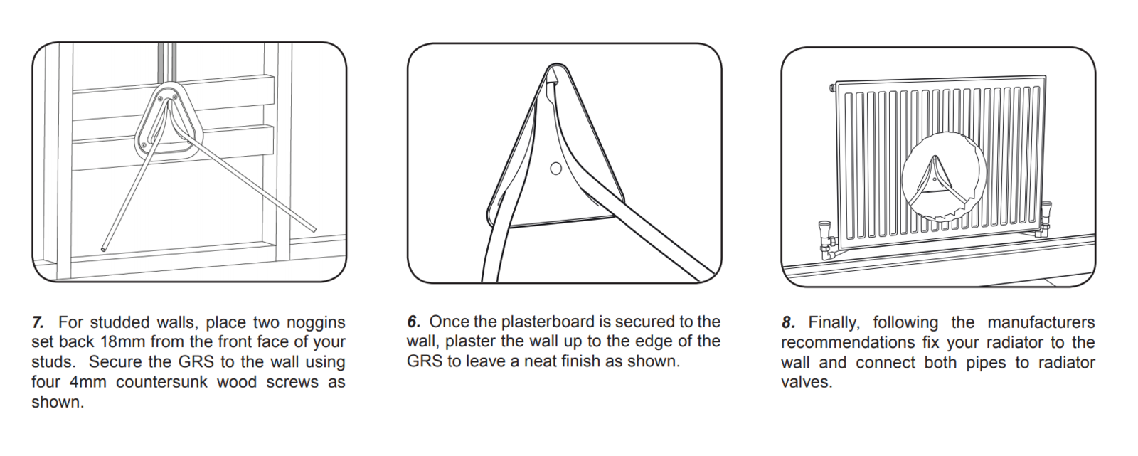

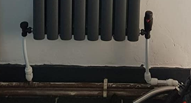

Alternative installations that I have seen online look like this:
How could they pull off the install in the last one?
What other options do I have, given the radiator feet leave very little space at the bottom:
Thank you for your ongoing support!
If the pipe fits it'll be perfectly fine. You might even be able to reverse your current pipe outlet but if it's not been designed for flush mounting the pipes might foul the plastboard sides/back. If I was concerned about potential noise from any expansion-related rubbing (unlikely, but I always fear the worst!) then I might wrap a little bit of felt pipe lagging round the pipes where they might come into contact with the radiator.
What you mean by that question? It looks like a normal installation to me?
Thank you for your prompt response, MJN!
It is great to know that there is no danger in having the pipe so close to the hot surface of the radiator.
I wrongly assumed that you couldn't have the PB pipe close to the rad! That's all.
Out of interest, could I win a few extra millimetres by using a spacer? I guess that won't be a massive issue if the radiator legs are used..
That why a lot of these pipe guides are fitted recessed, a lot of radiators are mounted on the short side of the bracket and then don't allow enough clearance for the guides to be surface mounted as they always foul on the radiator. We would always fit them recessed.

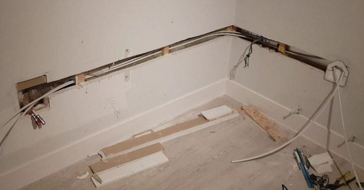

I have now completed the move. Here are a few things that were unusual or of interest:
The original radiator feet supplied with the column rad were not high enough to lift the lower part of it over the skirtboard. We have this large skirtboard in our newbuild. This meant that I could not add the bottom mounting brackets, as they were catching on the skirtboard if I wanted to install them. I've used a junior hacksaw to cut off a redundant part of the bracket, to add extra support (perhaps, also redundant :) ).
Running the actual PB pipe was super-easy. I have used a bit of spit, as advised, to help get the speedfit in place, and all worked like charm. A little access hatch was provided to allow isolating the retrofit system.
First issue was that the corner of the house didn't actually leave me any place to run the pipe, so I've just dented a little cavern in the two studs to allow some space for the pipes (and their isolation).
I know they always drop the pipes from the ceiling, but I have no idea how I would have opened the ceiling to re-run the pipe.
The second issue was getting the 10mm pipe to bend the way I want it to, through the face fix plate. I ended up making a loop inside the wall, to bend it the right way.
Getting through the exterior wall was a massive pain, as it had a layer of wood between the plasterboard and the TSW studs with insulation behind them. My cheap multitool has barely managed to get through it. The Japanese blade was completely ruined, and only the kit half-moon blade was able to slowly cut through it. What a tough material!
Putting the wall back together and plastering over it was horrendous, as in the exterior wall I could not rest the parts I've cut out on any studs - there was a power socket in-between, which prevented the cutout from staying in one piece. Or something like that :)
