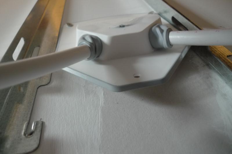

:LOL: Funny though, just shows you how good some installers can be, that pipe guide is on back to front, they would usually recess into the wall with the seals at the top, not sit proud of the wall :LOL:

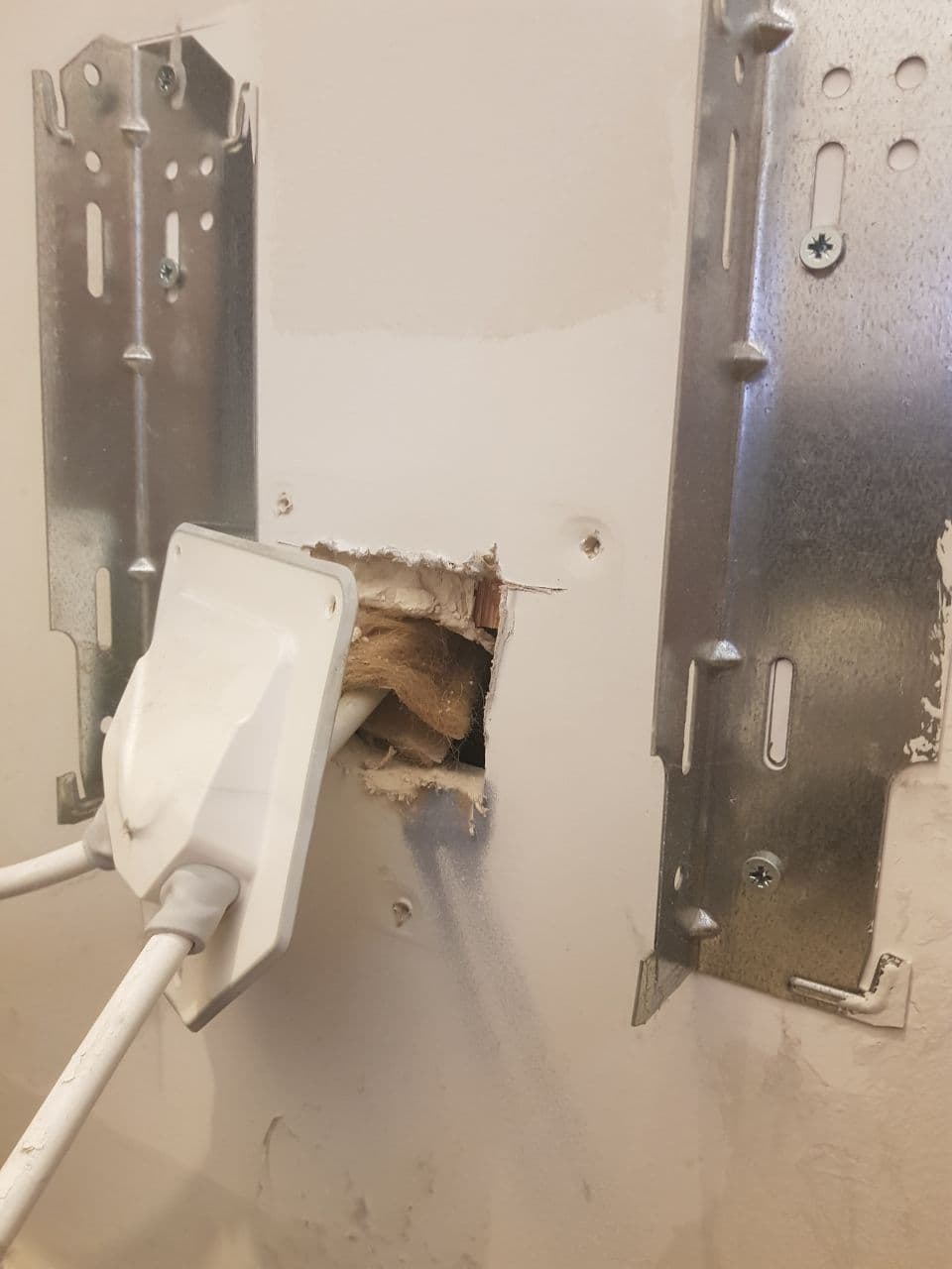

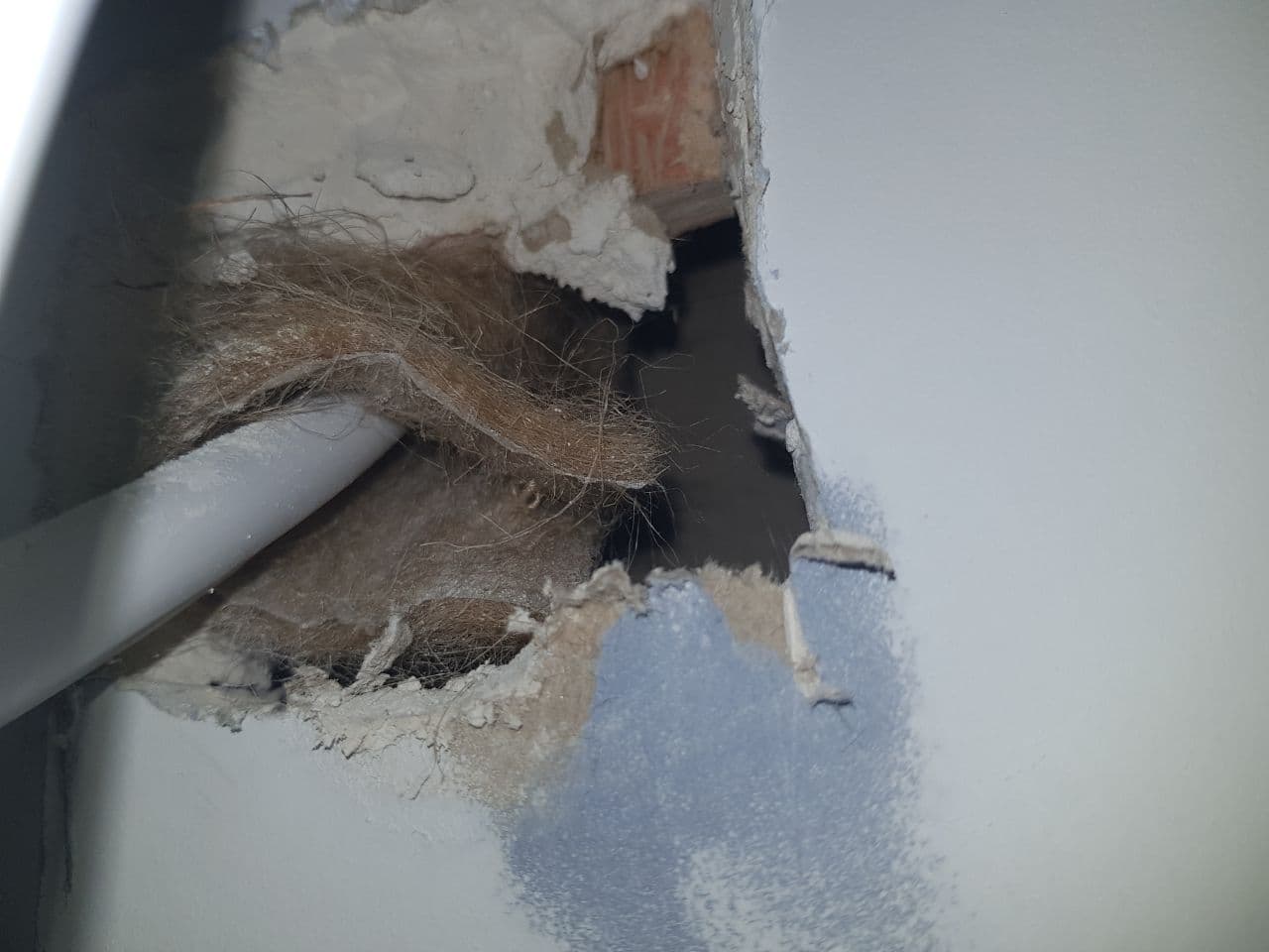

Here is what I found:
I can't see far into the wall, but it does appear to be a 10mm pipe..
It would be fantastic if I could simply extend these 10mm pipes.

Personally I’d go skirting board level, preferably in copper, but that’s up to you and confidence. It wouldn’t drop the pressure, but iirc anything above 5m can give problems, possibly circulation and balancing issues.

The pipe should have some writing on it, eg hep2o or speedfit, so go with whatever the existing is and the same in fittings, however they are quite bulky.

Couple of elbows will turn the pipe to the direction you want it to go to.
Just use the same pipe, inserts and fitting as the pipe that's already there. Get pipe shears that will cut the pipe nice and clean and straight and make sure the pipe is properly inserted into the fittings.

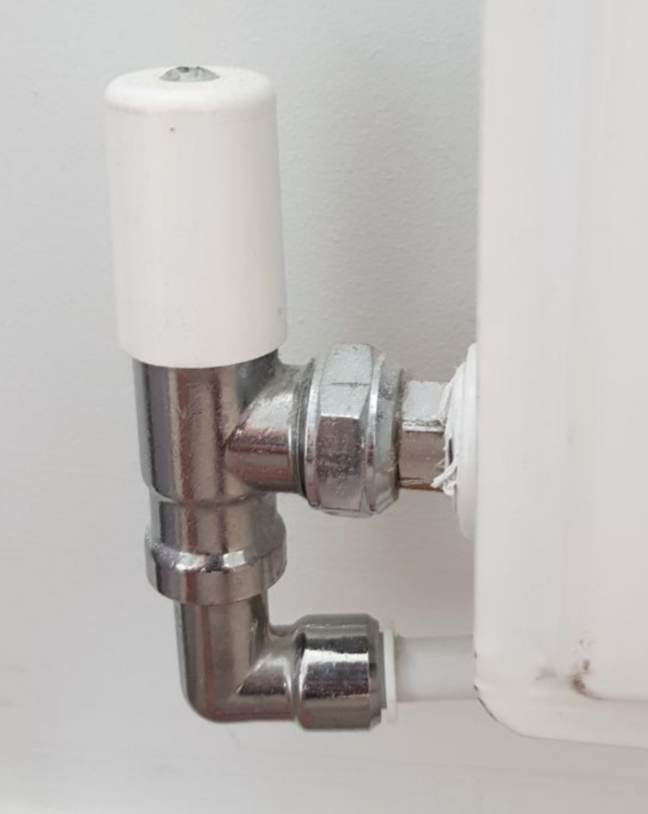

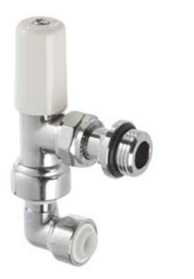

One of the parts that I was after is the so-called '10mm bracket' (3 minutes 33 seconds mark):
Here is what it looks like on my radiator:
But I can't find this part on screwfix/toolstation at all! Could you please help me find out its proper name?
The one you pictured is a 10mm push fit angled (bent) lockshield, looks like the myson one tbh. The stem elbow pushfits into the bottom of the valve, as against a normal compression end on the lockshield. The compression is probably more secure though TBH.
Thank you, I now know what the part is. And it is a Myson! Impressive valve identification skills!

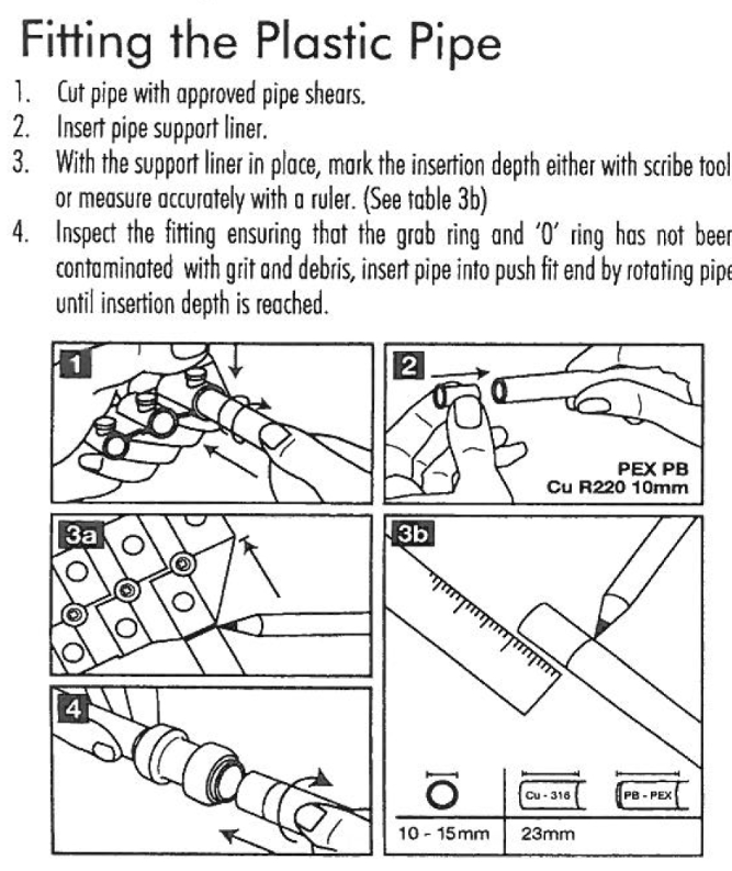

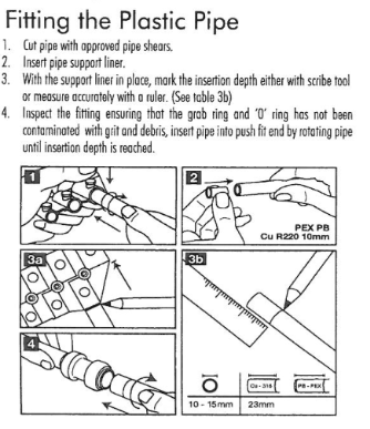

Can I please ask one more question?
I have brought up installation instructions for a Pegler Terrier Lockshield radiator valve angle pattern with push-fit elbow
And it suggests that I simply need to insert the liner into the pipe and push it in.. I appreciate that it's called a "push-fit", but is it actually enough to secure the connection??
For example, the standard push-fit connectors include a ring that you need to twist to secure the joint. In the example above there is no ring. Is pushing the hose into the elbow enough?
