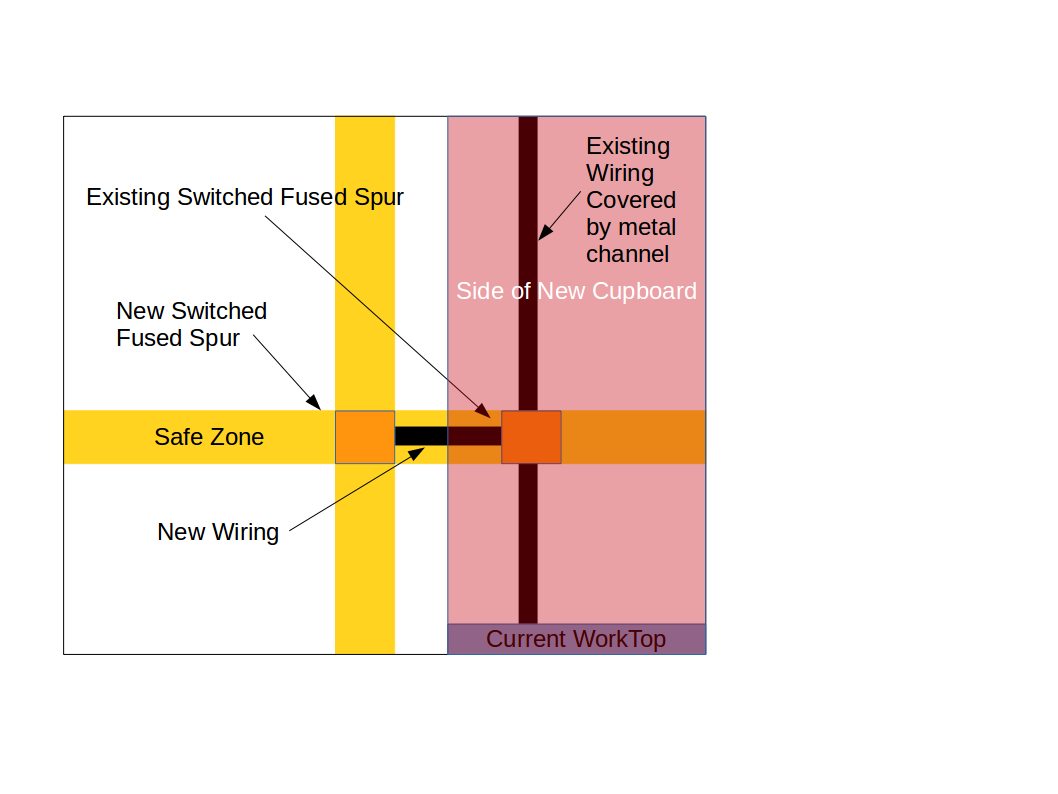

We're in the process of re-designing the kitchen. At the moment the switched fused spur for the washing machine is on the wall just above the worktop - however as we'd like to put in a full height cupboard there and the switch will need to be moved, as it'll be covered by the side of the cupboard. If it moved 30 cm along the wall all would be fine. Hopefully the attached picture makes sense.
We've spoken to a couple of kitchen places about this, and the general view seems to be 'That's not a problem, we'll just connect some extra wires up to in and move the switch 30cm to the left - job done'
I'm not an electrician, but I understand that wiring should run vert or horz from any socket/switch in the 'Safe Zone'. The existing switch location can be seen covered by the new cupboard side. My concern is that with the switch moved, although the new wiring would be in a considered safe zone, however as no-one would be now aware of the existing switch location - will the existing vert wiring will no longer be in a safe zone? Or as it's covered by a metal channel (as less than 50mm from the surface) would that be considered suitable safe anyway under the rules? As the only other way would be to move all the vertical wiring along the wall 30cm.
Just wanting to make sure no-one's doing anything silly that'll bite me on the arse when I come to see the house, or could be dangerous in the mean time.

Kitchen places are not electricians, and it was due partly to those cowboy approaches that the whole part P thing came about. I feel the metal channel will not make it safe under the rules, but others may have other ideas.
You don't actually need a switched FCU for a washing machine as there is a fuse in the washing machines plug. You may want an isolating switch but that is not required either. For isolation you can't beat pulling the plug out.
You could of course leave it where it is and have a hole in the back of the cupboard in that position.

In my experience kitchen fitters know very little about wiring and building regulations. So not to be trusted when comes down to altering electrical circuits and accessories.
You have the general idea with regards to permitted safe zones, more detail can be found here https://www.diynot.com/wiki/Electrics:walls.
Protecting the cable with a metal plate or using earth shield cable is an option. The metal plate is not the capping plate used to secure cables, it will need to be a higher gauge than that 3mm probably. And burring cable in solid walls greater than 50mm (which also applies to the reverse side of the wall). Would need to comply to regulations concerning depths of chases in walls (Part A building regs)
There is another thing to consider when installing new cable and sockets, the requirement for RCD protection maybe needed.
Another option is to keep the original accessory in the back of the cupboard as a blanking plate, then do what you proposed. Then you can maintain the connections too if necessary.

Thanks everyone for your replies. Due to this, and other issues with the design when trying to put a full height cupboard in the kitchen, we're going to scrap that idea so the switched fused spur will stay put.
Fair enough but consider changing it for a 20amp switch. As I said, "You don't actually need a switched FCU for a washing machine as there is a fuse in the washing machines plug".

Extending the cables will be fine I'd personally blank the existing spur box. Make a joint in it so it's accessible and run it along to the new back box
