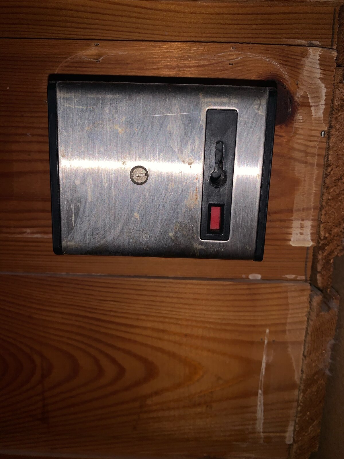

    My son just moved house and we found this . Tried google image search nothing showed up.
    Can anyone help us out and tell us what it is , or does ?.

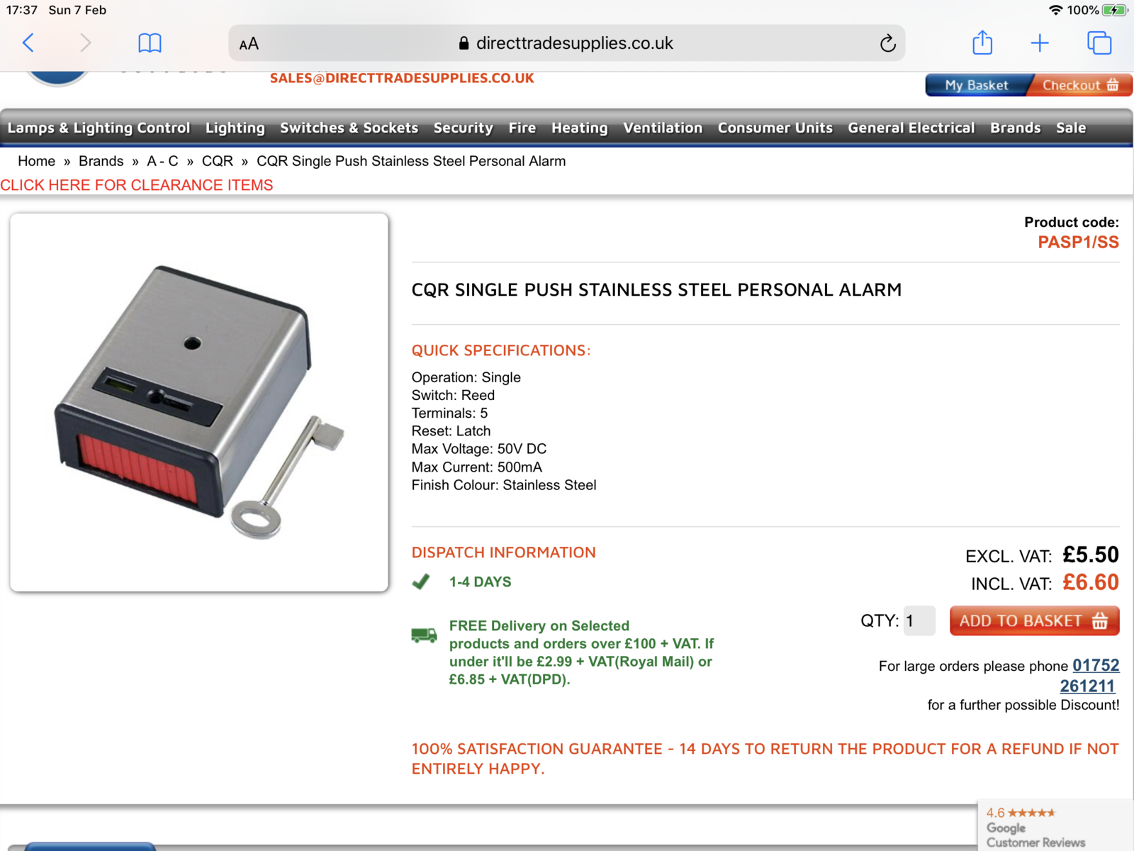

    Hi rsgaz
    Thanks for the reply. Its on top not inset . Checked out your link , looks like this one could be an older version .
    Doesn't give any information how they work or who moniters it . Would it be safe to rip it out , without the risk
    of the police crashing in the front door.
  6. Harry Bloomfield
    Harry Bloomfield
    Joined:
    30 Dec 2018
    Messages:
    9,598
    Thanks Received:
    1,297
    Country:
    Seems an odd way to trigger a panic system. I would expect something much easier to trigger. Could you remove the screw in the middle, take the cover plate and take another photo of the internals? The knob above the red light, looks like a slider type volume control, can it be moved?
    The style to me, suggests 1960's.
  7. crystal ball
    crystal ball
    Joined:
    28 Apr 2004
    Messages:
    5,526
    Thanks Received:
    340
    Country:
    I have seen these in a jewellers shop, they were linked to the alarm and then to a monitoring service (ADT) looks like the key is stuck and broken
  8. Manus
    Manus
    Joined:
    30 Apr 2018
    Messages:
    4
    Thanks Received:
    Country:
    Thanks Harry Boomfield , crystal ball.
    Will take the cover off next time I'm there and take a photo of the inside , and post .
    The photo is not to clear the red is just plastic not a light , I think , its behind a wardrobe very awkward to see it.
    Above the red is like a keyhole.
    Thanks again for you're replies.
  9. davelx
    davelx
    Joined:
    26 Sep 2006
    Messages:
    1,933
    Thanks Received:
    172
    Location:
    London
    Country:
    It is definitely a person attack button that would be linked to an alarm system. On a monitored system, pressing it would usually silently alert the monitoring station who would call the police (or in some instances the alarm might call the police directly).

  11. securespark
    securespark
    Joined:
    11 Jan 2004
    Messages:
    37,338
    Thanks Received:
    1,306
    Country:
    Yes, assuming the panic is connected to alive system, if you take the cover off it will either sound off or do as Dave suggests.
  12. AndyPRK
    AndyPRK
    Joined:
    4 Jan 2009
    Messages:
    5,935
    Thanks Received:
    596
    Location:
    Herefordshire
    Country:
    red flag means it's already been pressed!
    No alarm or police, so you can take the lid off and disconnect
  13. AndyPRK
    AndyPRK
    Joined:
    4 Jan 2009
    Messages:
    5,935
    Thanks Received:
    596
    Location:
    Herefordshire
    Country:
    All that is inside is a reed switch and maybe 3 terminals.
    When the magnet isn't by the reed switch (either because the buttons been pressed or the cover removed) the alarm goes off.
    1980's
    • Thanks Thanks x 1
    • Like Like x 1
  14. sparkymarka
    sparkymarka
    Joined:
    16 Feb 2011
    Messages:
    9,024
    Thanks Received:
    1,380
    Location:
    Sheffield
    Country:
    8A2D739A-C6B9-42E6-BC02-B13755F75B16.png They still make these ....it’s not that old ...

  16. sparkymarka
    sparkymarka
    Joined:
    16 Feb 2011
    Messages:
    9,024
    Thanks Received:
    1,380
    Location:
    Sheffield
    Country:
    I was talking about that model ....you couldn’t use that model on a police response system ...
