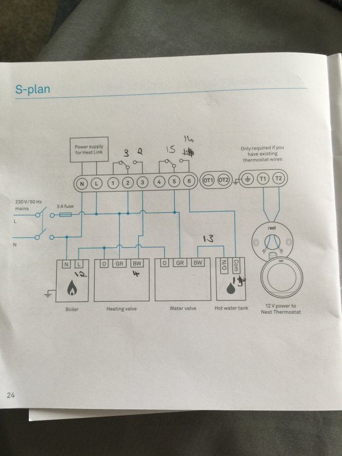

I've attached a screenshot of the wiring diagram for the "S-plan" setup that I've been following in the Nests instructions manual.

Yes the wiring is exactly the same as that diagram.
I've removed the Thermostat cabling and re-used this for the 12v feed from the T1 and T2 from the heat link.
To give the Nest heat link it's 240v I have used the feed from the programmer (worked with L in 9 (Htg on) with the programmer setting for heating switched on.
I have the 2 and 3 from the Nest heatlink in the respective terminals 2 and 3 marked CALL and COM on the wiring diagram, the heating works fine.
So now I just have to remove the cable going into HTG ON in terminal 9 and put the cable coming from the "CALL" which is terminal 5 on the heat link? Where would the COM (port 6 on the heat link) go then?

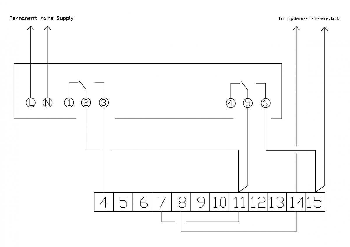

Here's a sketch for you. The motorised valves aren't shown for clarity, but they will be as per your photo. (4, 6 and 7 for heating) (8, 6 and 7 for water) Programmer wiring to be removed, because the Nest takes care of that function.
This assumes that terminal 11 marked 'L' is connected to a permanent live.

If you have a permanant live at terminal 11 in the wiring centre
This is the easiest way, that still allows all the wiring labels in the lid of the wiring centre to be correct (as the heatlink is only replacing the the programmer (from a wiring point of view)):
Put the wiring and links back to how it was before
Disconnect the wiring to the old programmer from the wiring centre
2 and 5 from heatlink to 11 (Permanent live) in wiring centre
3 from heat link to 9 (Heating on) on wiring centre
6 from heatlink to 10 (hot water on) on wiring centre
4 from heatlink to 8 (hot water off) on wiring centre
Disconnect room stat from wiring centre and use for T1,T2 (as you have already done)
Fit a link between 2 and 3 on wiring centre.
Stems diagram above is correct for an S plan system (which has 2 2port valves)
In a Y plan system (with a 3 port mid-position valve) the link from 11 to 7 in the diagram above will send a permanent live to the hot water off connection on the mid position valve, so hot water would never be available.
