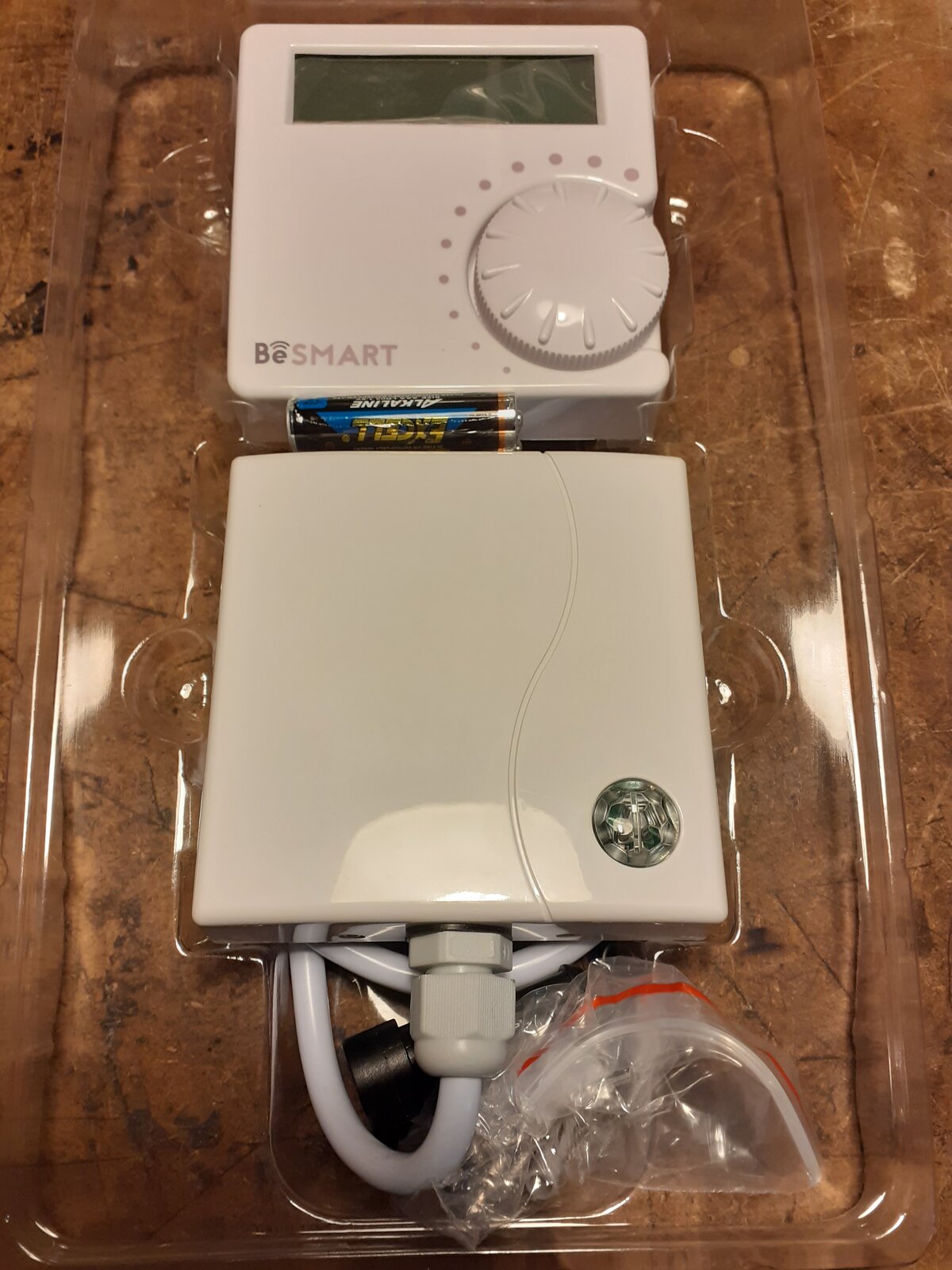

Thanks, this is what's coming with boiler

Ok, you have the programmable version. You have two ways to go
Set boiler clock to 24 hrs and use the 1 hour timings on the room stat.
Set the room stat timings to 24 hours and use the boiler clock.
Your installer will know what I mean
"Set boiler clock to 24 hrs and use the 1 hour timings on the room stat" eg: always on?
Yes, otherwise you'll have two time schedules. Cut off plug. Red and black into the black link in the boiler contr box. Brown and blue to power terminals.
Thanks very much, i watched a few YouTube videos last night.I didn't realise how much was possible using open therm configuration, I've got the installer to wire it up that way.
