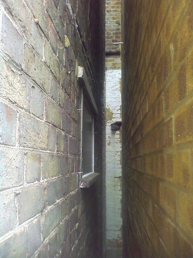

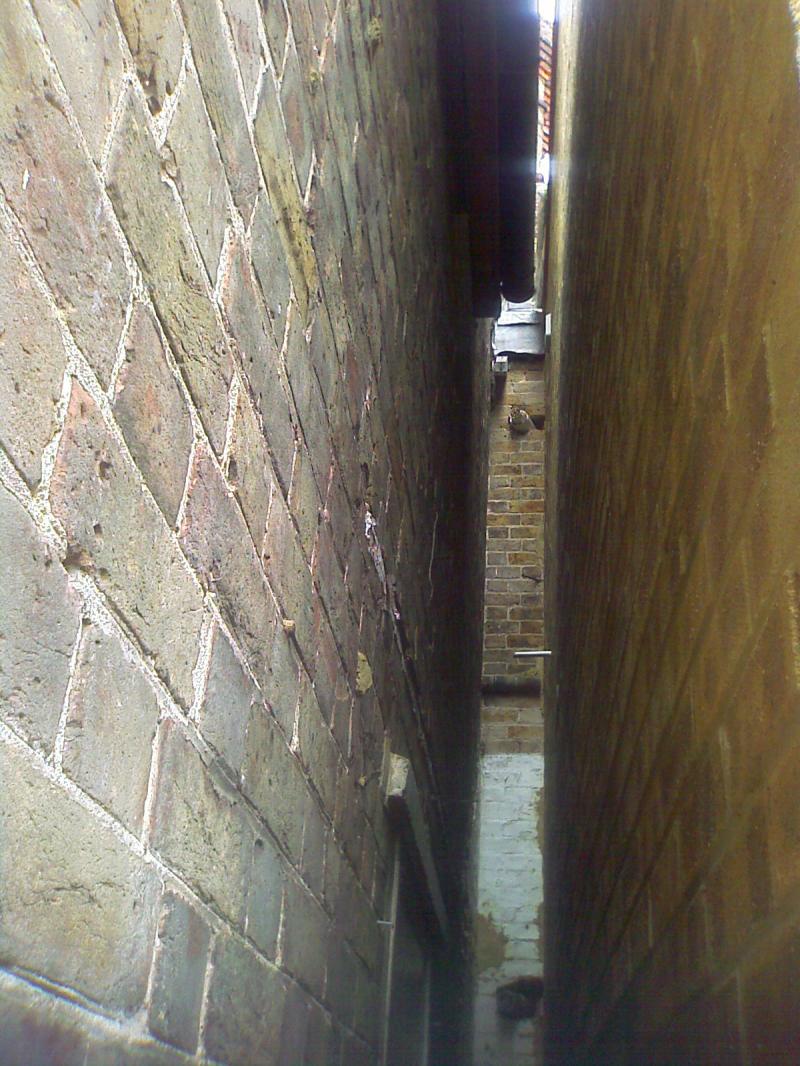

Below are photographs of a couple of independents installations, did anyone take notice? No! Does that make all independents bad? No.

Yes the boiler is working, but that is not the point. It was installed in a wilfully negligent fashion by a person who is meant to know better. From reading the correct procedure or accepted standards of system cleanliness, I can say with pretty much certainty that the warranty on the boiler is null and void. If you went in for a hospital for a removal of an appendix and the surgeon couldn't be arsed and decided to remove your whole large instestine as it would save him time or money, you'd be the first one running to the medical negligence solictors.
Pictures as requested. The work looks like OK to me for a lay person and frankly I am not bothered by the neatness or the lack thereof - I just want it to work and keep on working. As you can see, no stickers anywhere. Oh ...just noticed ..looks like a screw is missing from the right hand side as well!
Ok ... drain a bit of water out of the drain cock into a jam jar and then top the pressure back up ........ take a pic of the water and post it and then let us all try and guess if its been done correctly
As I have said ... we where not there ... yes the pipework is not very neat but its been crossbonded which is more tham most idependant installs that I see
