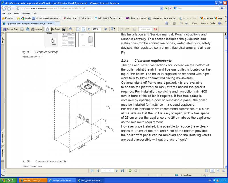

I prefer to fit Remeha Avanta combis. Not only are they reliable and very quiet, but compacts as well. When you say you are after a boiler less than 700mm height, have you allowed extra for the flue and pipes underneath, plus access room for fitting and maintenance?
The Avanta is 670mm high, and only needs 5mm clearence either side. See photo for clearnces required.

If I allow for approx 200mm under the boiler, and around 200mm above so 700+200+200=1100....
Should just be OK. Worst comes to worst I can always bring the back wall where the boiler is going further forward which will gain extra height from the pitch of the stairs.

There does not seem to be a reason why the boiler should not be moved towards the left to increase the available headroom.
Furthermore, the 200 mm above clearance only needs to apply to the center part where the flue exits.

Your diagram shows 1070 height, but what are the measurements across?
From the diagram in my previous post, you may notice that the flue on the Remeha is slightly left-of-centre. Sometimes it works in your favour with these boilers, sometimes it doesn't, depending on the location.
the width is not a problem, according to the diagram you posted, those dimensions are perfect. Going to look into them, thanks!
