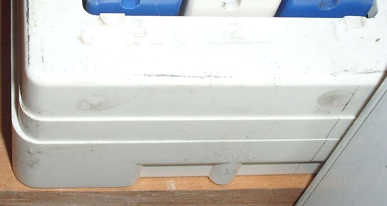

I didn't think they were cut-outs, I thought they were dirty marks.
However, I think the wooden bases may have been noticeably larger than the plastic fronts - so I am now leaning towards it being all plastic...
The bases are bigger than the front, the wooden are bigger than the pastic versions.
There were different versions of the plastic base, either a light brown colour or cream /dark brown to match the front and different mouldings over the years.
Those are knockouts

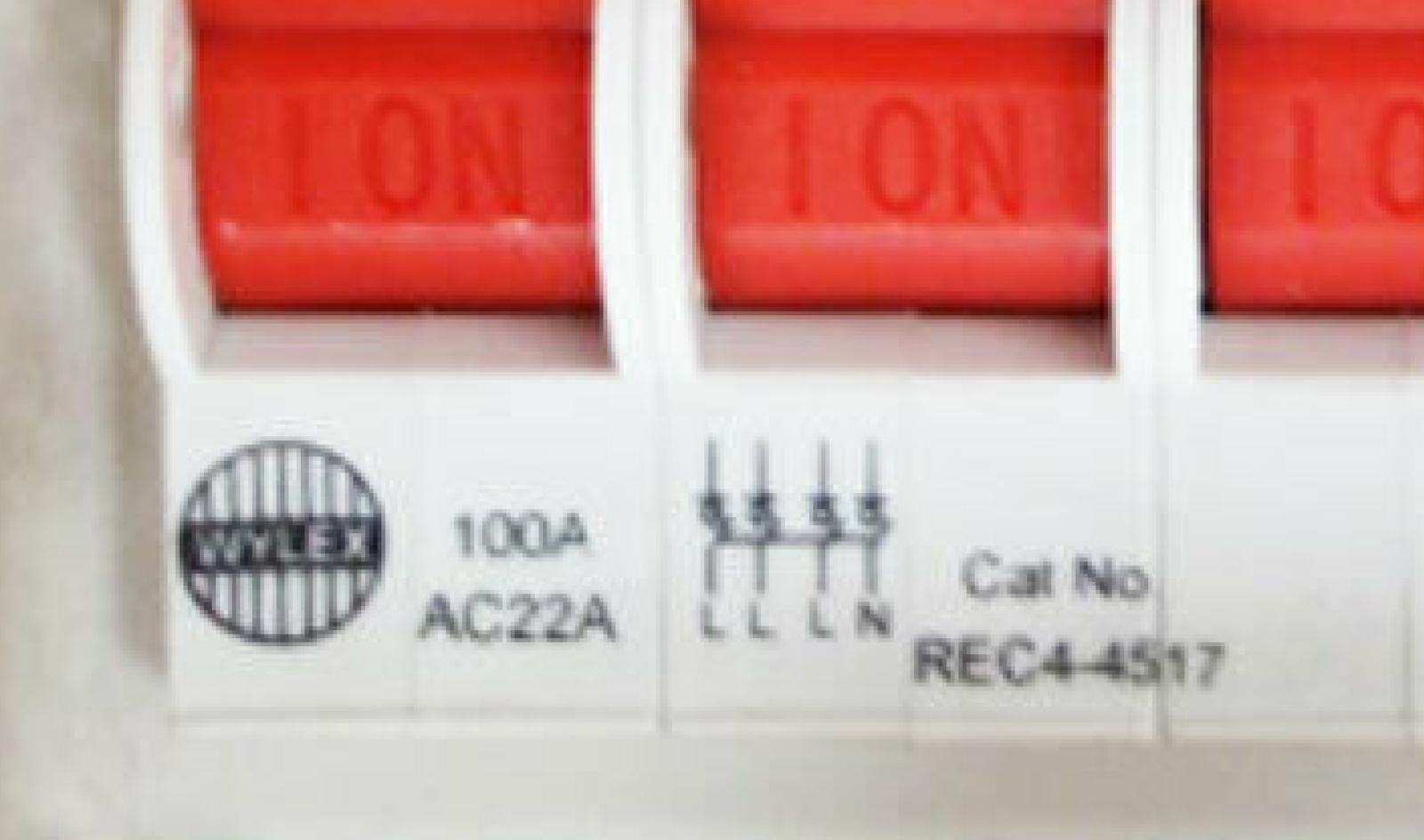

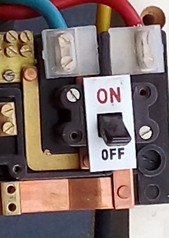

Hope the consumer unit polarity is OK as the Live from the meter is connected to the Neutral side of the isolator.
if it's any help the neutral terminal is on the left, so it should be fine as long as the tails don't crossover inside the fuse box.
None the less, a strange thing to do and what about anyone who might follow, assuming the markings on the isolator are correct with the cables?
Yes I agree it is strange, however I understand how, IME a majority of devices are neutral on the right and if not marked that's in all probability how I'd wire it.
HOWEVER let's look at this more sensibly and make the statement that the neutral should be on the right, especially if the isolator were mounted the right way up. :oops::whistle:
The Feed to the isolator should enter at the top shouldn't it.
Indeed - but, as Sunray implied, only if it's mounted the correct way up! You can see that from the fact that the load side (should be at bottom, but is at top for the OP) has a removable cover to get at the connections, whereas the supply side doesn't.
One can see why ('convenience'-wise) they mounted it upside down, but the main problem with doing that is that it means than "down is ON".

I agree it should be the right way up, but why is it incorrect for the isolator to up off? (Generally, not just this situation). How would one know which bit moved and which bit doesn't?
I found this on t'internet:
Does this imply the feed goes in the bottom?
I would say no.
If they had put LLLN on the top as well, someone would ask why and say what else could it be?
