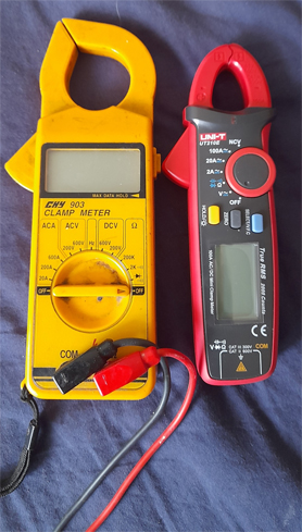

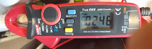

But the correct method is to measure first, a meter like this Testing voltage.jpg around the meter tails will tell you total back ground leakage, the limit for a 30 mA RCD is 9 mA, but in real terms you want it down to half that. With an up and running system it is so easy to measure, with a dead system we use an insulation tester, VC60B.jpgthese are not as good, as they use DC to test, and with AC we get inductive and capacitive linking, so there is always some leakage which will not show up when testing with DC, but until either of these meters are used, it is simply guess work.

I agree with @flameport although where the wiring looks to be sound, I can also to some extent when an all RCBO board is fitted understand why one takes a chance. The clamp on meter does mean one has a reasonably good idea of overall leakage before one starts, however for many years my clamp on measured in 10 mA increments the yellow one of the pair shown, Clamp-meter-small.jpg until I got the smaller red one, which will measure in 1 mA increments, it will also measure DC to ensure the 6 mA permitted with a type A RCD is not exceeded, but in real terms due to the way field effect meters need to be zeroed in real terms this is a bit hit and miss.
However I can also see @Murdochcat point, if fitting all RCBO then there is little one can do to reduce earth leakage, the testing is essential when grouping circuits to ensure one circuit is not going to cause others to trip, so before fitting a duel RCD board yes essential, but with an all RCBO board there is little one can do anyway.

I am not against using a clamp meter they can be quite a useful aid, however a 1mA resolution does not imply 1mA accuracy I`m afraid, still cvarry out appropriate tests with appropriate test gear as per C & G 2391 etc.
