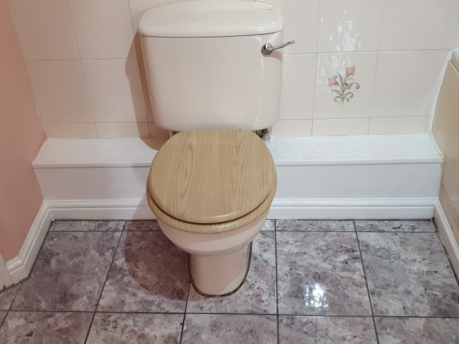

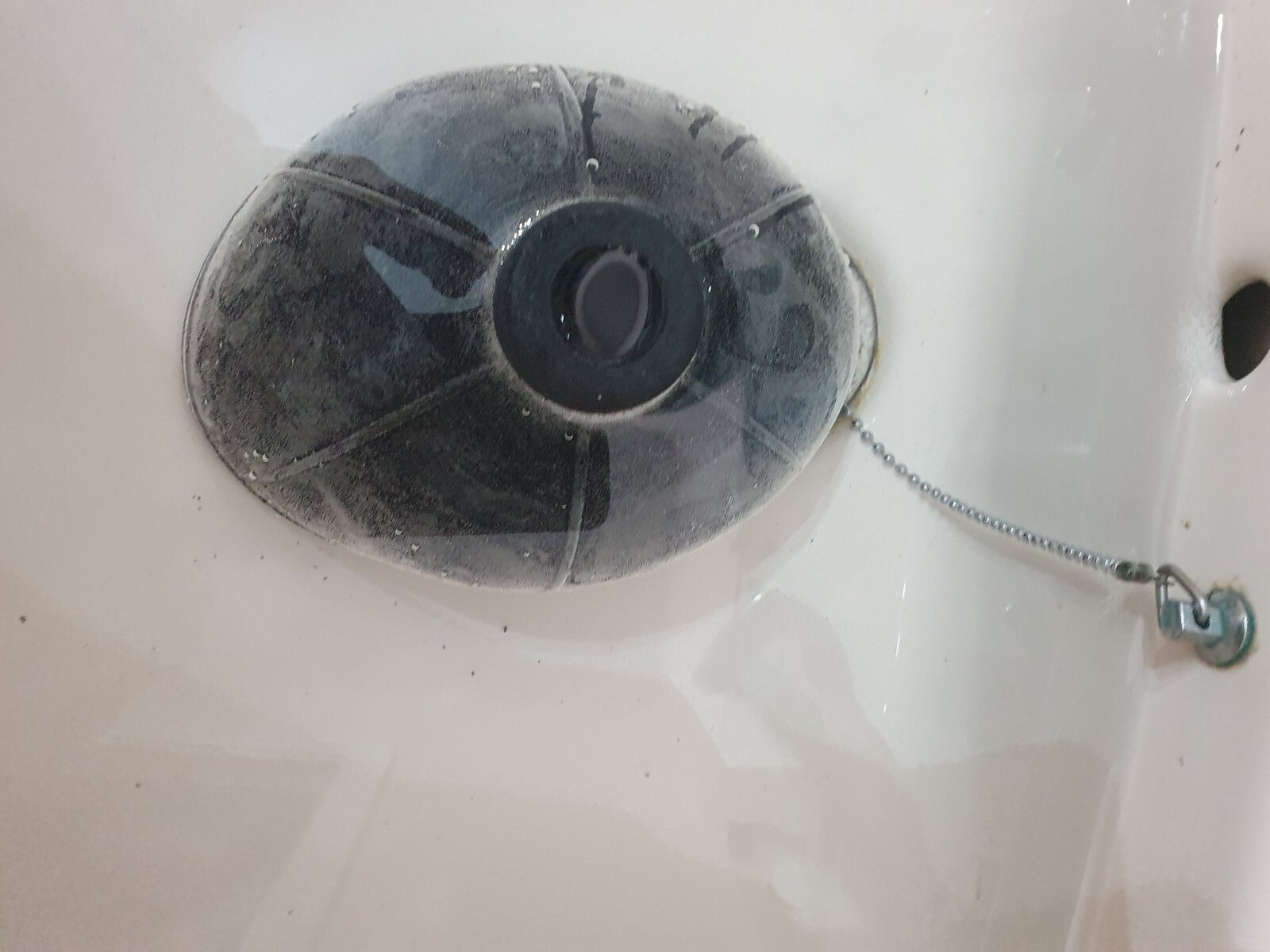

Hello guys the house im private renting in has toilet draining problems, it has been fine for over a year so far. I bought a new £10 flange plunger from Amazon, its useless as its out of shape and it wont get a seal. It wont reshape even when i bathe it in warm water.

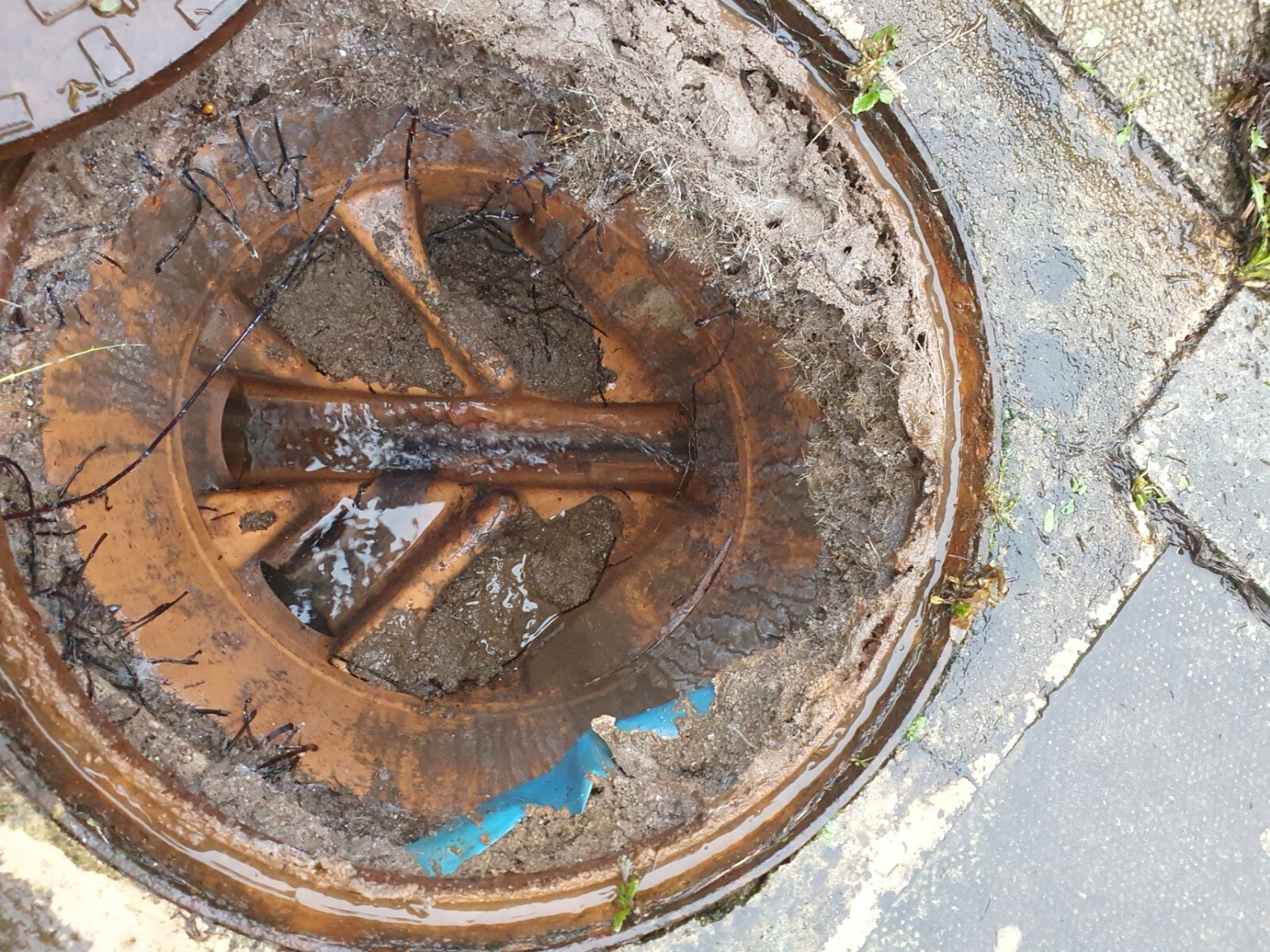

I have severe IBS and i use baby wipes all the time. The baby wipes dont seem to be the problem and the manhole in my back garden seems fine and does not flood.
Sometimes i have chronic diarrhea and sometimes i do very large poohs. Quite often it takes a few attempts to clear the poohs when flushing. Recently it has started leaving poohs at the bottom of the bowl. It does flush and drain slowly, it just struggles to remove my poohs. I get the impression the bend is partially blocked.
am i on the right path regarding this type of plunger? See pics of the manhole and rubber plunger in the warm water its like a rugby ball.

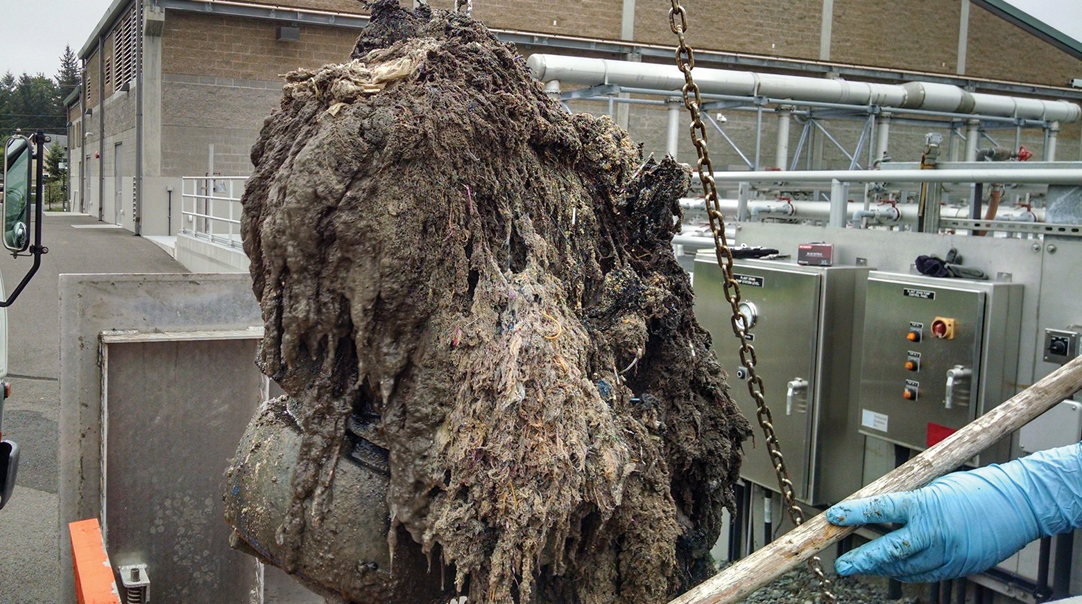

If you must use wipes, put them in the Bin. They cause utter havoc in the drainage system, cost a Fortune to keep removing and when they do eventually find their way through the treatment works, are screened out on arrival and put in a Bin. Which goes straight to landfill/Incineration.
Cut the middle man out, and help save the rest of us a few £.
Yes, there is a Pump under that lot.

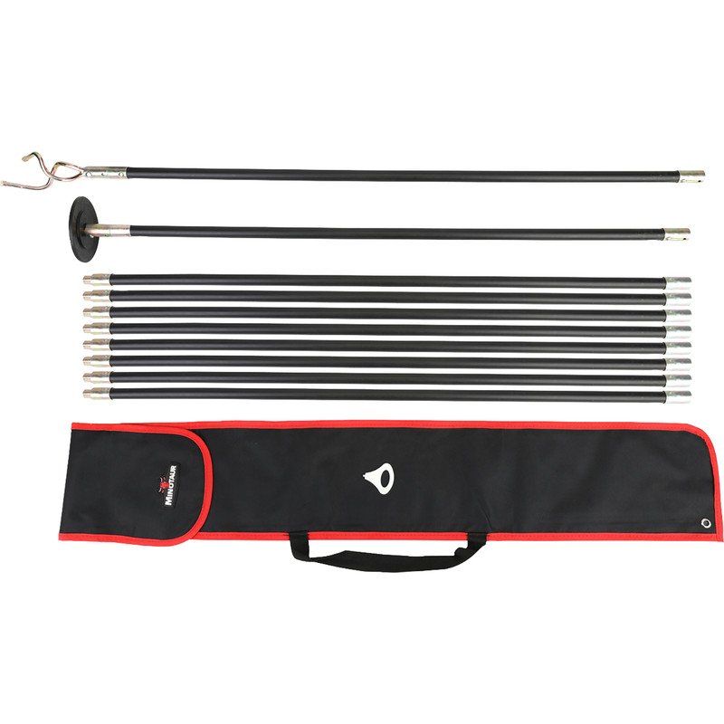

Go to Screwfix/Toolstation/wherever, get a decent Plunger. A Drain Rod with 4" Plunger on the end has never failed me yet to clear a blocked WC Pan, £30 on a set of Rods will still be cheaper than getting someone in and you've got them for the next time you drop a baby's arm off.
Many thanks for your reply. What about this set from Toolstation £32 ?
So do you recommend doing this from the actual toilet and not the manhole?
