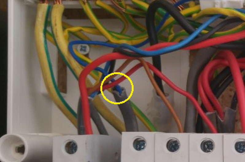

Correct - i think these are for a dissused alarm system I'll try disconnect them tonight.
If not used then you could leave them there.
Or should I move the oven to the other N bar?

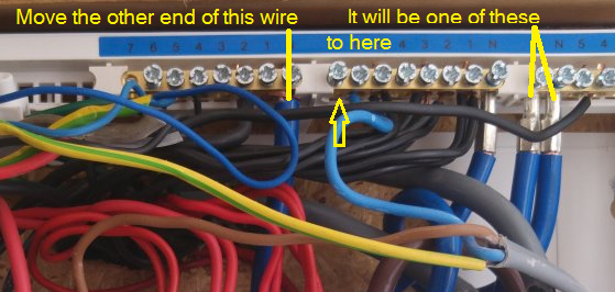

You could do that -
OR
If you feel comfortable doing it, all that needs to be done is:
That is - connect the left N bar to the middle N bar instead of the right N bar.
That is the only fault.

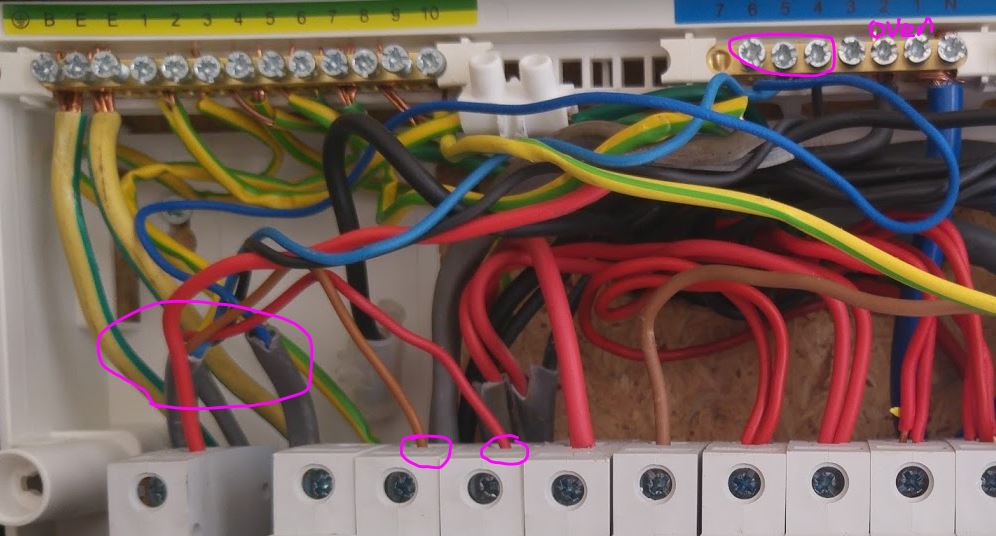

I've noticed something else;
Please excuse my shoddy drawing - The big pink circle to the left is everything connected to the N bar in question plus the oven (I believe to be the alarm or something else not in use as i can't trace it) BUT as you can see theres 3 neutrals connected and only 2 Lives, WTF? Theres a brown live missing!
The original borrowed neutral?
It may be worth disconnecting it from the neutral bar and and seeing
1. if the oven now works
2. is anything else has stopped working.
but this is all guesstimation stuff and not a recommended way to fault find electrical problems.
it really needs an experienced head on site.
