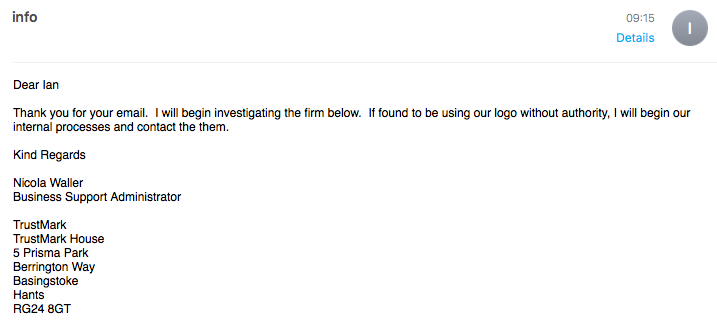

M, bet you regret replacing that original CU. Did decide not to report your fraudulent spark?
