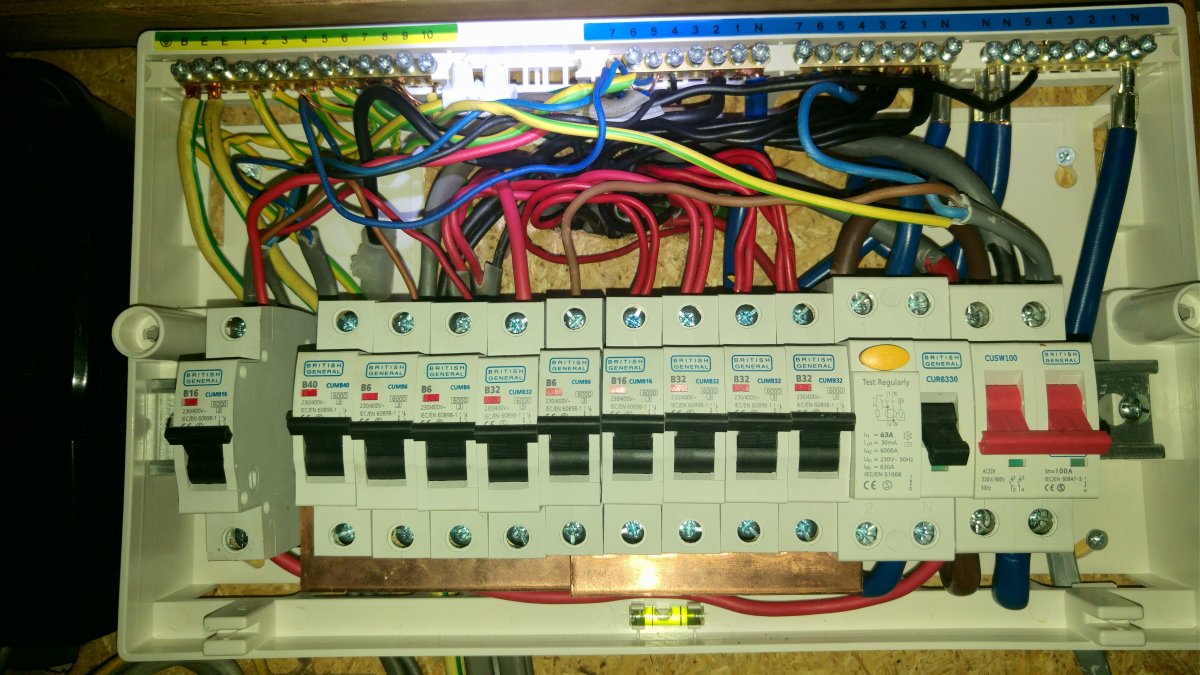

If you feel comfortable doing it, all that needs to be done is:
That is - connect the left N bar to the middle N bar instead of the right N bar.
That is the only fault.

Thank you so much @EFLImpudence you were spot on, I connected the Left N bar to the middle N Bar and hey presto all working! Thank you so much, please PM me your email I have a small token of my appreciation for you! :)

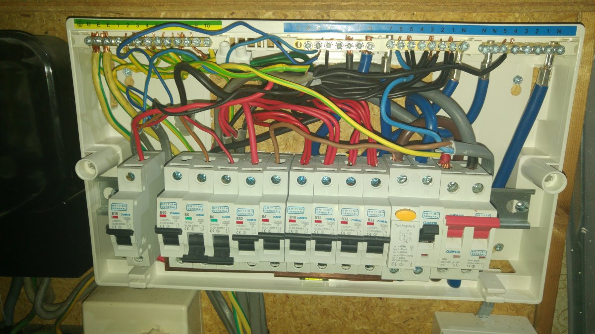

Heres the photos if anyone is interested in his handy work;
BEFORE connecting Left N bar to Middle N bar;
AFTER connecting Left N bar to Middle N Bar

The issue I have with it now is all (bar the boiler neutral) current is going through the blue wire which appears to be smaller than the one between the main switch and left hand rail, is it adequately rated?
If I understand, the main neutral conductor does look bigger than the others but then it is also considerably bigger than the incoming tails so I don't think it is anything to worry about.
The RCD is only rated at 63A.
It would appear that, because of the initial fault and as the busbar has been cut and then used for all (except one) MCBs, a second RCD has been removed to enable fitting of a separate MCB for the boiler.
