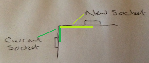

New spur socket
but the original one is wrong.
Winston1 Please explain why this is wrong, I have added the safe zone for existing socket in green and the safe zone for the new socket in yellow. Look they meet at the corner. Therefor the cable is in a safe zone even though it ( the cable ) goes round the corner
I think that the OP’s drawing may not show the whole picture, as there are two separate rooms. But even so, as I outlined, the cables in both rooms are Ok.

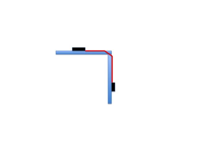

My interpretation of OP and the proposed cabling route:
or possibly like this
I don't think there is much dispute about it being incorrect/undesirable.
EFLImpudence, Saturday at 12:40 PM You would need to chase the wall on the existing socket side until you get to the corner in the new socket room.
winston1, Saturday at 2:31 PM And as I said safe zones don’t go round corners.
scousespark, Saturday at 4:21 PM Yes they do when you have fittings on both walls and they are in line.
winston1, Yesterday at 3:19 AM Which is not the case here.
Which was posted some 9 hours after this
Taylortwocities, Saturday at 5:49 PM Think the other way round.
Run cable horizontal from existing socket to wall corner. That is in zone.
Drill through corner into room two. Run cable horizontal from corner to new socket. That's in zones too.

My apologies for adding sketches of my interpretation of EFL's and Taylors proposal within their posts.
EDIT: especially if I have misunderstood their idea.
Do you know the thickness off the walls? Greater or less than 100mm. It appears to be important.

I think you missed my cunning plan. It goes like this
All cabling horizontal from existing and new sockets. Compliant.
PS, it might be helpful if the OP can find another envelope and draw a better plan of where the walls actually are!

I confess I struggled to work out the drilling action without another wall element but this is something I do to keep cabling away from corner vulnerability. It didn't occur to me others do it too.
Sadly the OP will have been frightened away by Winstons negativity ages ago.
I don't think you need an angle. I don't have a drawing app, but you could chase into the corner. Continue for a couple of centimetres before drilling straight through. Chase from the hole to create the zone in the second room. I've done this when there is a concrete floor. I suppose Winston would break out the Kango.
