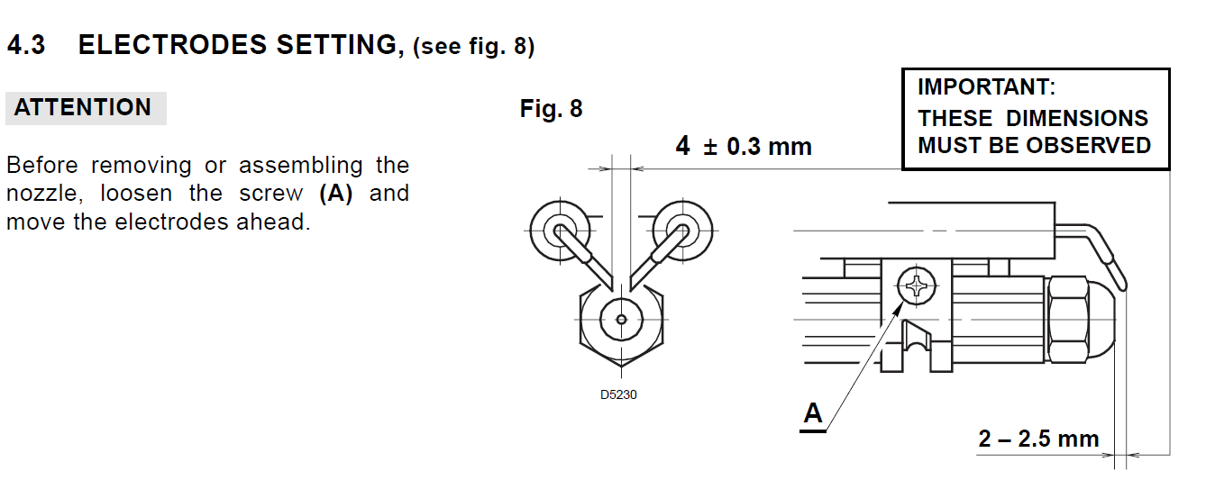

Unusual combustion noises on start up are often due to the electrode position, I’ve found......once set correctly they hardly ever change.
There’s plenty of info available on these, but generally the gap is around 2.5mm and the spark occurs just behind the nozzle - the spark being blown into the flame by the fan.
A faulty nozzle can also give a poor oil spray, of course!

Surprising the engineer didn't check the pump pressure at least.
These are the settings for my 18 year old Firebird 90s fitted with a Riello G5X burner jetted for 20kw output, I've never had to adjust the electrode gap, it has stayed at exactly 4.2MM. I just remove the flame tube and give the electrodes a wipe down every year.
