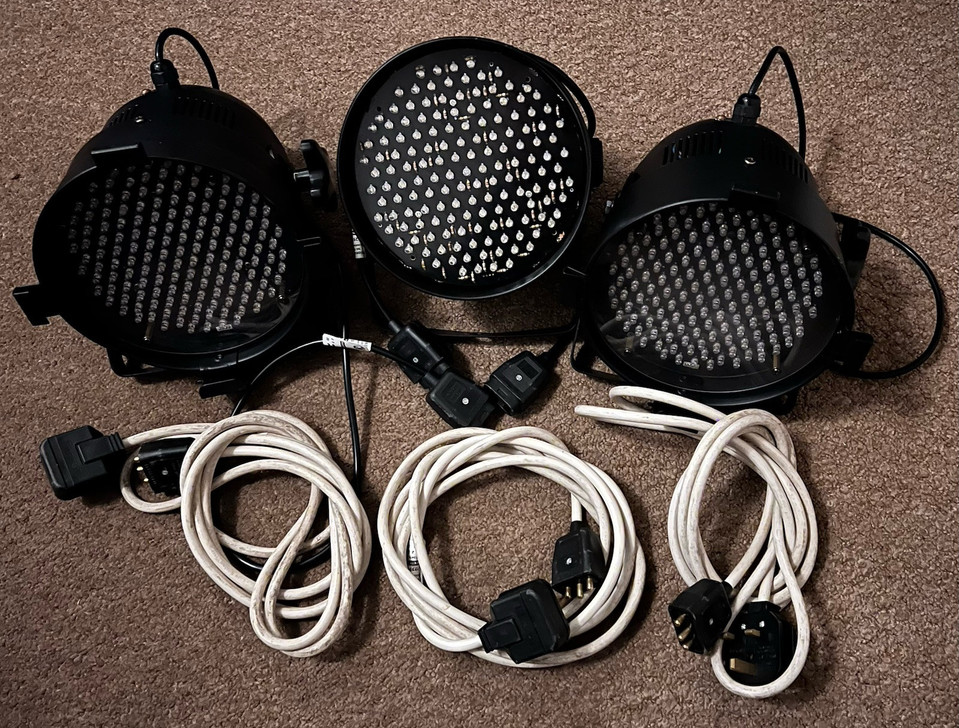

Been a few on here too, I had one a short while ago where the pair of connectors were purchased from a 'shed' and assembled incorrectly, I was amazed how they jumped into action and checked their total stock across the country.

One has to wonder how this can happen. It's not as if it could have been done deliberately for some (cost-saving or whatever) reasons - it would have been just as easy to do it correctly. It seems simply that no-one involved in the manufacture 'had a clue'!
I have no idea but the fact that all 3 are the same, someone obviously thought it was correct.
Clearly someone that has not got a dicky bird as to how electrical things work.
I know, lets all report it, might help get it removed quicker :)
I presume the light comes from the factory with a short flex and either no plug or a foreign plug. I googled what I could read of the label and found what appears to be the same light with a moulded schuko plug https://www.stagelamps.co.uk/store/led-par56-short-black. If quizzed about the plugs and sockets safety regulations the distributors will probably say the lights are "not intended for domestic use".
The customer then fits a plug or connector to suit their setup. In larger orgs this will be done by someone who hopefully has some level of electrical training, but there are lots of small bands, magicians, DJs and so-on out there who aren't going to have any specific electrical staff.
Why use the connectors backwards? maybe it was ignorance, maybe it was a deliberate ploy to stop people taking the leads. I have certainly got the impression that there are some in the entertainment industry with a somewhat cavalier attitude to electrical safety.
I presume the light comes from the factory with a short flex and either no plug or a foreign plug. .... The customer then fits a plug or connector to suit their setup.
Yes, I imagine that's the most likely scenario.
All true. However, I would suspect that a significant proportion of sane people with no electrical training would probably see that there was a danger in doing it as it was done!
Yes, both are possible.
Well I'll say all showtec products are available with moulded 13A plugs, however Thomann in Germany are always a good price... It would have been easier to purchase shuko extension leads at the same time and replace with a 13A plug:D;)
