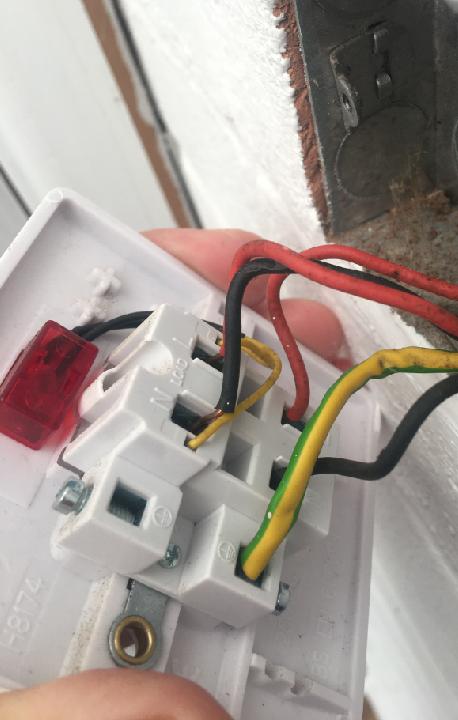

I have a on / off switch with Neon on my wall outside the bathroom. Neon is there to remind people light is on etc in the bathroom.
The Neon has now stopped working so i need to replace it.
i would have bought it at Toolstation or Screwfix so looking at their web page there i see various types.
My question is So i get to correct one so i can just swap it over are they wired the same ?

Its on /off like a normal light switch BUT the neon is there just for visual to remind light is on when door shut
If i go buy the screwfix 43131 i should be able to wire it up with what i have for it to do the same job ?

So looking at the terminals on the item you advise does that look ok for me.
I have 2 Red 2 Black 1 Earth
These go into N & L & earth in its place.
Looking at the one you advise i see IN & OUT so as long as i fit N & L in correct holes the only thing that could be wrong with regards In / OUT is the light will come on when switch is in off position.
Is that correct
If you put the feed into the load terminals, then the LED will be on 24/7, but the light will still come on when the switch is closed.

i think i see load written on the photo
so you may have supply on the other side , cant see from photo
so supply is IN and Load is out , and the neon is wired across the load

I'm fairly sure I can see an embossed "load" on your old switch indicating the output connections.
You can also tell which are the output connections from where the wires from the neon are connected to.
