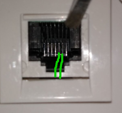

The left socket has failed. I've swapped cables, tried different cables, but that one just won't work.
Looks OK inside, as in no loose cables. Do these things just fail sometimes? I'll check the cable in the loft, but that should not have been affected. Hopefully the cable is ok!
Can anybody spot anything odd?
Has that socket ever worked? Did you test it when you put it in? They are rated for a finite number of insertions/removals so failure is possible
Using a torch have a look at the contacts behind the shutter, sometimes one or two get bent
Yeah, it was working, although once before it stopped after it was disturbed with a vacuum cleaner, but started working again. Today i moved the cabinet out the way and knocked it again, not worked since.

These 2 definitely look suspect. Maybe try some tweezers to pull it back into place. As crystal ball said, you are missing a pin, and do need all 8 for gigabit speeds. Needs replacing really. Krone tools are only a quid with a 3 month wait from ebay, or i'll post you mine. No use to me any more.
Looking carefully at the wiring for the one on the right when looking at the wires, something appears amiss with the brown/stripe? looks like its with the brown and the pull cord is in the place of brown stripe?
Suggest you get an Ethernet tester - saves loads of time as means you know which wire is at fault.

I see what you mean. Will have a fiddle. I think the brown/stripe is just bent around out of shot. It was working fine when first installed.

I saw that but when I tried zooming in I convinced myself it's an illusion. Now I'm not so sure.
Well, might be the cable! Electrician replaced the socket that was not working, and still no joy, then swapped the cables over, and nothing again.
Checked the cable in the loft, no sign of damage, but it was a bit twisted in places and is running right alongside mains in places.
Next step is to replace the whole cable! Although might be worth checking the socket at the lounge end first.
THis was only looked at after the main electrical job today, he's going to quote me to replace cable.
Yes very common for them to fail especially if they are a cheap or unbranded RJ45 socket module, it's almost always an issue with the pins. Over time with something plugged in the pins loose their springy-ness, it'll work fine until it's disturbed or you disconnect the cable and connect something else, the pins now sitting higher than they should don't quote make a good enough contact. You might be able to bend them back but I'd save yourself the hassle and just get a new module.
