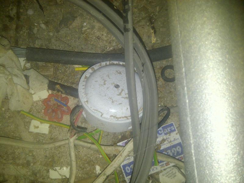

Well it looks like I may have been running on a ring with a loose connection for a while. And a 2nd fault has caused a complete break in the ring. The electrician was able to locate the section and I remembered a screw down junction box under the floor (near the CU). So floor up, screw tightened and problem solved. I found another 2 junction boxes in the same floor space - 1 which needed tightening (hopefully the 1st fault). Electrician coming back to take some reading on the ring. Thanks

That proves the requirement for junction boxes to be accessible!
As you have found out, quite often, the JB has been hidden under the floor for a decade or two (or buried in the wall :evil: ) and nobody knows it is there.

What's the story with that armoured cable above the JB? I can see the steel armour, I hope there aren't bare conductors coming out of the end :?: :confused:
That's an old armored cable (replaced when extension went in)
Electrician came back to test, still had a neutral fault between last socket and CU. He worked out which wire it was on. Wire disconnected, now converted to a radial and downgraded MCB from 32 to 20.
He said that was best.
Best option if you don't want the hassle of replacing the damaged leg. Not necessarily the BEST solution but not the worst.
