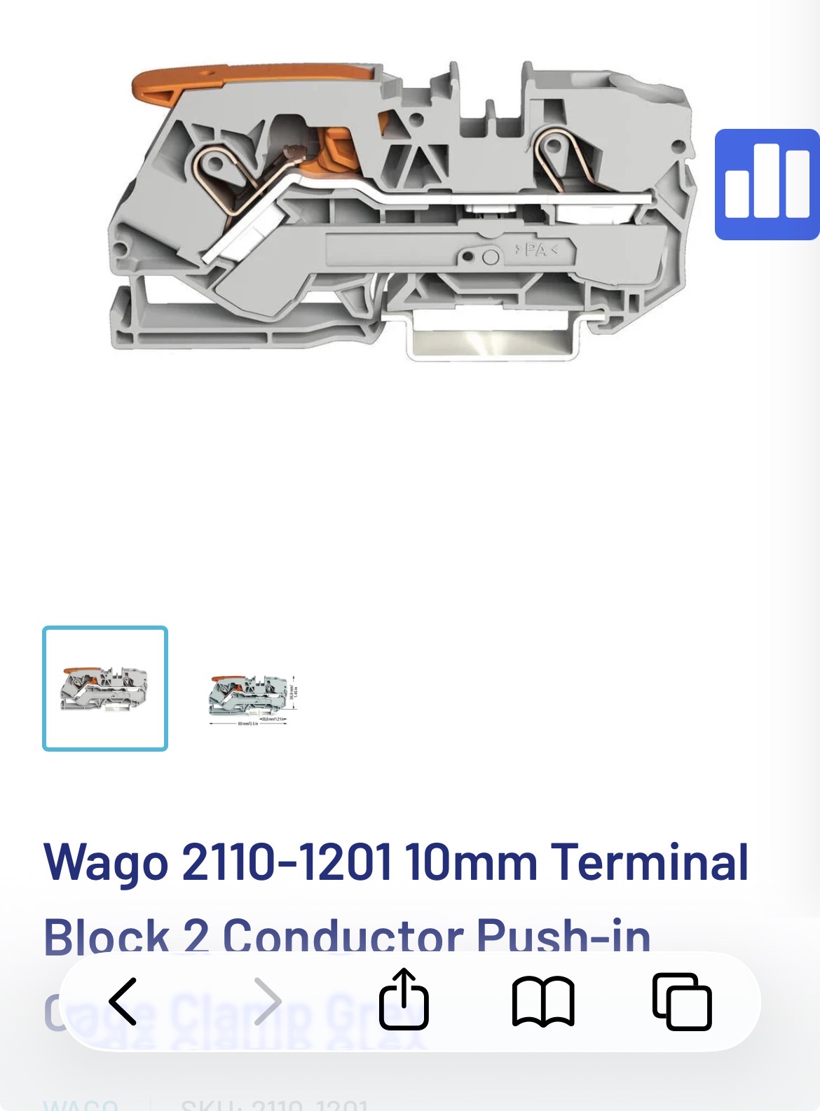

I was going to use one of them wagobox 32amp connectors,
Well if it fits into the standard cooker calc by load and you are sure that the connectors will fit and carry the max current (depending on hob power rating which you haven`t mentioned yet) the it will do.

You will need an wagoXL box and I don't think any wagos go upto 10mm....could be wrong.
That’s thd practical problem with using Wago here. You won’t get a 10mm conductor in!
Wago do make a 10mm connector, the 2110 but that’s a DIN rail mounted jobby.
Dual appliance connector plate is the solution. Assuming it will be accessible…
