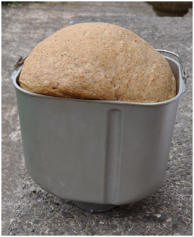

Baked this morning in the SD253 mentioned above.

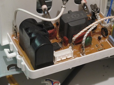

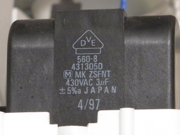

My sb200 has a different sort of capacitor...

Rinsola,
To answer your two posts:
1) What difference would a 2uF or 4uF capacitor make instead of a 3uF.
PROBABLY noting, BUT the circuit will be designed for a 3uF so there may be some reduction in power of motor and hence might not be as perfect as you want.
If you do go for your local shop capacitor go for the 4uF >>>> but its is more important than the uF rating to check that it is the correct voltage rating. IT MUST MUST be greater than 400Volts.
The capacitor your local shop has should also be about the same size as the one your are removing. If it is much smaller is not suitable as you need a '3uF motor start run capacitor 450V'.
2) Looking at the photo of your old capacitor I would expect that that is simply a plastic cover over the capacitor which will be the normal small coke-can shape. However the cover is likely to be permanently fixed to the Capacitor, but you could give it a pull and see if it comes off.
So replacing with a different shape will not be an issue (but as said before should be about same size and I think Coke-can shaped).
Look under the Capacitor on the other side of the circuit board and see if there are two solder spots where it is soldered on.

Thanks SFK. What you've said about the capacitor conforms to what I was told by a friend who knows about electronics. In fact today he removed capacitor and tested it and it read 2.88 which is not far off 3. Never the less, all the symptoms I've experienced conform to those referred to on this thread. This friend gets electronic parts regularly from the US and will get a new capacitor with his next order, so we'll see how it goes...
