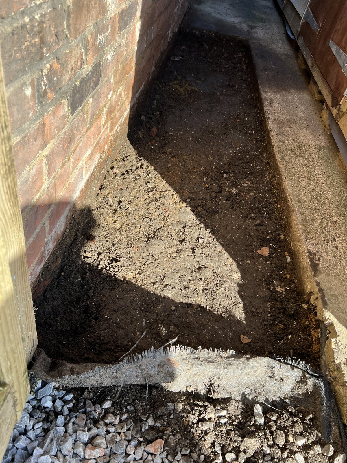

I’ve got some spare paving slabs that I’d like to lay on this space. I would like to use sand and cement to level them with the existing concrete.
I was unsure on how I need to prep this ground so that the slabs don’t sink, etc.
I also have a grinder and can cut the slabs to size.
Thanks in advance.

Id just scrape off 100mm of soil. Gravel to level and sharp sand and cement.

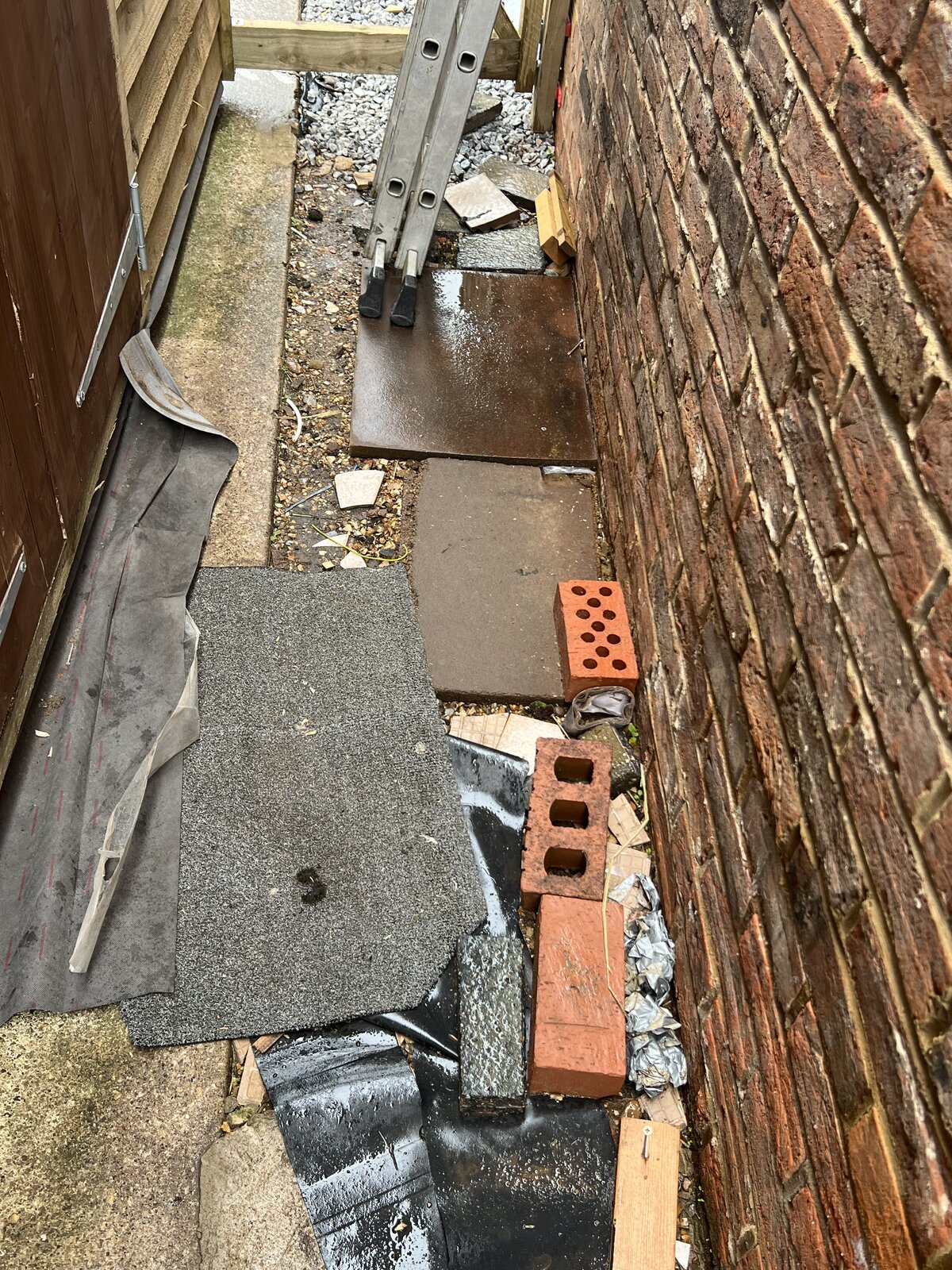

I’ve dug this up and was wondering whether I can pour some shingle, compact it, pour some MOT and compact and finally use a mortar mix to set the paving slabs.

You can set them up on an aluminum subframe if you're feeling flush. Provides good drainage.
500kg of Type 1 will give 100mm sub-base. 200kg of Sharp Sand and 3-4 bags of cement should give a good strong mix at 50mm depth.
