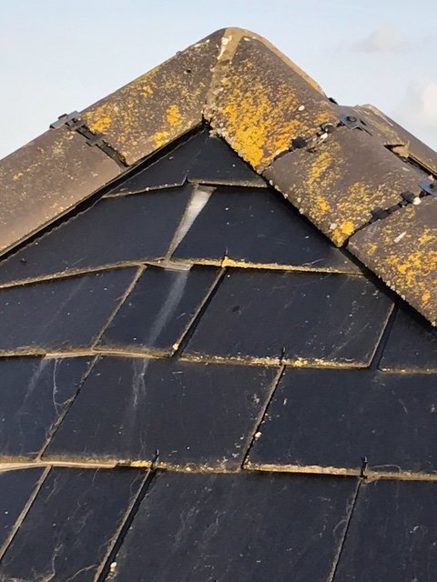

The render and ground levels were suppose to be completed within 3 months of the report which was Feb 2018 and they only started beginning of October 2019, some 20 months later. What's the point giving them a 3 month deadline when nothing happens when they ignore it. The roof repair that was finished roughly September 2018, I've been up to take a look. The mortar between the coping stones that were re layed is cracking down the sides, some I can see daylight through.

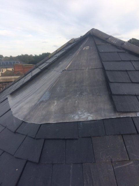

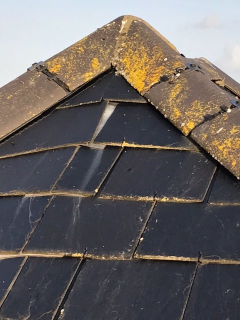

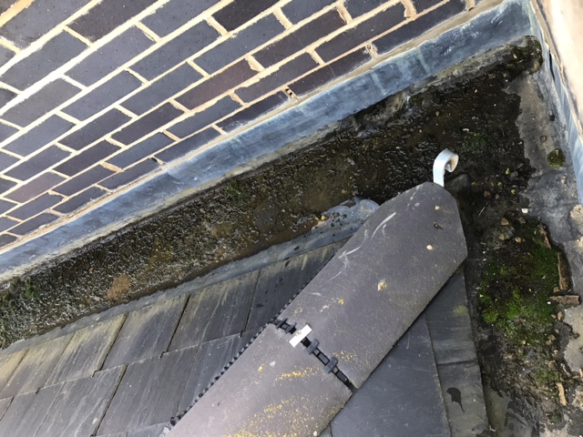

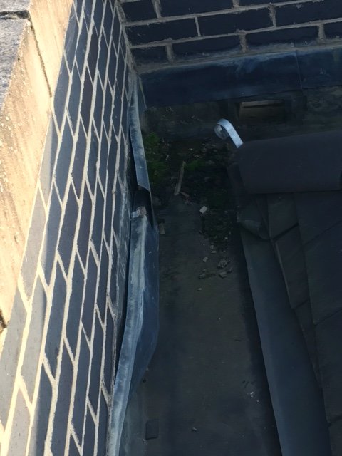

Roof leaked first day of moving in. Site manager lied saying they had just renewed the lead and that's how rain got in. I believed him. Few moths later rain coming in house via roof in bathroom, same place as first leak and back bedroom.

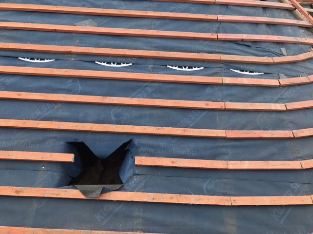

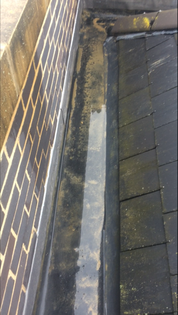

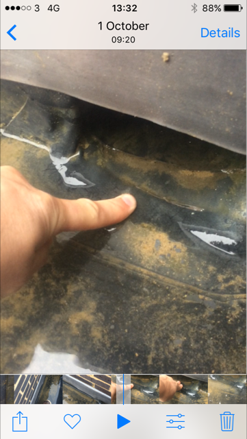

Roofing company came out, said pent roof built wrong etc. the roof has a flat 1 foot approx walk way round the base of the tiled roof part. The developer lied about this too, said the tiled roof went straight down to gulley, no flat part. The roofer replaced all the tiles and batons, you can see the whole in roof where whoever built the house never put a vent, just tiled over the hole etc. The roofers said the roof was sorted. No one from developer came to check. This repair took about 2 1/2 months. I climbed up scaffolding to check it. It had broken and missing tiles, the flat part of roof was lower than the exit point for the downpipes, so any water just pooled up until it rained enough for it to spill over the lip.
Developer said this was not a fault, that it was built to specification. I took videos and pictures and put it to LABC who said it was a build defect, hence the second roof repair. Second roofing company ripped everything off the first one did and re did it all saying first company did a bad job.

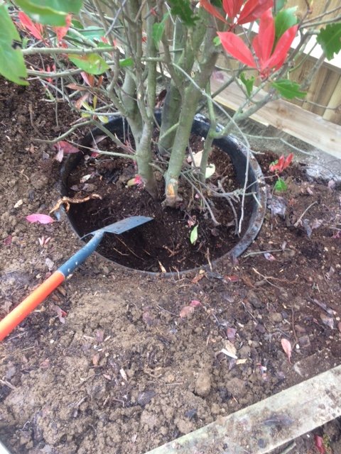

They left dying trees in giant submerged pots in the garden that I had to dig out.

Here's the lead the site manager said they renewed. They took the tiles off this part of roof and replaced with lead saying it's built wrong and the tiles won't fit so it has to be lead.

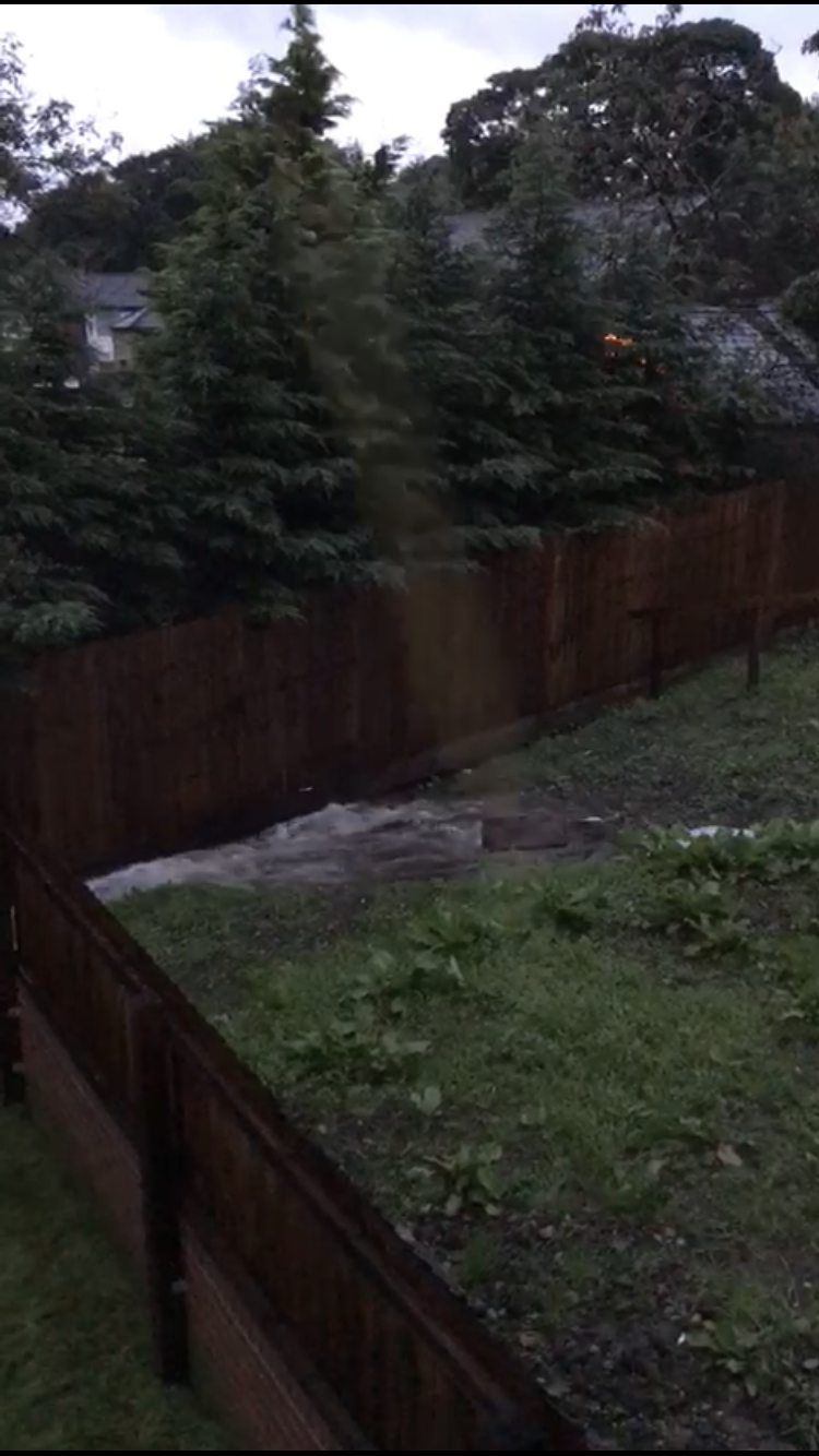

While the last roof repair was In progress it rained one Sunday afternoon really heavy. Luckily I was home. Water started pouring in the back bedroom, spread to the front bedroom and the stair cupboard. Rang the emergency number, someone answered after 30 minutes. Told him water is streaming in.
He says, is it still raining, I say yes. He says, sorry, for health and safety reasons we can't send anyone out. Wtf. I left messages for roofer, luckily one of them lived close by and he came to sort it. If he was not available the whole ceilings would have caved in.
So much for emergency cover.
