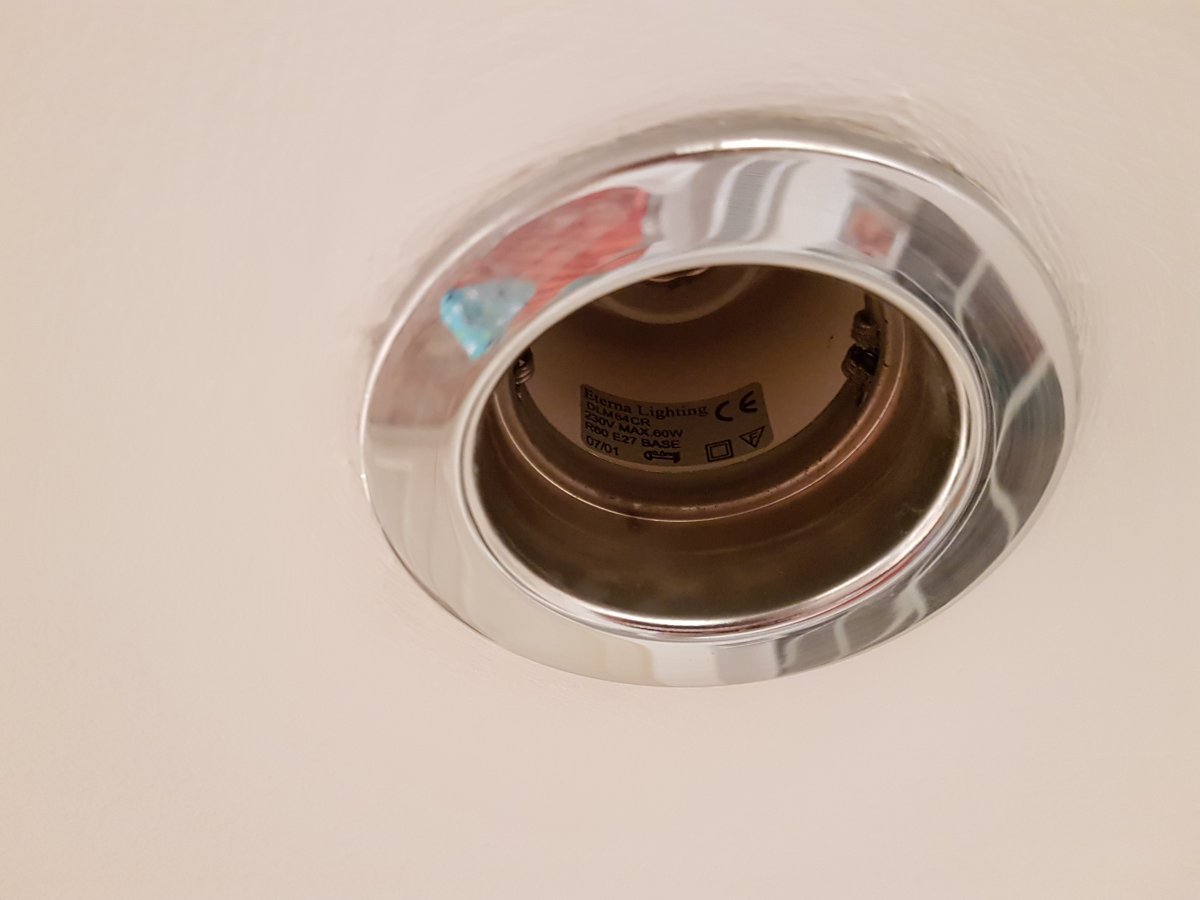

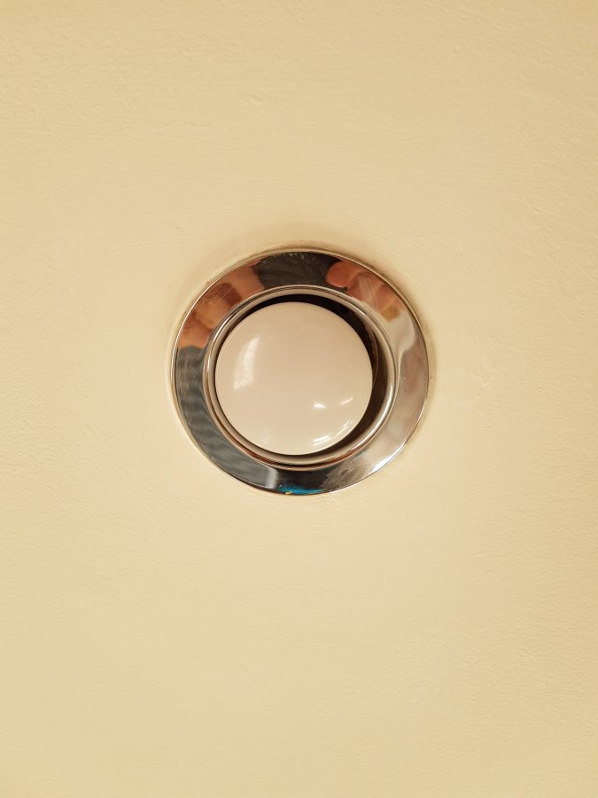

Finally got round to buying some of the hue bulbs to try out (e27 ambience bulbs).
I'm hoping it should be ok with fitting these bulbs in the fittings shown in the attached photos? The bulbs will still have a few mm gap to allow heat to escape and they are not completely enclosed.
Other photo from my previous post...
