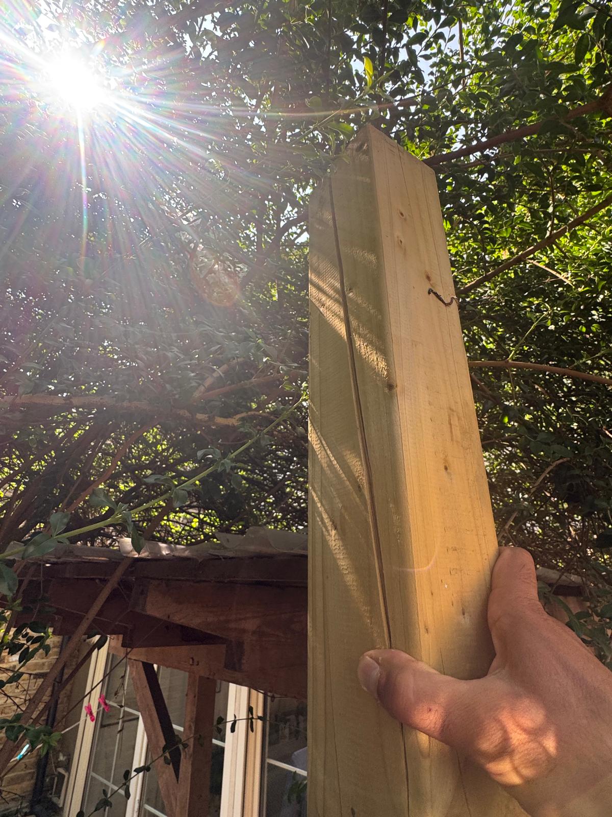

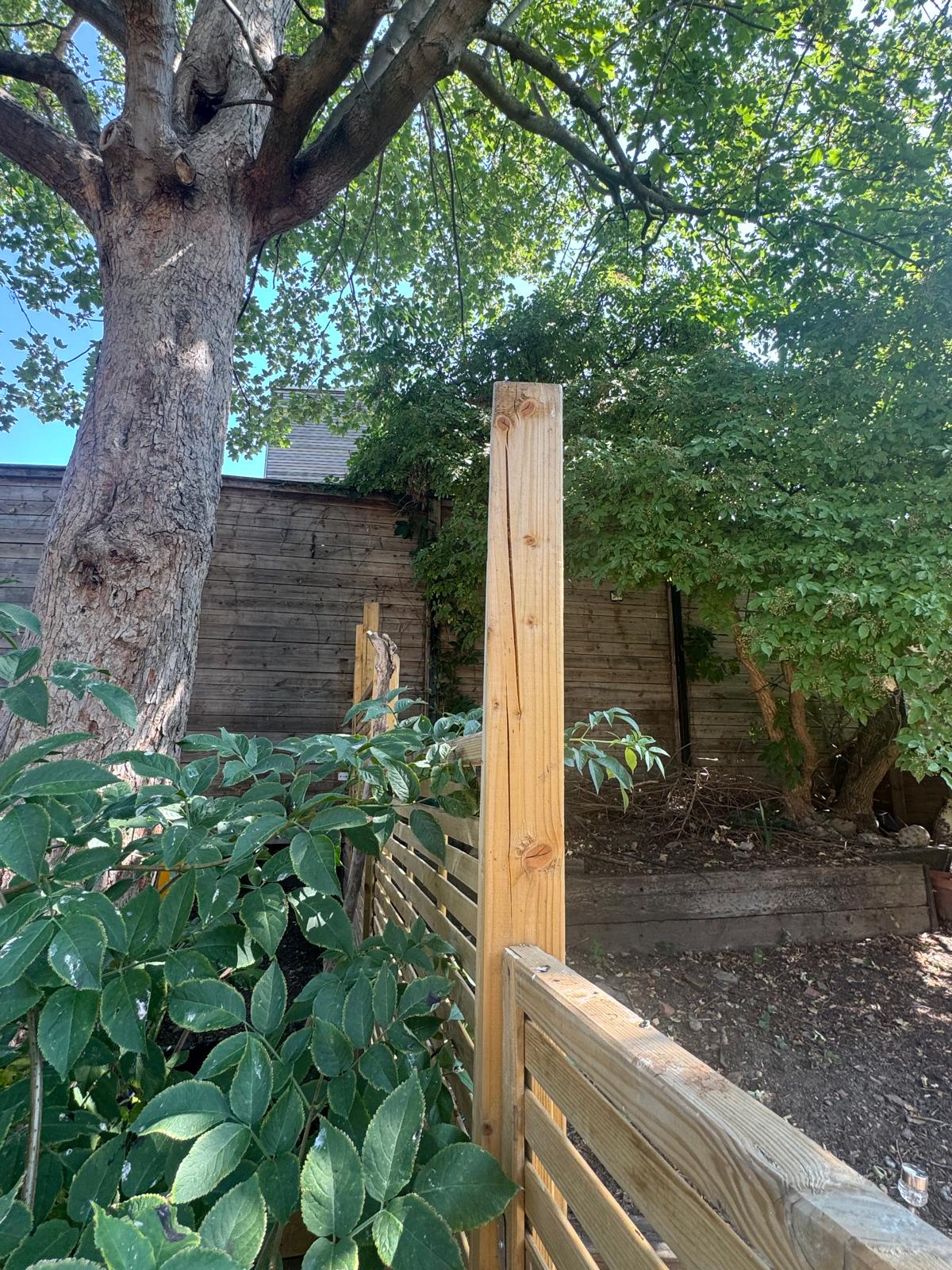

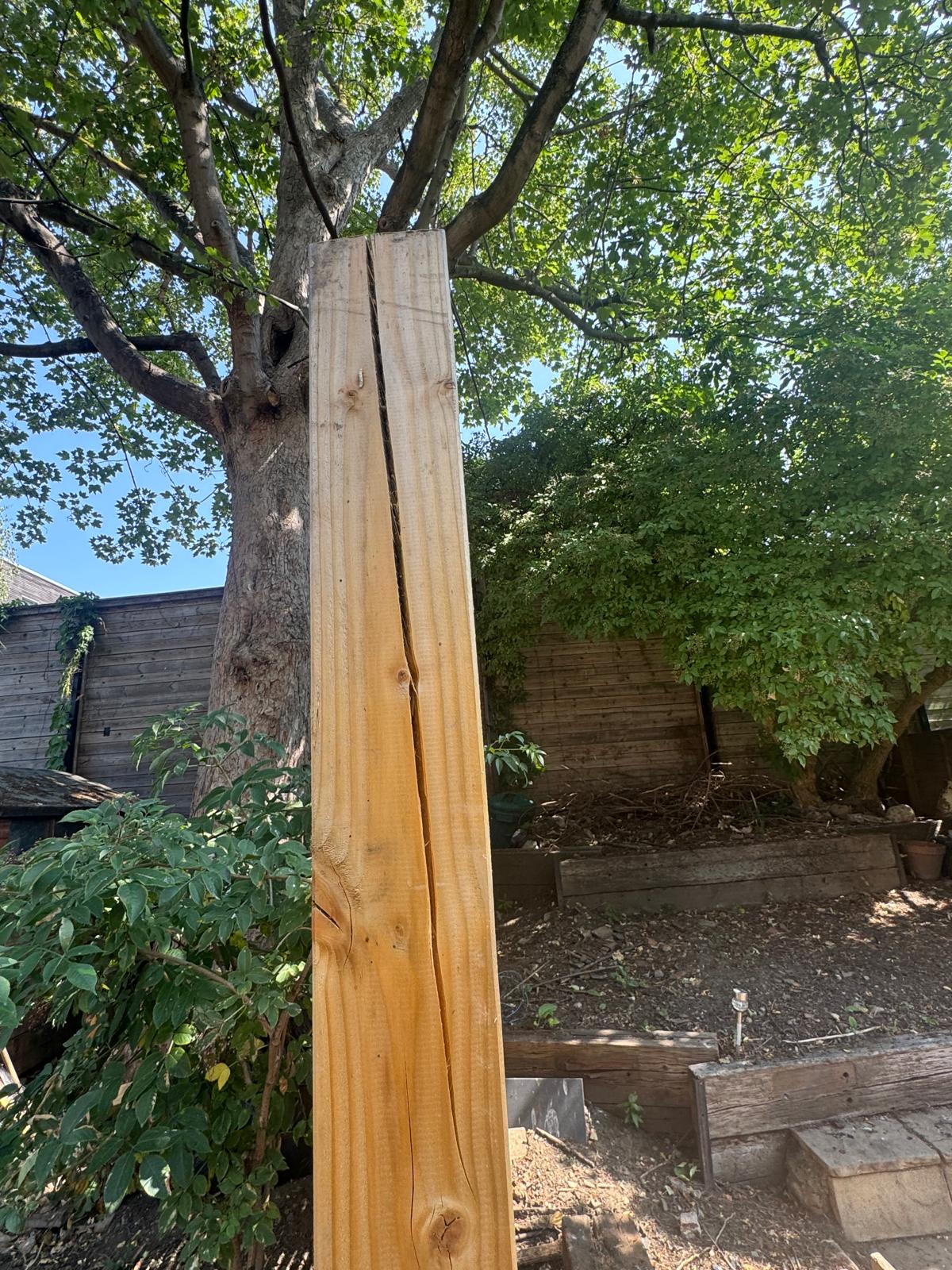

I'm in need of desperate help. To enhance the look of my garden I opted in for 4x4 Planed & Rounded Timber Tanalised Fence Posts from Monkroyds instead of common sawn timber posts
I purchased them in November and installed them a week after.

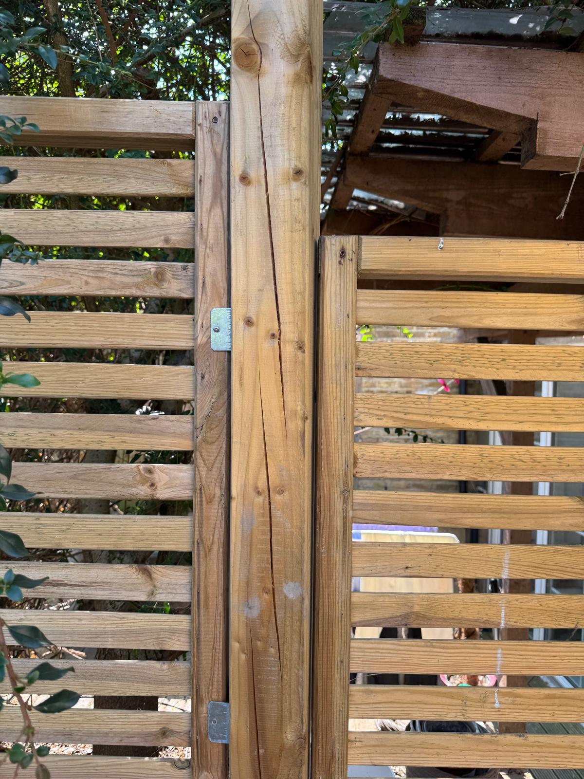

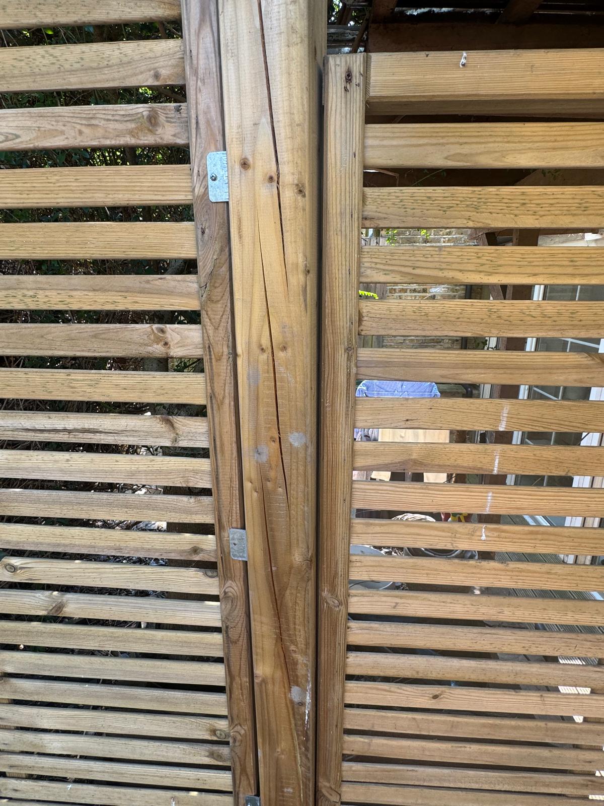

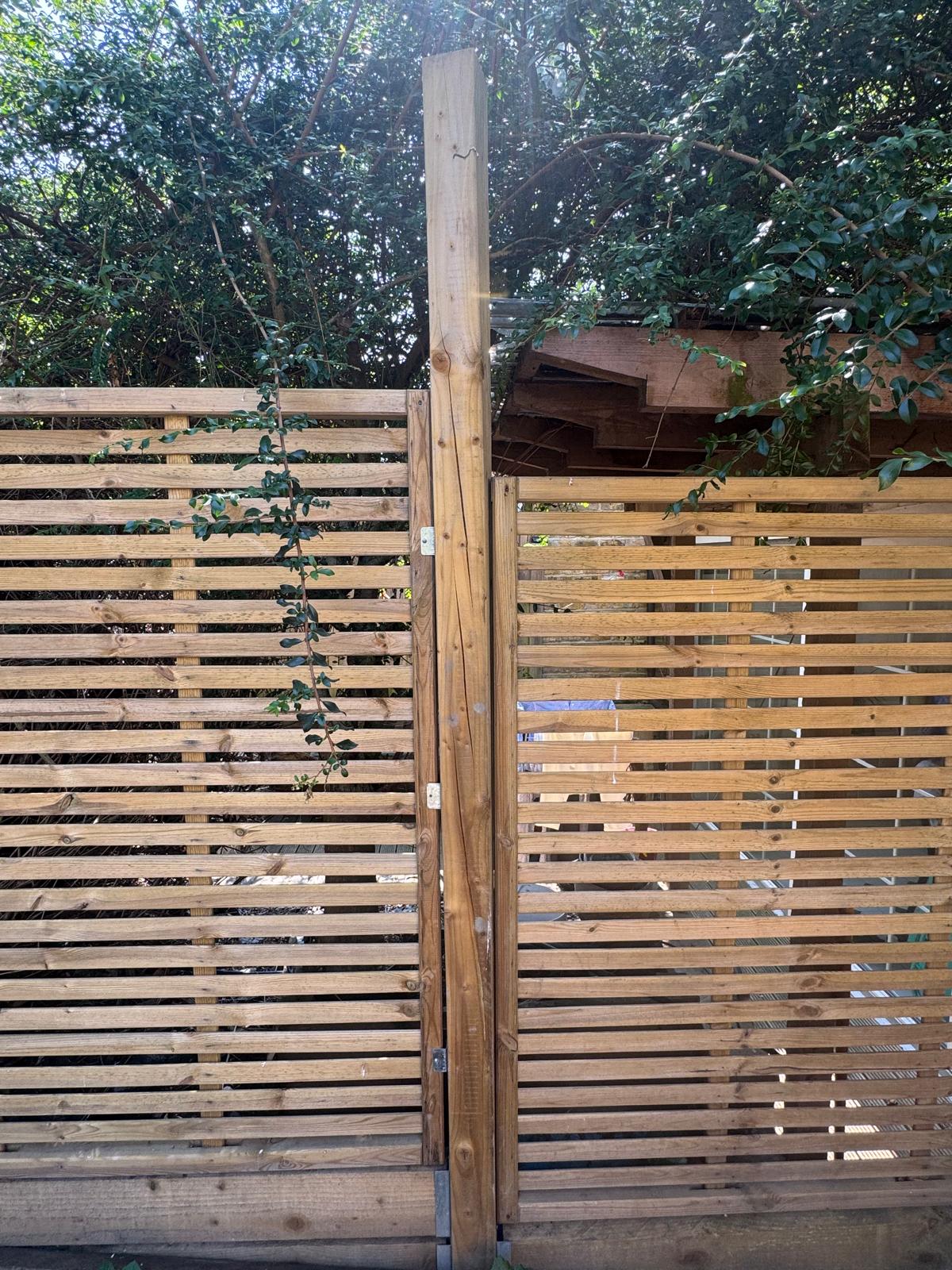

Now I'm in big trouble, every single post have major vertical cracks on them. Long and deep and most of them have bowed significantly.
I haven't contacted them yet and I thought I'd get advise from pros on this forum first.
I appreciate that timber is a natural product and that minor surface checking can occur as it dries. However, this goes well beyond what I would reasonably expect from a structural fence post. The amount of movement and distortion has left me concerned that the timber supplied was either excessively wet or otherwise unsuitable for its intended purpose. Also the actual timber I received looked significantly different to what is shown on the website. it doesn't look like they've been properly tantalised.
My question is what are my rights? I don't want just refund from them. to change them it's going to be a major mission as they are in concrete.
Thank you

As they've been installed since November, you're outside both the 30-day short-term right to reject and the first six months where a fault is presumed to have been present at delivery. That doesn't mean you have no rights, but the burden is now on you to show the posts were inherently defective when supplied.
If every post has developed severe splits and bowing, it may be worth asking the retailer to inspect them, but don't assume they'll automatically be liable for the cost of replacing the fence. They may argue that checking and movement are natural characteristics of treated timber, so you may need independent evidence if they dispute your claim.
Timber does move with the seasons, so some of the checking may close up a little in autumn and winter as the moisture content increases. However, significant bowing and deep splits are unlikely to reverse, so I wouldn't rely on the weather fixing the problem.
May be a case for cutting your losses and replacing with concrete posts, or Durapost, to avoid issues with timber.
If the first pic., the screenshot from their website that you mention shows the that they are or were already bowing then. But personally as yorksbuilder says,concrete slotted posts would have been better and the warping and splitting is common with timber posts and panels.
No reason why you shouldn't complain even if you only get a partial refund but I doubt they will replace and refit without proof of not being fit for purpose.
Agreed, you might get some kid of refund but on a hiding top nothing to think you'll get anything else. See how it fares and if you can't live with it cut your losses and re-do it.

based on your experiences, have you seen this much bending and cracking ? it's literally on every single post. What type of wood is it? I'm going to fight for 'not fit for purpose case'. I unerstand wood split ,crack bow but to this extend only after 6 months?
In case, I'm not successful with the claim, what would you suggest to prolonge the life of these poor posts? support them with another post? I can't do any more digging. Epoxy to fill the cracks to avoid further water damage, capping them?
It doesn't look great, but is it actually sound enough, i.e., not falling down? Timber warranties generally cover rot, but explicitly exclude things like splitting, twisting, warping, shrinking and swelling, The unusually hot weather will also have an impact.
You might argue that it is excessive, but if they refuse then you'd need a court to decide that. As others have said you might get a "goodwill gesture" but only you can decide if it is worth going further.
It's not funny everyone cracking jokes at the posters expense.
A small side point I'd make, as an amateur, is that having vertical end grain exposed will shorten the lives of the posts - I'd want some kind of cap on those...

They should give you a partial refund unless they are a shoddy business.
It may be worth quoting BS 1722 - it requires that the completed fence is fit for purpose and structurally sound.
Unfortunately, they are reasonably cheap products, it is a case of buy cheap and buy twice.
